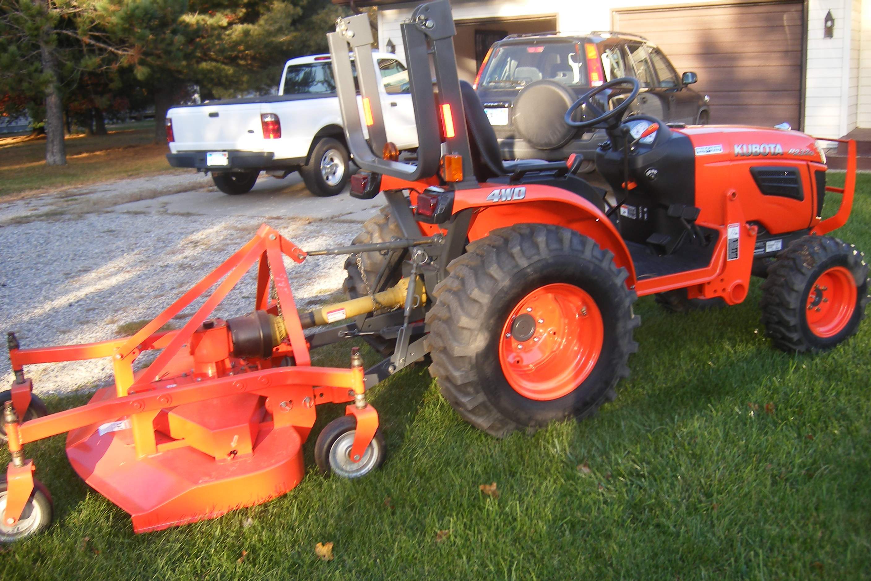

Well, ladies and gentlemen, this about concludes my first week's review of the B2320 in light my experience doing similar tasks with my recently parted BX1860. I've tried to review the "seat of the pants" subjective/objective differences.
I've run the middle buster and the FEL. Mowed the grass with RFM and used the field cultivator. Of course, I also done a handful of utilitarian things such as move some sand and tow the trailer around.
Until the snow flies, I'll put this review on hold, basically, for awhile. After I get a chance to plow some serious snow, perhaps I'll resurrect this thread and add that comparison. Thanks to all and I hope some of the information was helpful to anyone who wants to compare a Bxx20 to a BX Kubota. Best regards,

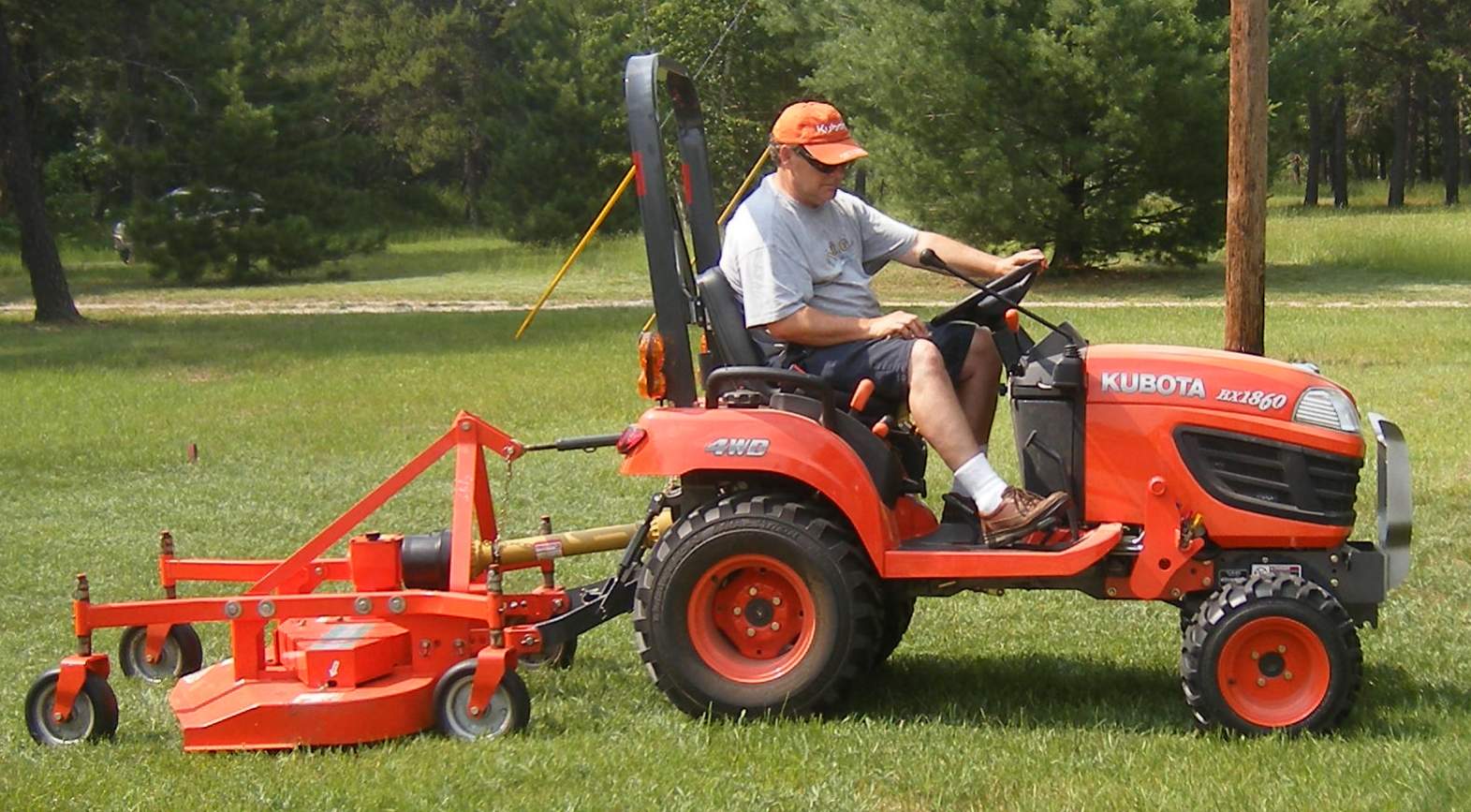

I will add my comments about marking the lawn with the tractor. I started with a B7800 with RFM with loaded turfs moved up to a L3940 with loaded R4 and a 7 foot RFM and now have a BX1860. I didn't have any problems with marking of the lawn except when I put ag tires on the B7800. I have lots of hills and with the exception of making turns to fast going downhill/uphill or being in 4WD I didn't have any problems with marking. I always mowed with the 3940 with the loader installed. I'm still undecided on the best choice RFM Vs MMM. I definitely miss the 7 foot cutting width and being able to back under obstacles. I had a pretty wide open place to cut with the 3940. I really thought I was going to hate the BX and the MMM but I actually like it more than I thought. I like having a standard steering wheel instead of the zero turn controls. Unfortunately we downsized our property so the wife could go back to school. So I will learn to love my BX. The 3 point on the BX leaves alot to be desired but so far that's my only complaint.
