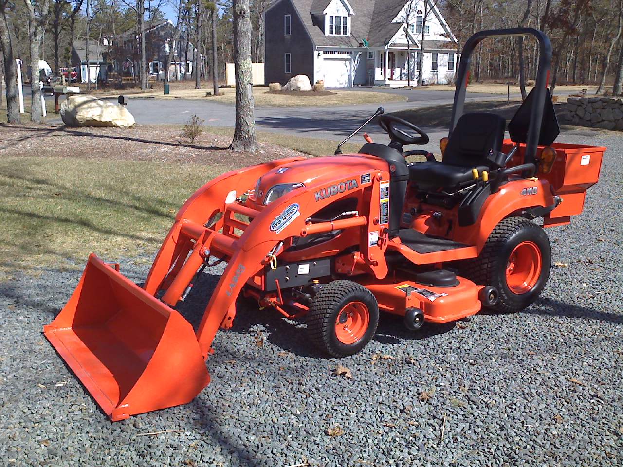

Got my BX1860 today! Spreading mulch this weekend! Bill :D

Very nice machine. I am sure you will enjoy it for hours . I see you got the ballast box. what do you plan on putting in it ? IF it not too much to ask, I'd like more pictures of it discoonected and inside.;)
