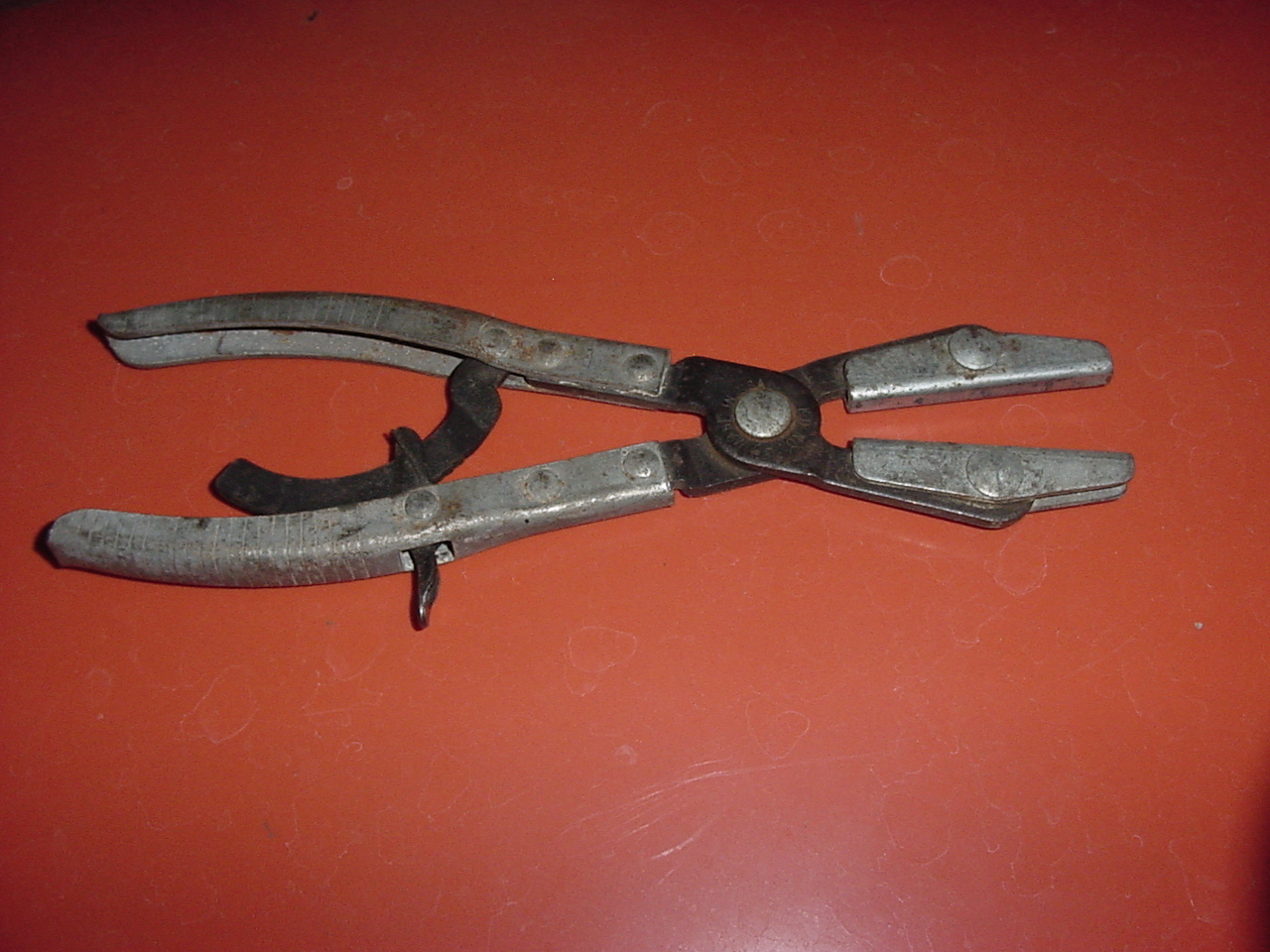

Vise grips will work, but be careful, the rough edges can cut the rubber hose. I purchased radiator hose clamp pliers (see picture) for all jobs like this. They are made for use on rubber hoses...therefore, no cutting.
Deano
Deano
That's a great idea along with long red ribbon like planes have on pitot tubes so I remember to remove it.
tom

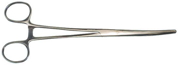

I have a curved pair and a straight pair that works for me, and they're shiny.:D Of course I have on my HF Nitrile gloves and an assistant to hand me the filter.:)
