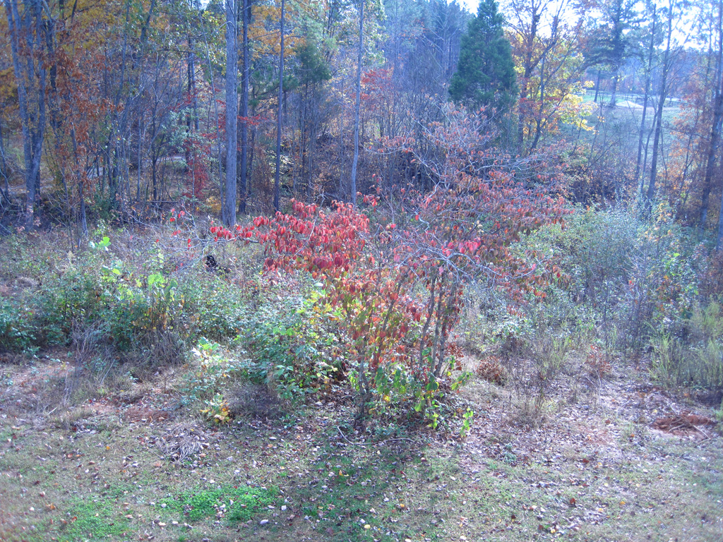

Here is a picture of the heaviest area (behind the small tree in the forefront). This part I may have to do by hand with a brushcutter/weed wacker attachment. All the other areas are mainly just those tall brier weeds, but no where near as dense as this picture. In the other areas you can almost walk around them if you are careful.
I see the bush hog for the heavy stuff, and the flail for a more groomed / refined area. My father has a really big yard, and it sounds like the flail would be nice there. I think what I have in the beginning may be too rough for the flail, but I DO LIKE the flail (I have a four year old and the areas are close to the house). So I will send the family into town when I try to bush hog.
I can see me getting the LandPride 48 rotary now, and then in the spring getting the flail that is at agri-supply. I don't mind buying both, because it seems like the bush hog has one purpose (rough, not refined, but gets the big stuff out of the way, just go slow), and the flail is for more refined areas.
Either route I go, I will post some pics.
Thanks everyone.
Sounds like a good plan to me for your uses.
It is really hard to generalize about all types of cutters. We use to use a combination of rotary cutters and seven foot finish mowers for the larger areas. We now use a 10'6" Woods DS1260 rotary cutter and the cut is so good, our finish mower hasn't come out of the shed this week. Some flail mowers will also do a pretty good job on fairly rough stuff as well as finish mowing.

I have used a Bush Hog Squealer 48" rotary cutter on a Kubota B2400 HSD for 10 years to cut brush significantly heavier than your picture and never found it underpowered. Sure, if I let the bottomland go a year without cutting and have brush over 6' high in thick Johson Grass I have to slow down on the first cut, but I would have to slow down almost as much with a 42". I think the B2400 has 18 PTO HP. I don't hesitate to recommend the 48" over a 42".

I have gone through far worse than what you have in this picture with the rotary cutter. If this is the worst spot, and you plan on getting a flail anyway...
<shrug> I would be tempted to say just buy the flail and forget about the rotary cutter. No personal experience with flails, but from what I gather from others, I'd wager it won't have much trouble with your requirements.
