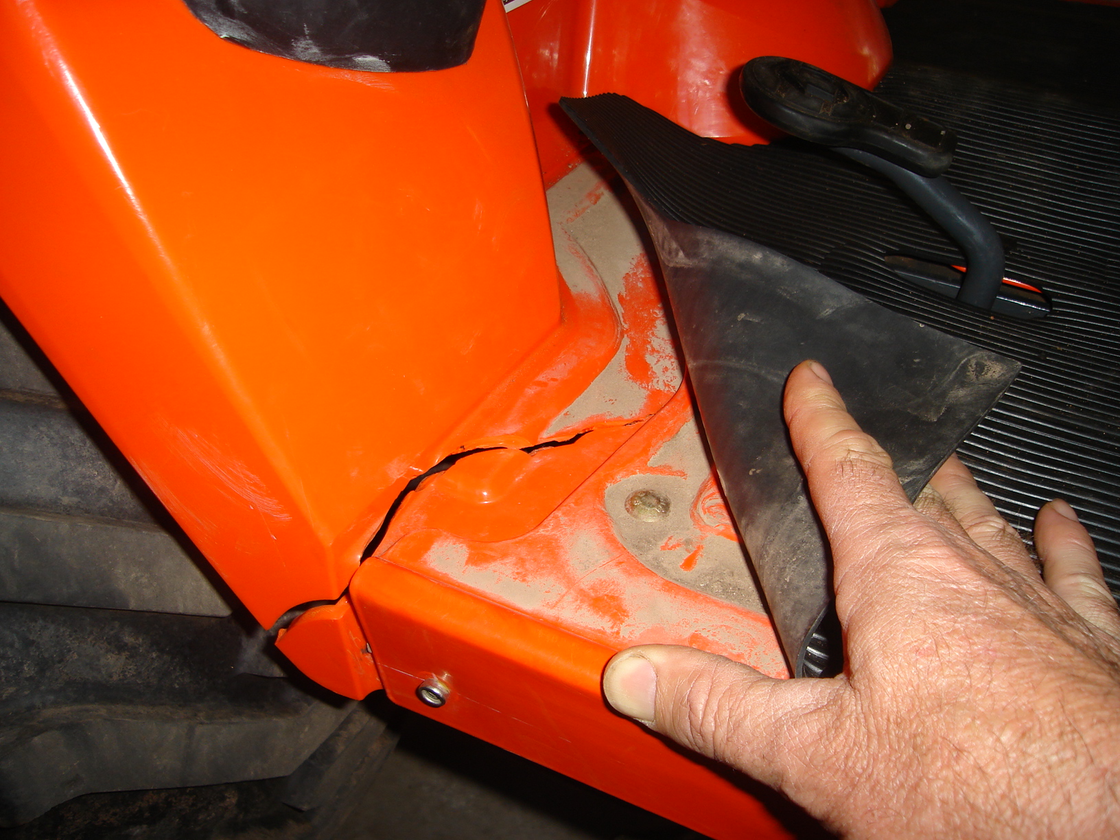

/ BX-24 and Kubota #7
I also have a 2006 bx 24. My floor and fender cracked. I took it to the dealer and they replaced the entire fender including the floor. While it was there they also replaced the hour/rpm meter and all the handles on the controls. I believe these were a defect and recalled. Putting to much weight on the outside of the flooring while getting on or off the tractor was a weak point causing it to break. The new one is all reinforced. Another problem I had with a bx2200 was front axle seals leaking. The problem in my opinion is when you pull off the fluid check plug there would be a good amount of pressure in the axle. There is no need for that to be pressurized that it should be vented to relieve the pressure on the seals. What I understood from my dealer.. that Kubota has a vented check plug for this...I have not seen it yet.

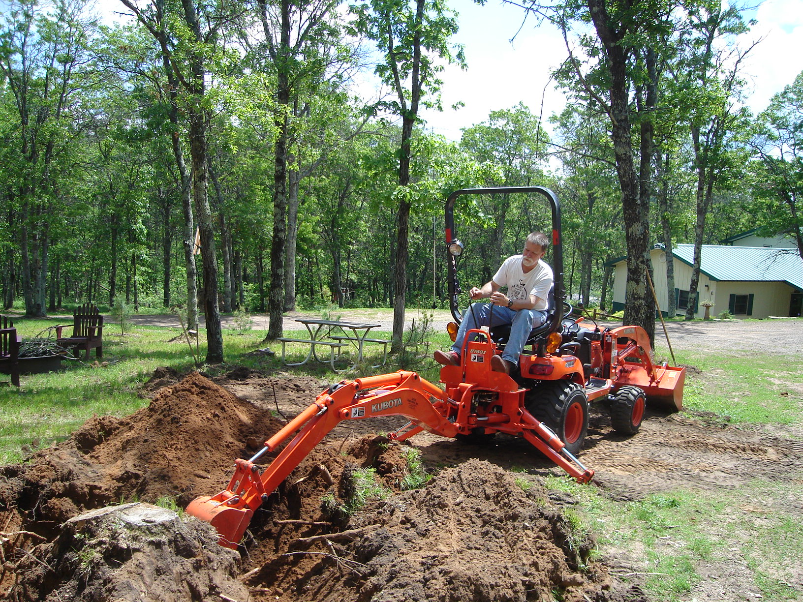

/ BX-24 and Kubota #9
I'm not real familiar with the 25. But look underneth. My new floor has medal framing to reinforce it. I'm pretty happy with the repair of my tractor.

/ BX-24 and Kubota #11
I am assuming the camera person and your BH is on a slight incline .... otherwise the house in the background is sinking into the earth!

/ BX-24 and Kubota #14
Here's a picture of the break in my bx24
