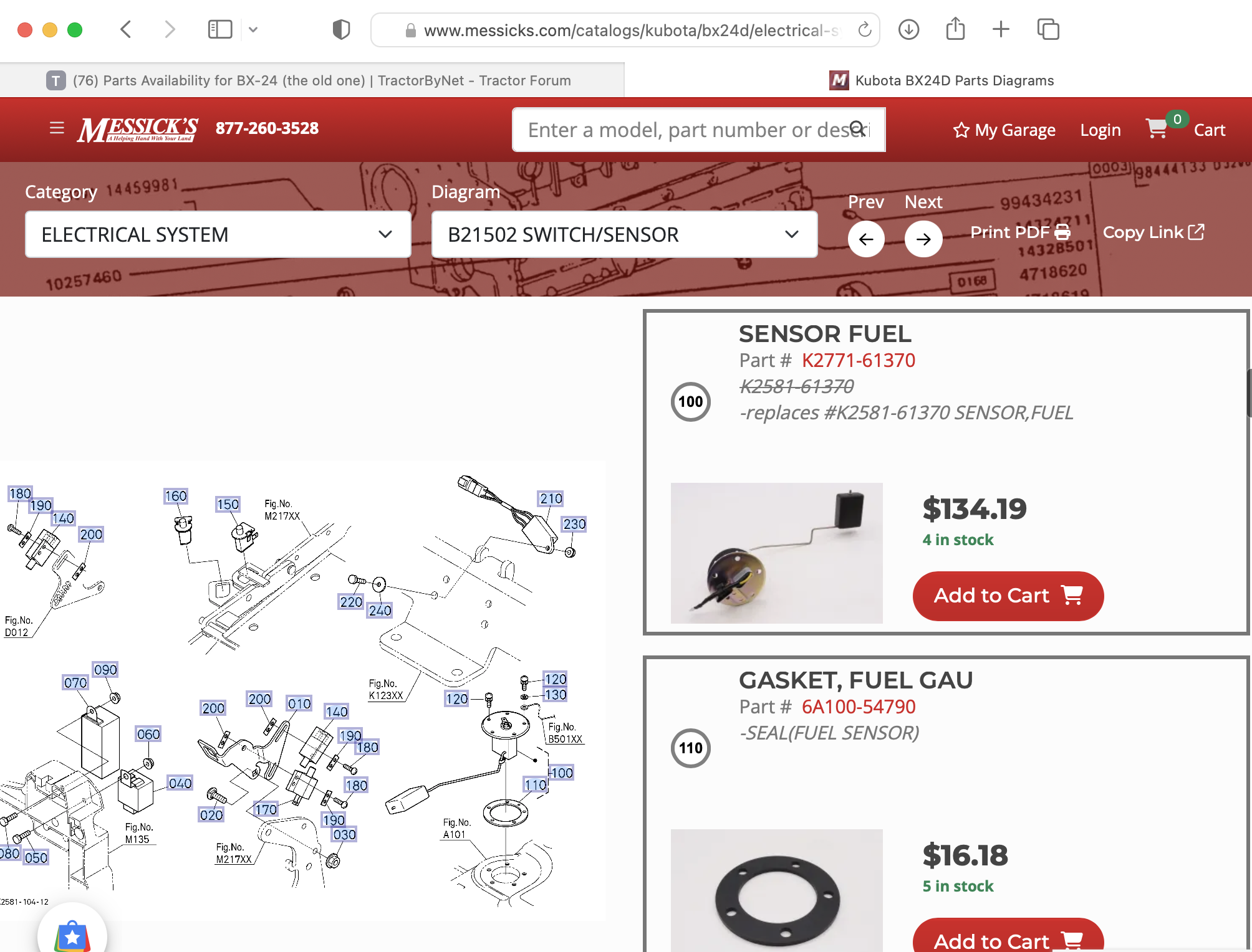

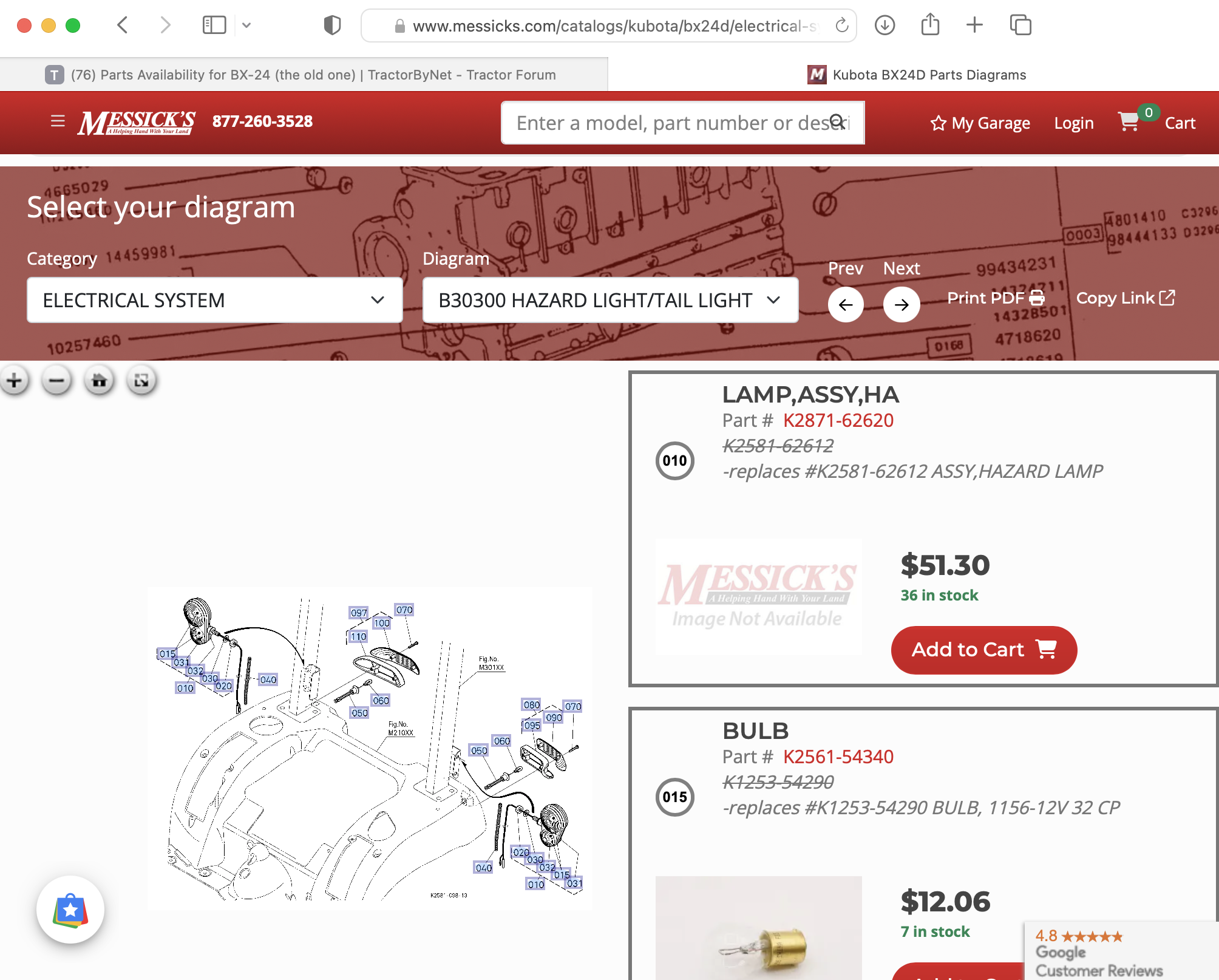

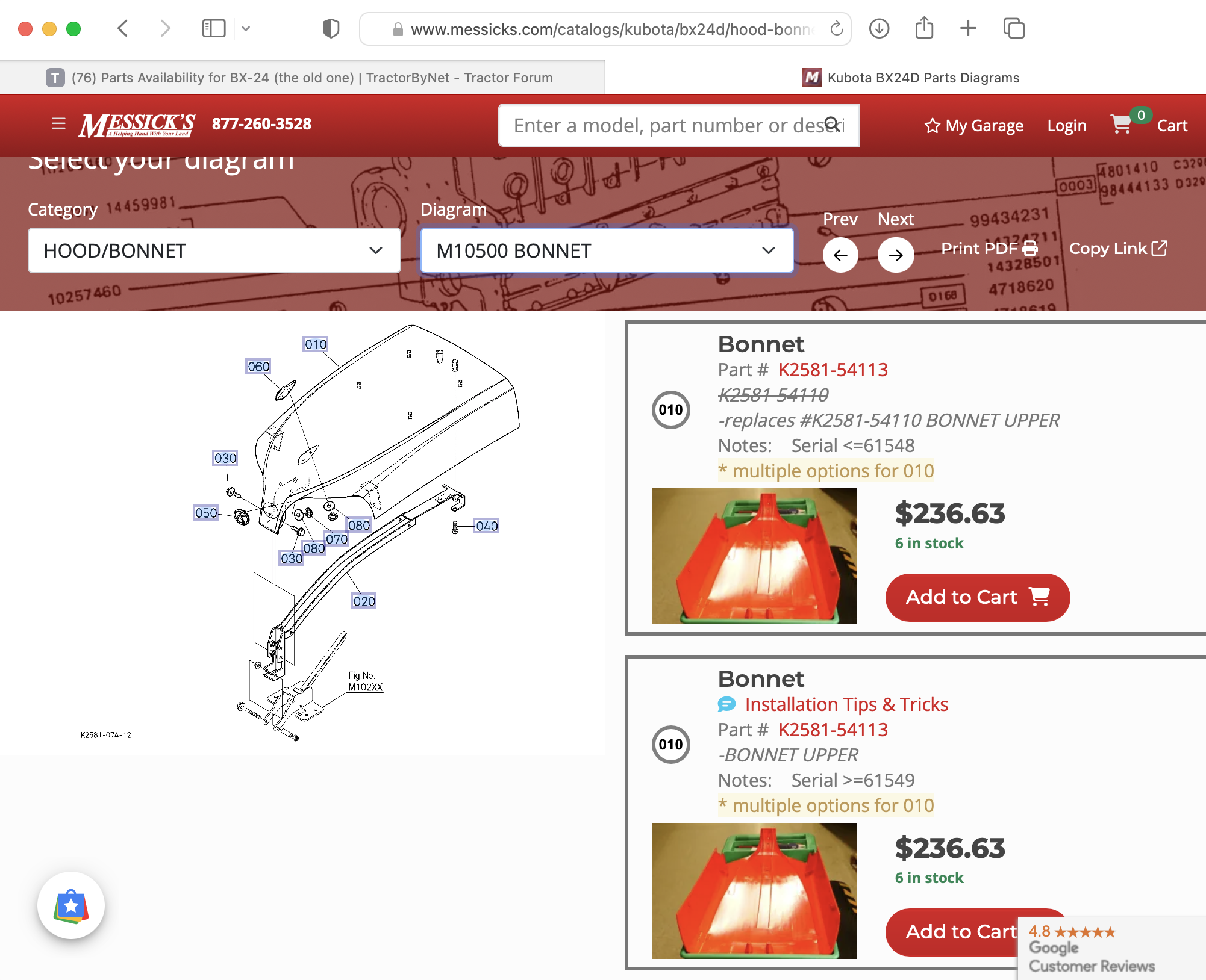

/ Parts Availability for BX-24 (the old one) #4
A quick trip to Messicks online parts site shows how many are available and for how much. I was surprised to see they stock six (6) hoods !
Sounds like basic weekend maintenance. You can add up the parts in an hour online. After that it is just your time vs theirs. Looks to me like 4 to 8 hrs work -but probably spread over several weeks as parts arrive.
BTW, their search prog. wants the model as BX-24D, a hood is a bonnet, and several models use the same taillights.

Since your contemplating you can use a hood from any bx 60 or 70 series and they are metal instead of plastic. But you will need the hood side of the hinge from 60 or 70 series. The rear fender you can use bx2360 bx2660 bx2370 or bx2670 and again will be metal instead of plastic. The floorpan from bx2360 or bx2660 will also work and is metal. Unfortunately there was never a metal versio of the side bonnet that goes around the engine but they are available new and not real expensive. I have several bx tractors in my salvage yard if you need anything
