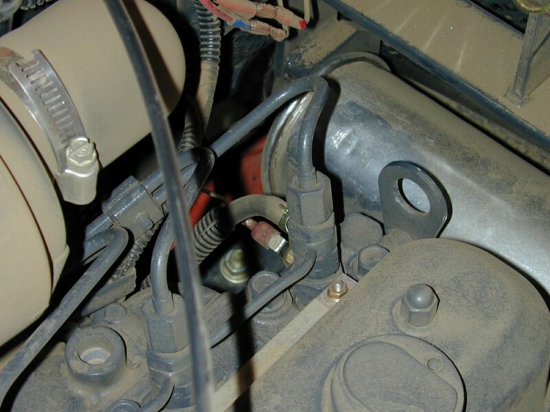

The temp gage on my BX23 does not seem to register anything, zero, nilch.
I mowed yesterday with a 60"MMM for about 2.5 hours, 85 degrees and when I was putting it away I noticed that it appeared to be bottomed on the cold end.
Any ideas? Anyone else have this issue. I did not check the wires underneath, but did notice the back lighting on the gages funtioned.

Not sure, but seems like the first time or two I changed the oil or "fixed" the air filter bracket I knocked the sending unit wire off. Seems like it's the wire sticking up out of the top of the head (?) I can check tonight if you don't get a resolution.
/ BX 23 Temp Gage < cold
Both of which I have done, I recently performed the bracket ritual. So its a good chance its at the sending unit? I will look it over tonight. It definitely appears to be no signal as its reading less than cold. Thank you.

I think I found the sending unit on the right side above the oil filter, one blue lead. It appears to be connected, I pulled it off and re-installed it, and verified connections under the dash. As for the 85 degrees, I failed to mention it is still december here. We jus had all that flooding that was on the news. We lost 2 covered bridges, one of which was one of the only 2 twin covered bridges in the US. The roads are still closed in many areas. I am head to a National tractor Pull tonight to whatch the big boys. But anyway,I do believe that July heat is headed this way starting saturday. Anything over 90 and my bodily funtions start to shut down, even if its breezy.
I think that is the oil sender. I belive the temp sender is in the top of the head.

AH, I blieve you are correct, I will look abit more, I could not find it and tried to chase any wires coming from the main harness. I will do a better visual around the head tonight. I just could not find anything. I did switch out the air filter bracket and thought I may have interfered with it then. But I still have not found it. That was the oil sender, as it resembles the one on the jeep. Thank you!

I have had the bx1500 & bx 1850, not your model but the sender was on top in the left front corner of the head or in front of the air cleaner.
Good luck and I agree that the wire is disconnected as I had the same problem.

Here you go man. Pic taken from the right side at about the dash looking forward, the wire is close to the center of the pic, just to the left of the bottom of the #1 injector, it has an insulated terminal that is light red.

Thanks for the shot brew, I looked at it this weekend and thought that must have been it. Its fully seated, I did everything just short of putting dielectric grease on it and re-seating. I am gonna run it again this week and see if its working. We got the heat on so I am expecting it to run > cold this time around.
