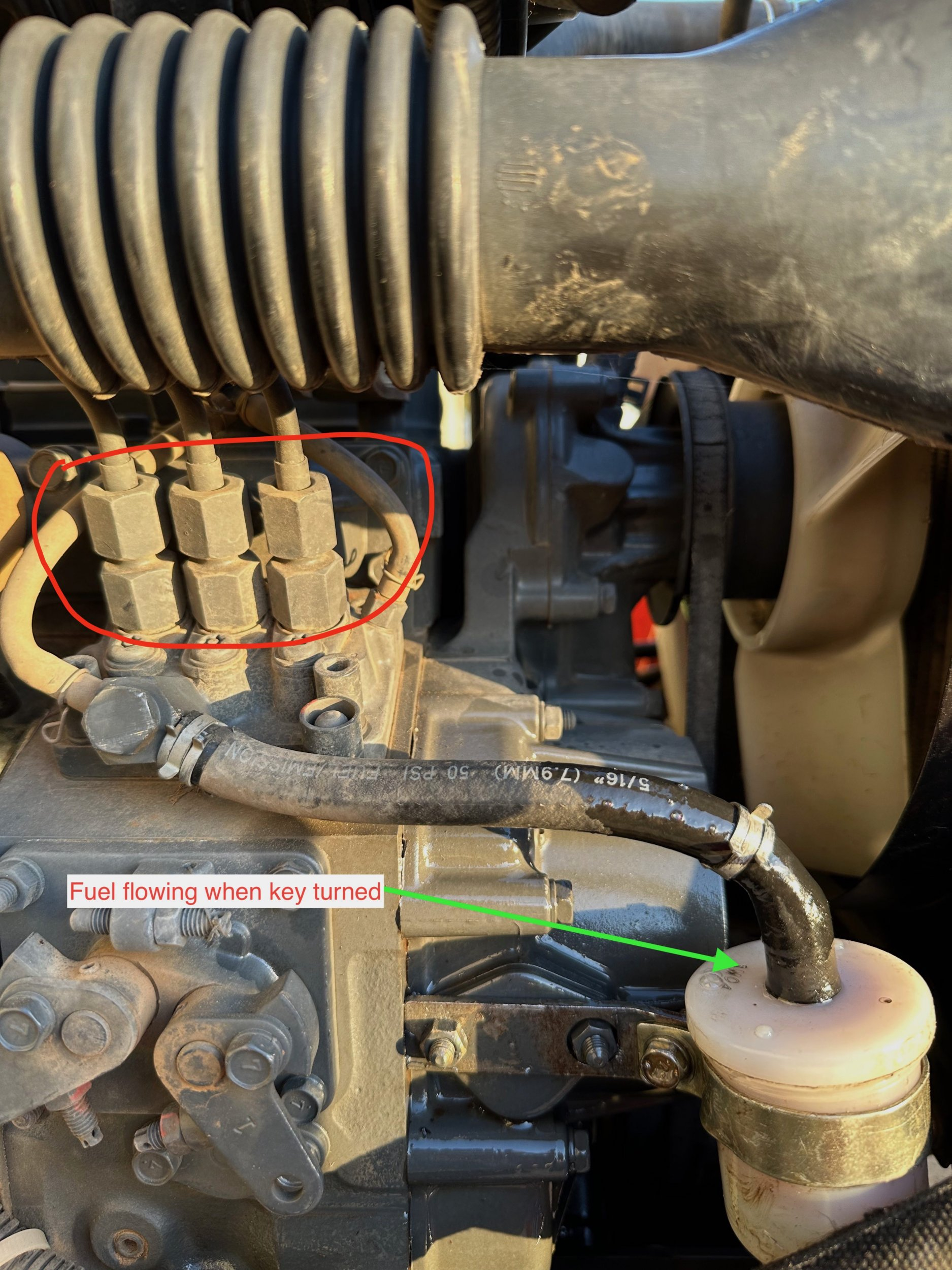

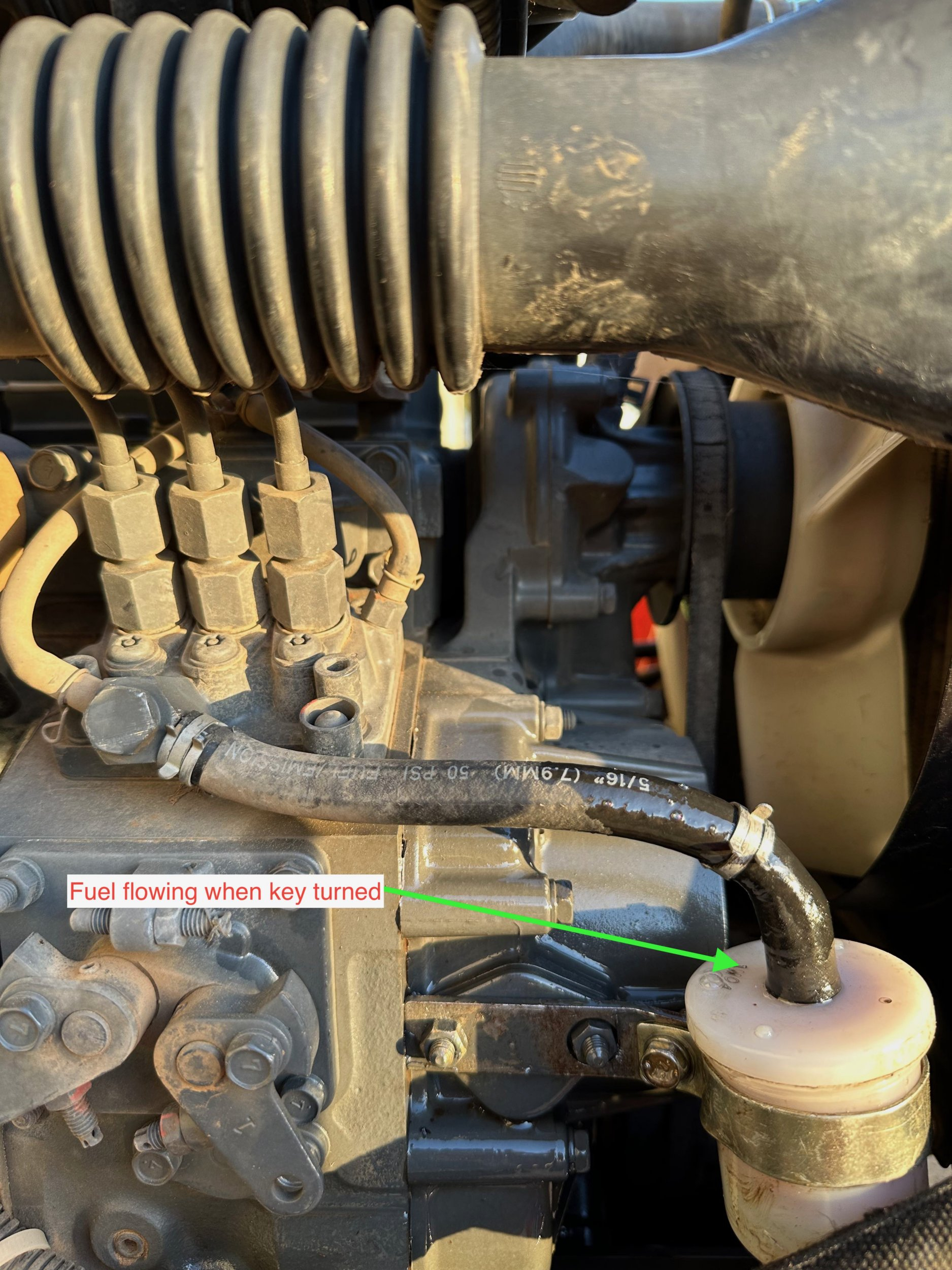

Having a real issue getting my BX 23 to start.
I crank it to the point the battery feels like it would die. Sometimes it starts and immediately shuts down, other times it starts perhaps sputters for a few minutes and then shuts down.
I thought it's probably a fuel issue as it's been sitting for a while. Drained the tank, put fresh fuel, changed the filters but no luck.
I disconnected the filter line after the second filter (next to the engine), turn the key one step and get fuel flowing out, so I know I have fuel working up to that point. (pic attached of where I disconnected)
Would really appreciate any thoughts - I seem to feel it's a fuel issue, but don't know what else to try.

1300 hrs is not high enough hours to expect serious injection pump issues or compression, etc. The high pressure lines are very small plumbing (look like 1/4" outside diameter) going out from the injection pump and each has a fitting that should loosen with a very small open end wrench right at the injector. They make 'tubing wrenches' that are like box ends with a small opening so you can use them on tubing without it being loose. They are better for not slipping but also probably not worth buying a set. Most likely those injector line fittings use metric sizes. They will be tight but should not be too hard to loosen. Make sure you have a good tight fit and don't round off the edges of the fittings. Just do one at a time and retighten each one before you loosen the next. It will not take more than a couple or 3 seconds of cranking to see the squirt going on BUT if it is foamy or hissing let it crank longer until that quits.
/ BX 23, sputtering and hard/won't start
#9
Thank you so much - I've been watching a few videos and reading other posts, but your instructions make great sense.
I should be able to go try this in a few hours and report back.

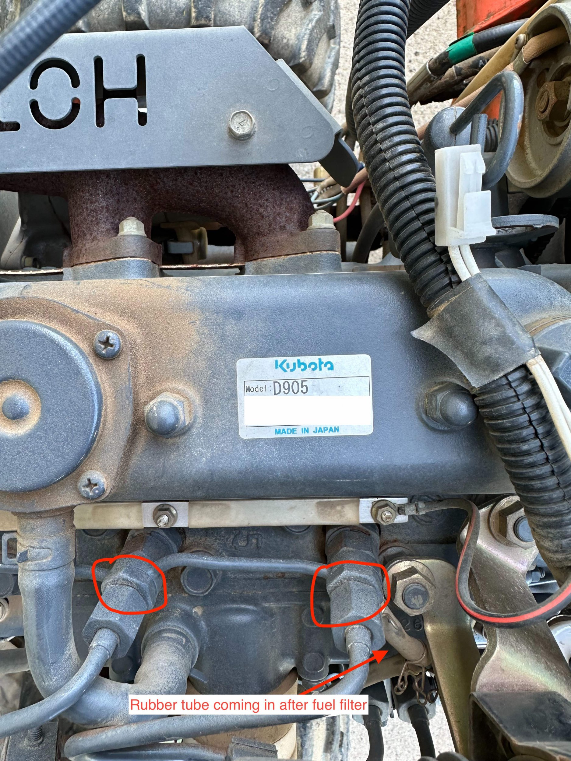

I had taken a photo last night and think I understand.
There the rubber tube on the right side, which if I understand correctly is the fuel line coming in and the injection pump is each of the ones i've marked in red.
Really appreciate it - I know it all sounds easy, but I was hesitant to mess anything up before being sure I understood.

BX tractors are self bleeding. Two things to check. They have a small lift pump, it almost looks like a fuel filter but it’s metal. Make sure it’s clicking when you turn the key on but don’t start. I’d also change both filters even though you said you had flow. They are very small and plug easily and they are also cheap. They also had a problem with the sending unit rusting and plugging things up.
/ BX 23, sputtering and hard/won't start #11
sorry if you already know this...
Diesel injector pumps pump more fuel than the injectors inject...excess fuel is returned to the fuel system...that is what is visible in the second pic...it is low pressure thus the spring clamp...

Thank you everyone for your replies; Still haven't gotten it resolved but based on all your suggestions here's what I did;
I opened the return fuel line as /pine suggested (And I didn't know about that, so thanks)
When turning the key, I did get fuel squirt through that rubber line - I didn't think there was water, but can't be sure, but atleast I know the fuel is running all the way through.
I then opened the connections at the injectors.
The 1st, had some diesel squirt out - no foaming or bubbling, so tightened that back.
The 2nd, had some foaming, so I continued to crank for about 10 seconds and the engine started up. It still looked like it was foaming slightly, so I let it run for a minute and then when I went to turn the key off the engine wouldn't shut down and had to turn the lever next to the engine.
*is the engine supposed to be able to start with that disconnected?
I tried the 3rd injector and that just looked like a bit of diesel squirting - no foaming, so tightened that down.
