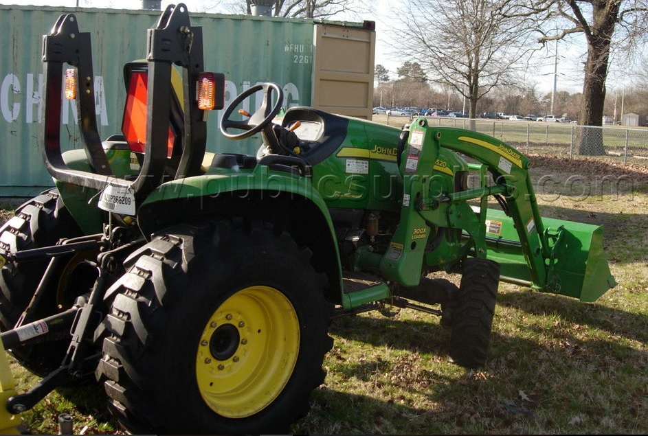

How about something like this for $12,000?
attachment.php
Bought at Public Surplus Auction, 50 HP M4700 w/ dual rear remotes, loaded tires.
Or this
link to auction
a 3520 John Deere Tractor with 60 hours that went for $13.5K last May.
They are out there, you just have to look and jump on them.
