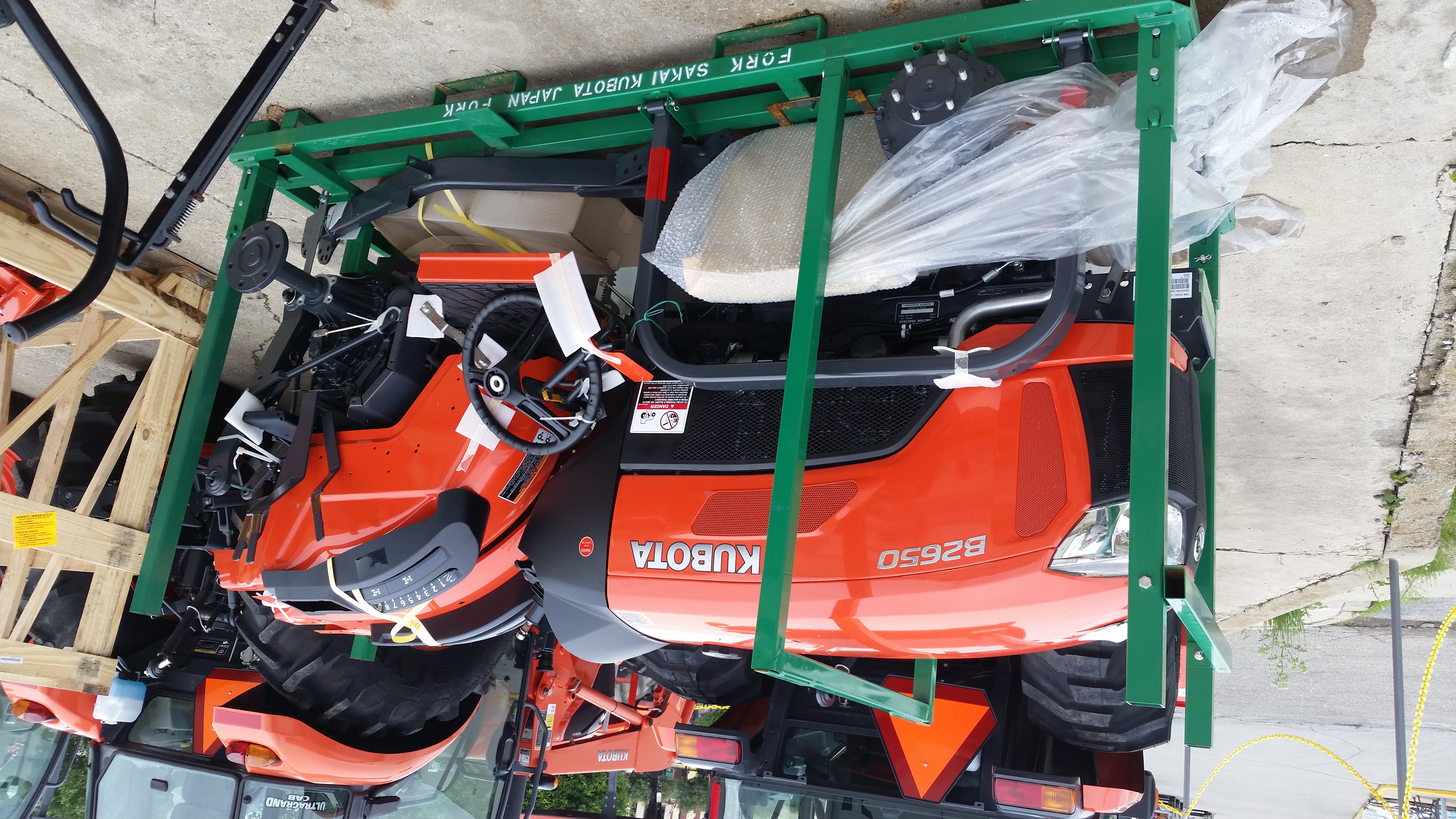

When dealer gets these smaller tractors, it's some assembly required.
