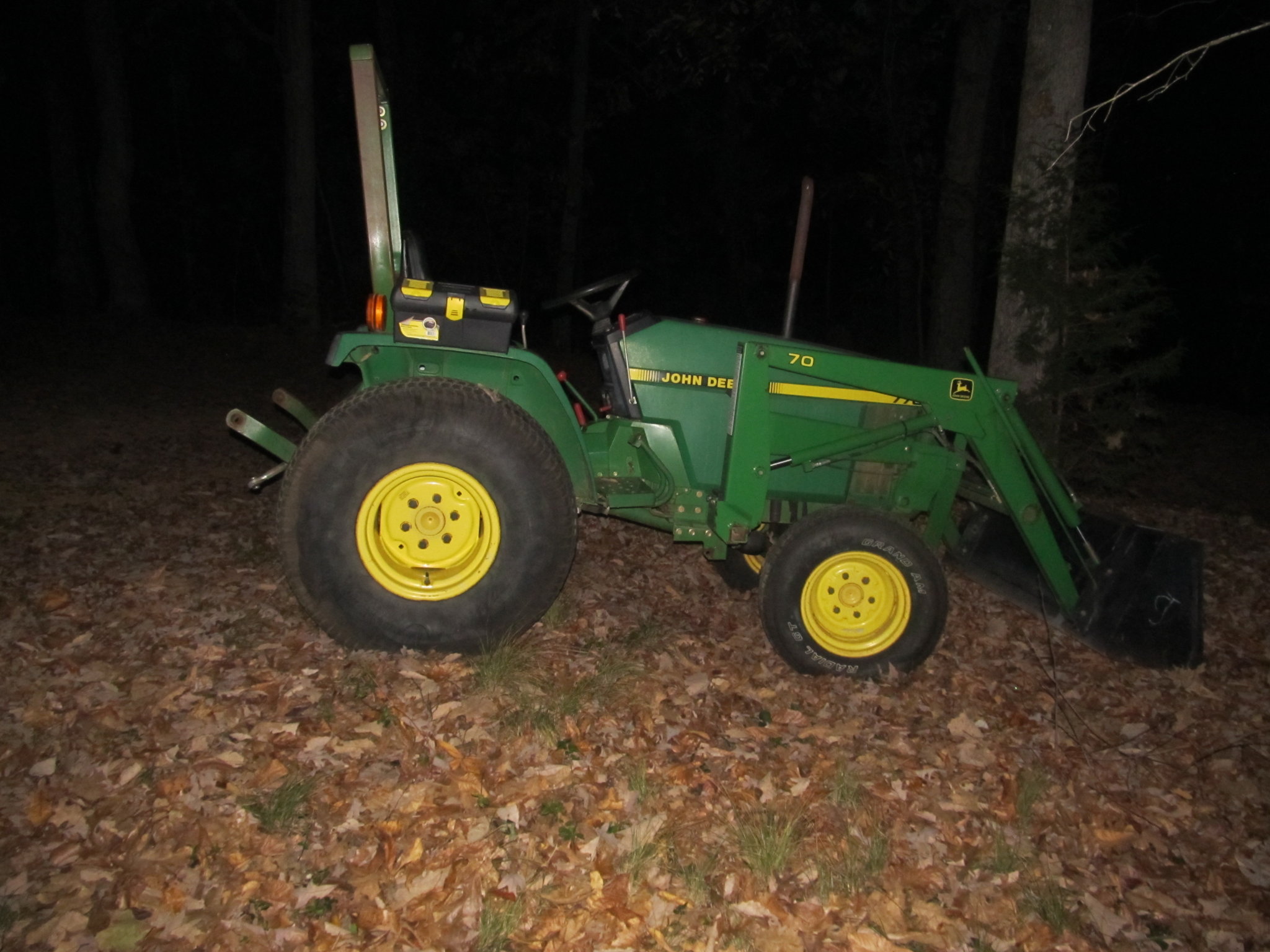

Well I pulled the trigger on the 770. I am comfortable on the machine and confident in it's condition. I think the tractor will do what I need it to, albeit a bit slower than if I found a larger compact. IIn our particular neck of the woods with tight trails, close trees, no flat spaces... I think this is going to work. Worst case scenario, it doesn't and I believe with the price I paid and the condition of the tractor, I could recoup my money quickly. Here it is:
John Deere 770, 70 FEL, 4wd, straight gear.

Nice! Those Yanmar built Deere's are some of the best...

Thank you. I had ot out the other evening and worked on some of our water abatement bars and run off areas. So glad to have gone in this direction. This is going to allow me to take care of my own property for years.
