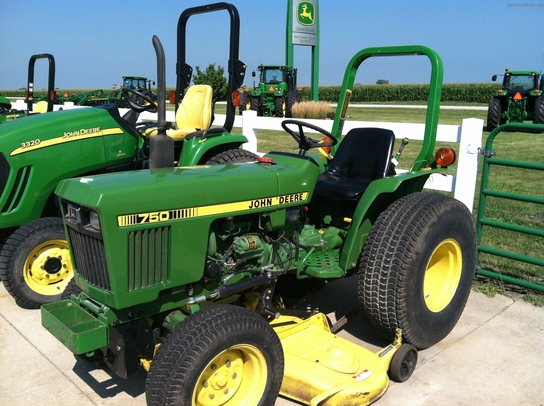

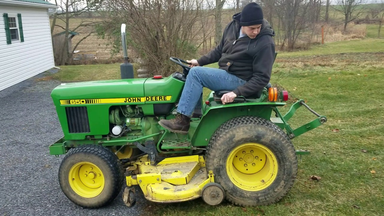

My co-worker grabbed a YM1720. Has good power, 3-cly, factory power steering and is a really nice SCUT. Not so tiny like a YM1300/YM135 or YM1500/YM155. It would be more on par with the YM186/YM187. A YM1610 is very apt with a belly mower too. So don't rule it out either.
These are off the manual covers. And yes, the belly mowers are fully defined in the parts manuals too.

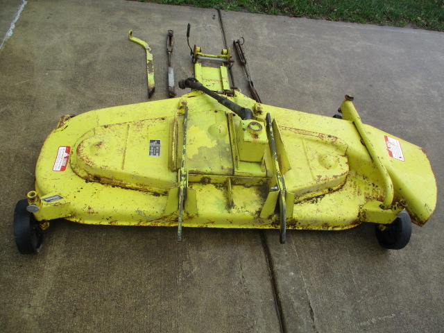

Where would you find a DGR mower for these two machines you might ask? I see one right here - - -
JD650 ~ YM1610
JD750 ~ YM1720

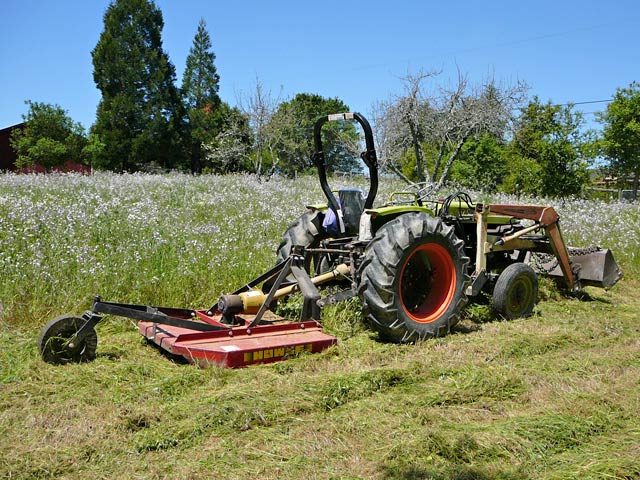

City folks vs country folks:
New neighbors. They clearly moved to the country so they wouldn't have to talk to anyone. I had mowed the back of their parcel for the previous owner once, on my 30 year old Yanmar (photo) but when these folks needed it but rudely ignored us, I didn't offer to mow it again.
Then I saw the neighbor mowing there for the first time on his brand new John Deere lawn tractor. He made it about 20 minutes. Stalled a few times. Then BLAM!!!! Silence. The tractor sat there for a couple of days. Haven't seen it since.
His 20 minutes mowing must have been real expensive. o_O
