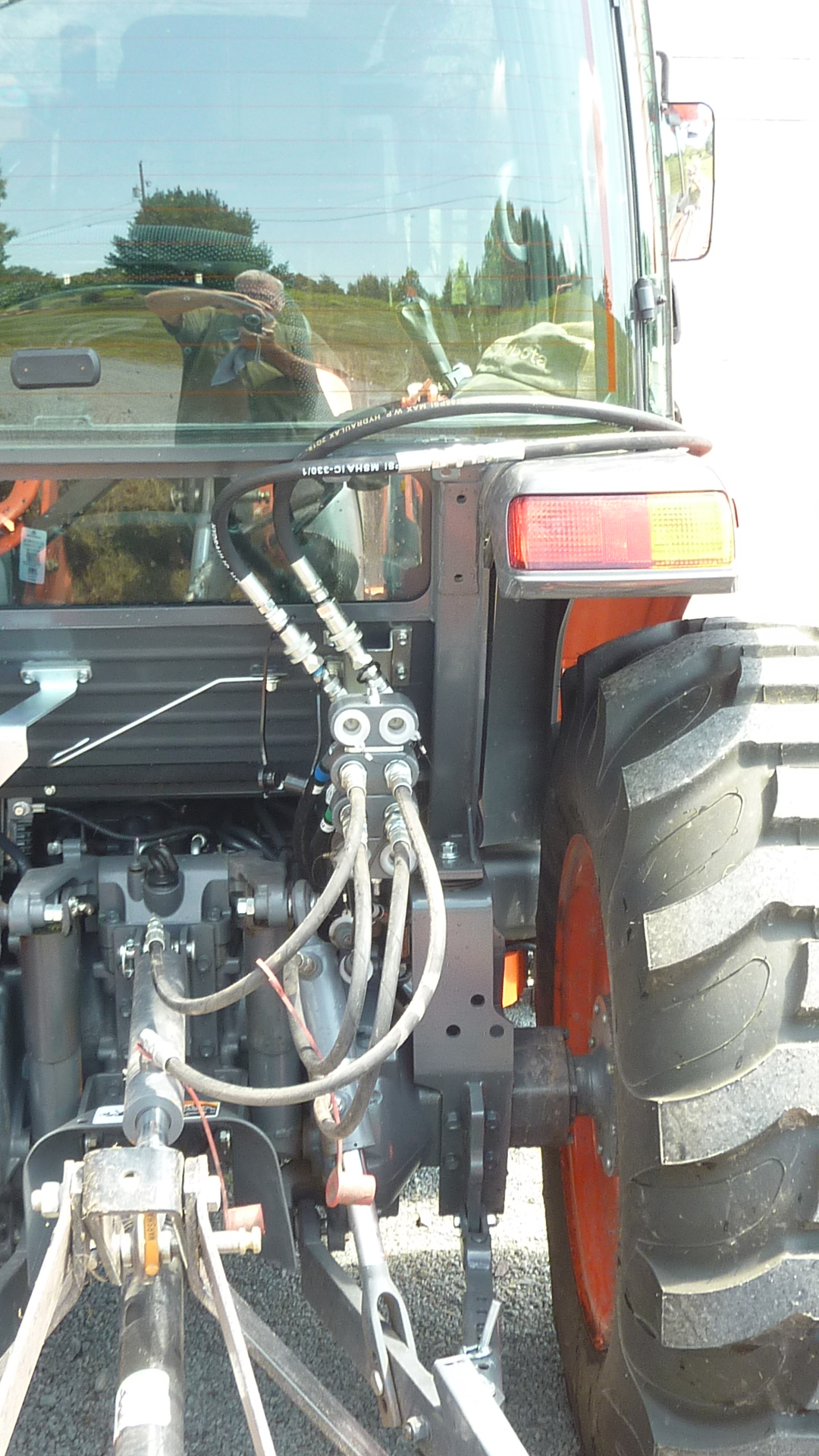

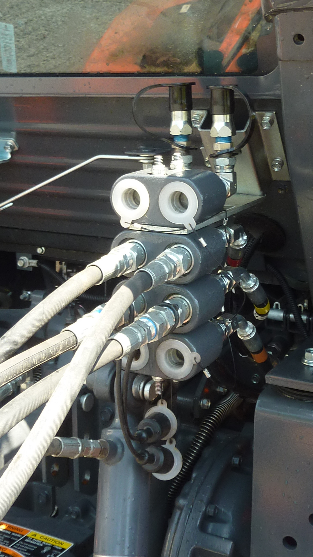

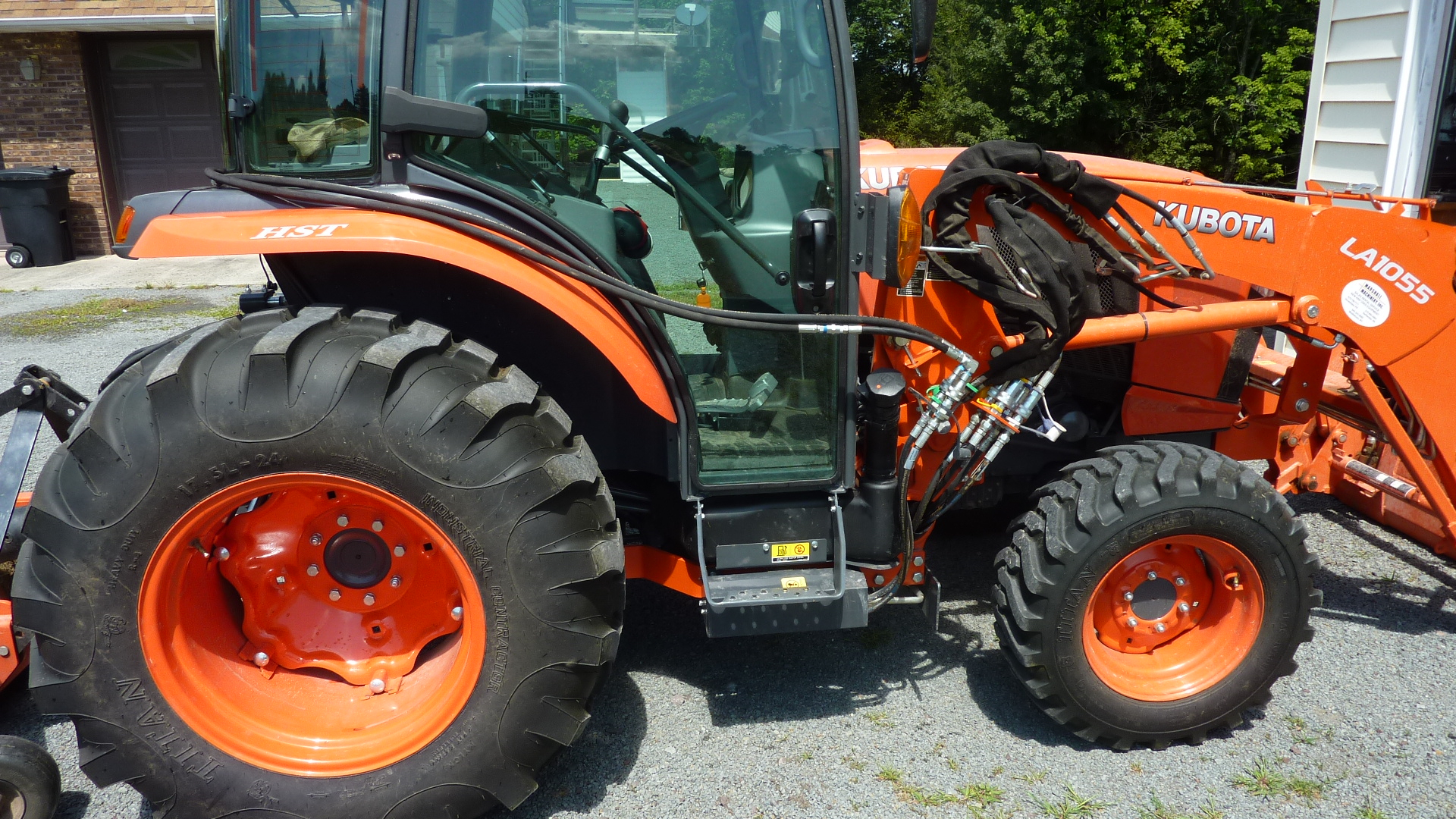

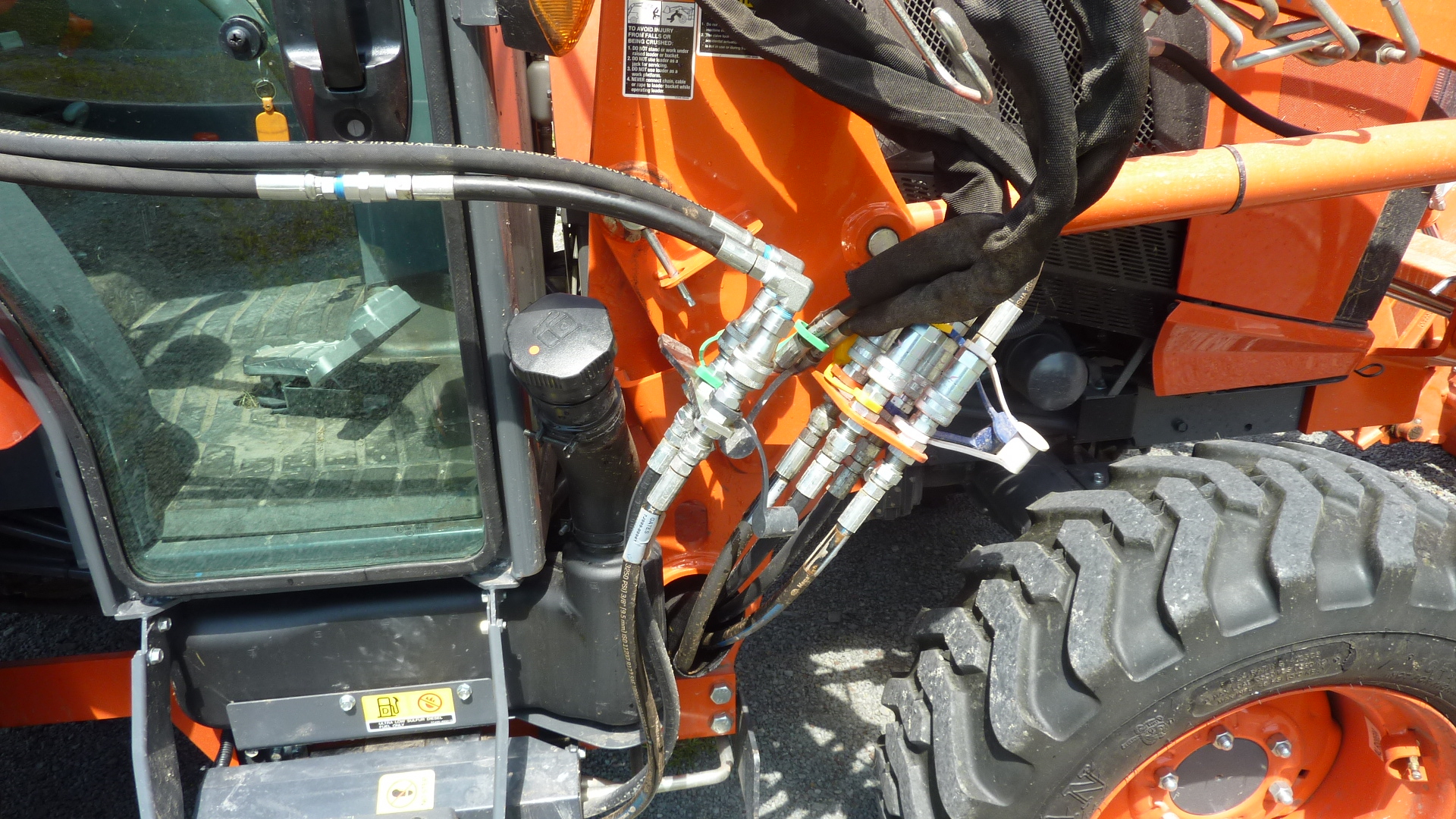

Whenever I need a 4th rear remote, I use this rig to tap the 3rd function valve:
I added a 4th break away coupler housing to the stack and ran temporary hoses forward to the 3rd function valve couplers. Yeah, it's a jury rig but I don't need it that often.
I had most of the parts laying around and the ones I bought were much cheaper than trying to use an electric diverter valve.

That's some good creative out-side the box thinking! You're right, often the need for 4 remotes is seldom so what you came up with fits the plan just fine! Thanks for sharing.
