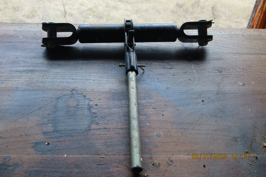

I’ve been looking at a crank version for one side of my height adjustment. Much cheaper and I don’t need to do it often, just often enough that a turnbuckle is a pita
   / Buying Advice on Hydraulic links #16
Beenvenue - a shame we are so far apart. I was given a hand crank unit. Never used it. I would give it to you. I think this may be what you are looking for.
