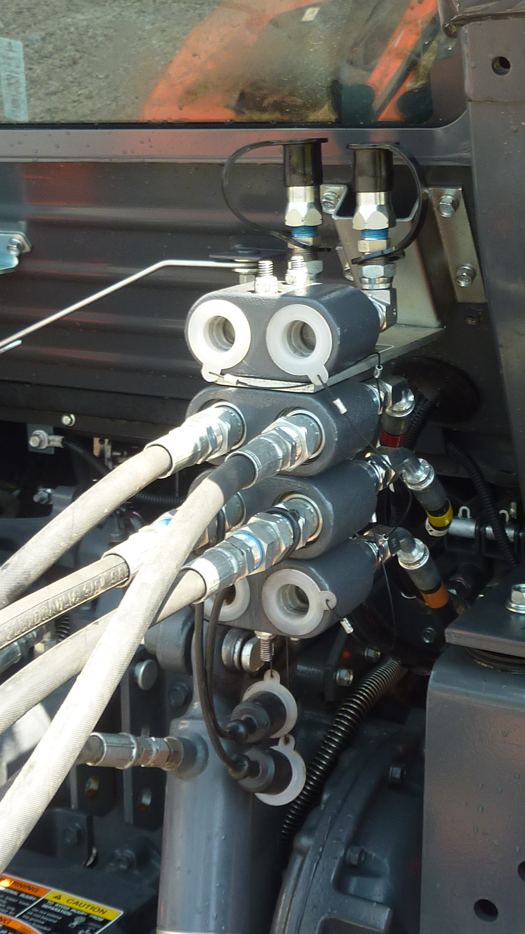

A hydraulic remote multiplier looks to be a handy way to add remotes beyond factory options. It's basically an electric diverter valve.
   / Buying Advice on Hydraulic links #35
I use a diverter on my LP rear blade. Very cheap multiplier.

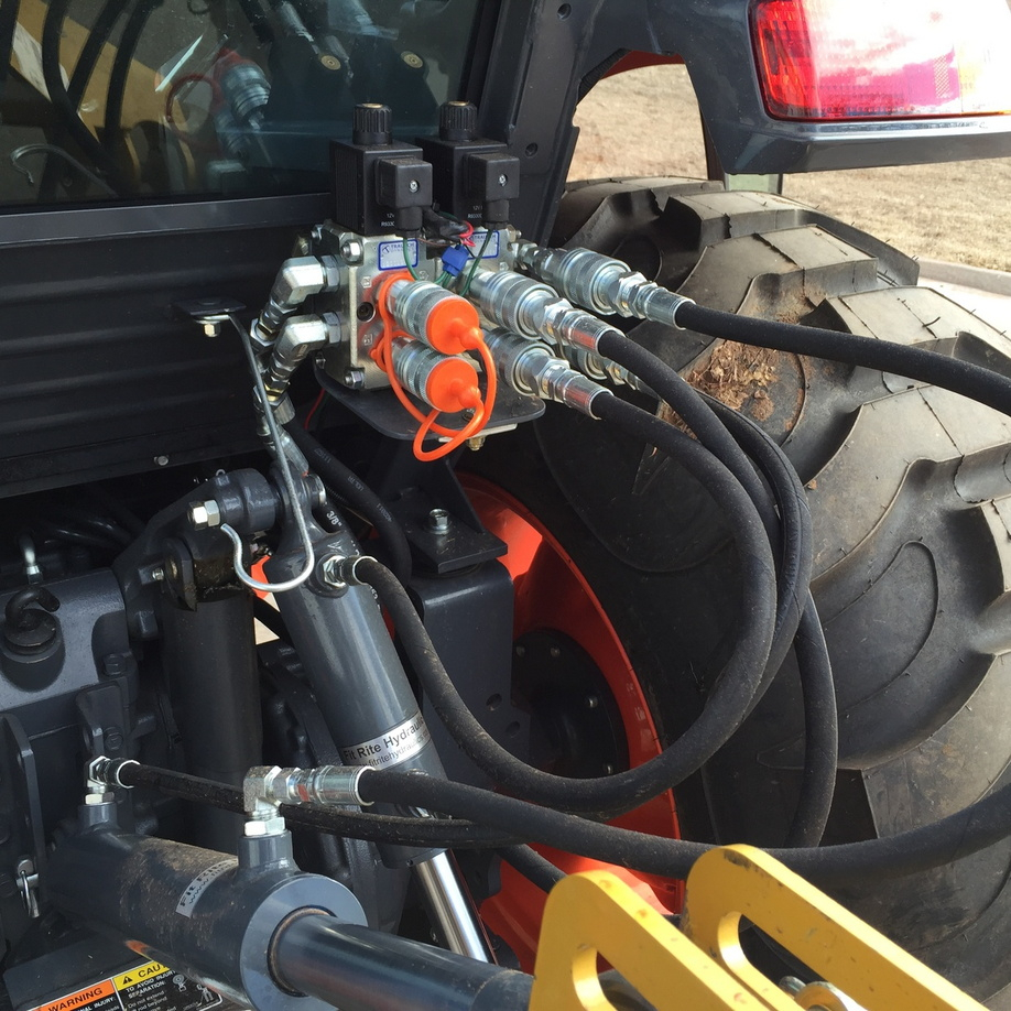

Sorry, I'm serious. Why the 3rd remote?
I need 4 remotes with some implements. My offset flail ditch mower, for example, requires 2 and the T&T needs 2. I have 3 on the rear of my L6060 HSTC and use the 3rd function valve as a 4th. It's tough to mess around with diverter / multiplier valves with a cabbed tractor unless they are electrically actuated.
   / Buying Advice on Hydraulic links #37
Such as the one used in the photo. This customer had a single rear remote and needed 3 sets of couplers.
A double diverter took care of his needs. :cool:(y)

I'm going to agree on 3 remotes if it is an option... @ovrszd & @MtnViewRanch (& others) have pointed out good reasons for them... Our NH TC40D had one rear remote when we purchased it used... I added 2 additional rear remotes & a front mounted diverter valve & now would not want to be without. Front diverter valve operates the grapple or the tree / post puller, two remotes dedicated to the TnT purchased from Brian @ Fit Rite (MtnViewRanch) & the third is used with the wood chipper, the back blade or the snow blower... I do think I need to add check valves to the top & tilt cylinder as they seem to not stay under load (but not sure the correct way to do it yet)... however I like being able to leave the TnT connected & still having the 3rd remote available for implements...
