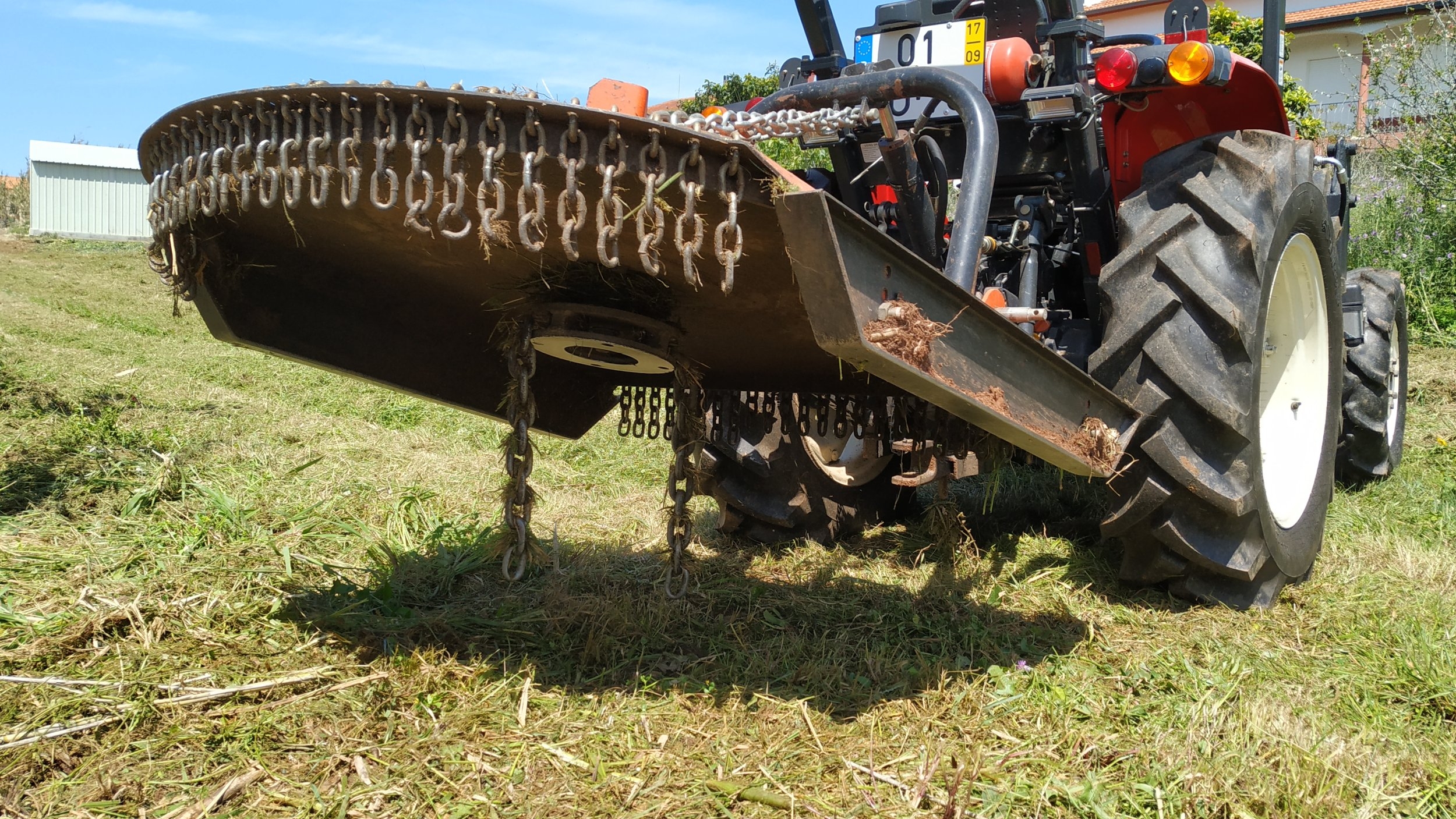

No issues with mine after 350 hours of all kinds of stuff thrown to it. It does need to be some good sized chain. I often see very thin chains and too much space in between, that won't work very well. Mine uses 5/16" chain.
   / Bushhog question.... rear or front discharge? #29

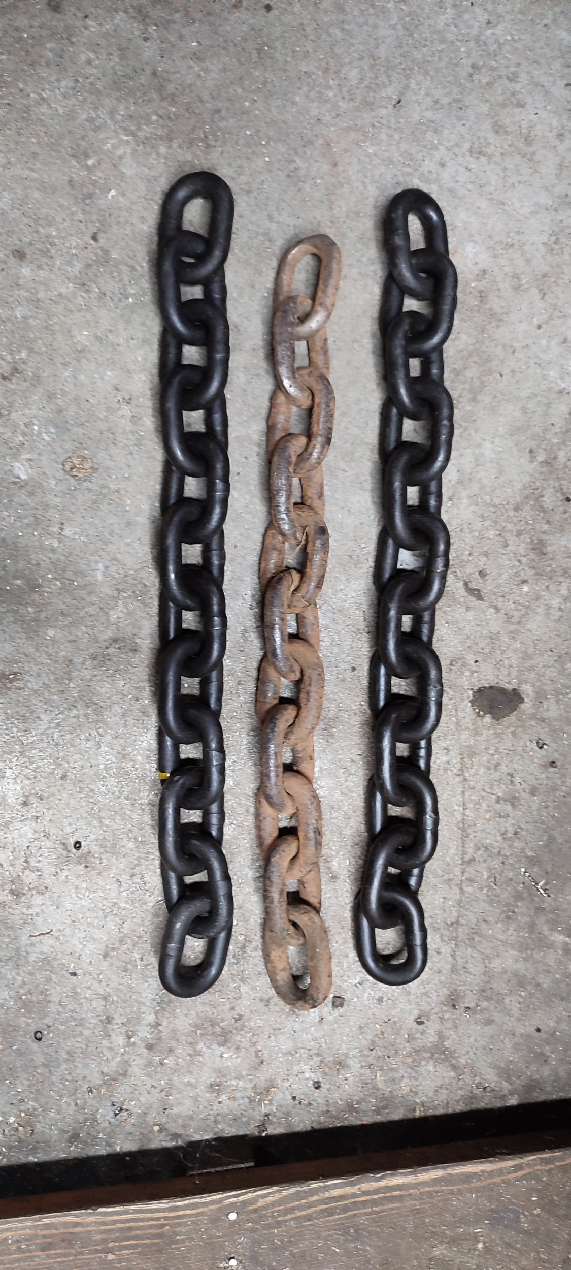

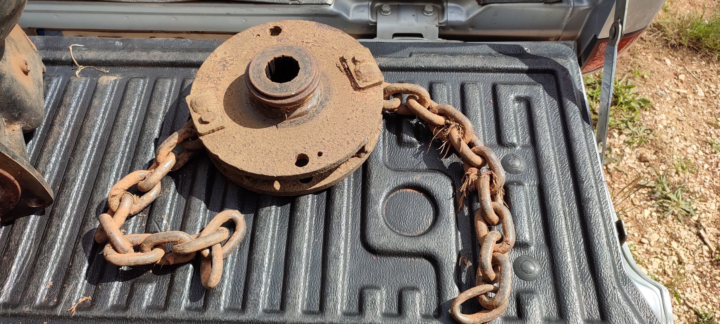

How are those chains for blades working out? They look like they might be 1/2"? I have always been leary of using chain for that.
   / Bushhog question.... rear or front discharge? #30
That's all we use here in Portugal. I would say, 90% of the cutters have chains. They are sold that way. Very few brands offer blade as option.
Mine uses 1/2" Grade 80 chains. It won't care about rocks, stumps, hidden objects in the middle of the brush, etc. Just keeps on going. These are really great even though it does need some HP to run and it may not leave as nice of finish as blades but it's a brush cutter after all.
I have about 350 hours on this set of chains. At about 250, the link at the end of the chain wore out so thin, it eventually cracked and broke. Both halves of the link landed exactly where it broke. I ended up cutting one link off the other chain and have been running 11 links instead of 12.
Now it's wearing out almost too thin again. Once it breaks, I'll replace with a new set of chains. I bought 2 new sets a couple weeks ago.
