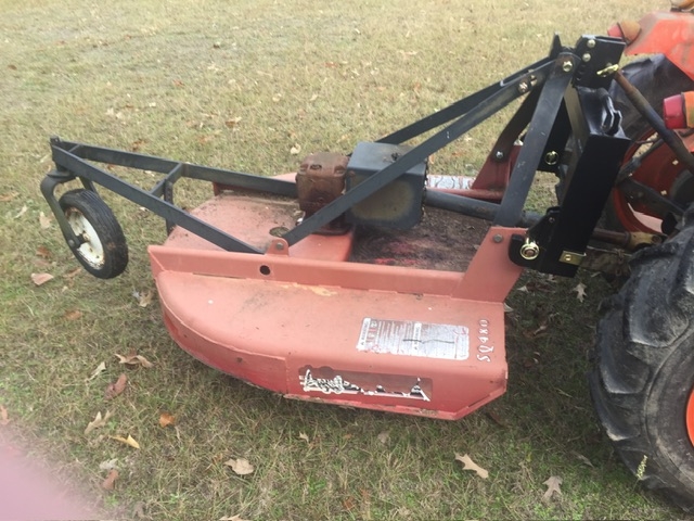

Looking at purchasing a 5 foot bush hog for my L2502 and I'm wondering should I buy a rear or front discharge. Could anybody shed some light on the pros and cons of a rear discharge vs front discharge?

The only front discharge brush cutters that I am familiar with are the front mount skid steer type. I would not want material purposely being discharge back at the tractor. Perhaps I am misunderstanding the question.

My BushHog brand cutter is front discharge and I wish it was rear. Mainly because of the crap that is thrown on you while mowing. But a rear discharge would be much better backing into brush to cut. Mine pushes the brush down and the blades never touch the brush.

The only opening is in the front. It does cover you and the back of the tractor with grass. It has thrown big rocks 30 plus yards in front of the tractor before. Maybe it is not called front discharge but that is exactly what it does.
/ Bushhog question.... rear or front discharge? #9
That looks like a Bush hog brand Squealer, I have a model 720 which is a 6' and while I bolted a piece of heavy duty conveyor belt to the front of mine for the occasional piece of debris of rock mine is not a front discharge.

My understanding is the brush hog on the back of tractor the front is lower that the back so the discharge is at the back

What I think you have mistaken for front discharge is a regular rear discharge machine.
The front is open so the grass can enter the cutting area without being flattened before cutting, doing a better job.
It is designed to be discharged in the back.
Sometimes the blades strike a heavier object that gets thrown out the front, hence the chains or other barriers used.
I'm guessing you are a rookie around equipment.
Side discharge, rear discharge I've heard of.
Front discharge where you would be recutting the same material over and over makes no sense.

You need to adjust the tail wheel it needs to be 2 inches or so higher than the front of the cutter . The front part does the cutting.
This right here. When the rotary cutter is lowered to the cut position, it should be at an angle with the front of the cutter lower than the rear.

I adjust my rotary cutter so the front is lower than the back. IMHO if it was intended to operate level it would have wheels on the front like a finish mower. Rotary cutters without front guards are "carried" by the tractor and the trailing wheel keeps the blade from hitting the dirt over humps. Lots (most) of people try to run with the deck level for "mulching" effect. The "bush hog" type when run with rear of deck higher by default "discharge" out the rear. The front edge of some mowers is higher to keep from bending over the vegetation and to get blade contact on the front.

Try adjusting so the rear is higher than the front. The drawback is if you operate too fast you can see where the blade makes its cut. Using a rotary cutter for mulching (chopping up debris) without positive front guard will result in some of the bigger debris being ejected out the front. It's the nature of the beast and physics like gravity is hard to fool...
