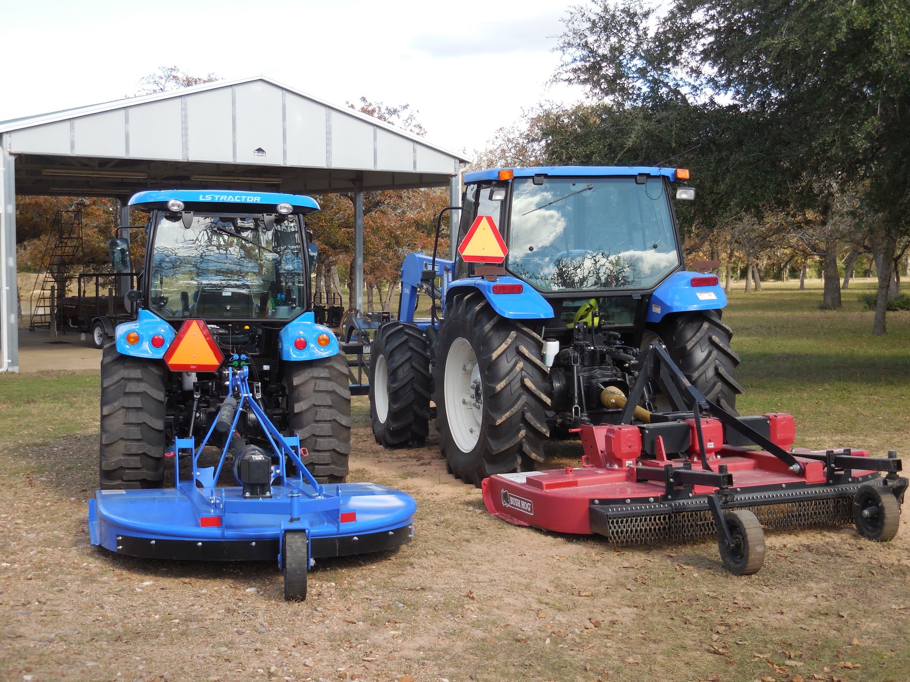

WHOO_EEE there rigustifson. Post #15 - lower pic - tractor on the left(LS XR 4155). Looks like you've been out raising some serious dust with that cutter. The way that tractor & cutter look - it must have been one H*LL of a dust cloud.
/ Bush Hog vs Woods vs.....? #31
Before I took that picture I had blown most of the dust off the windows on the New Holland. They had looked the same. When it gets dry here, our sandy soil is like mowing in flour.

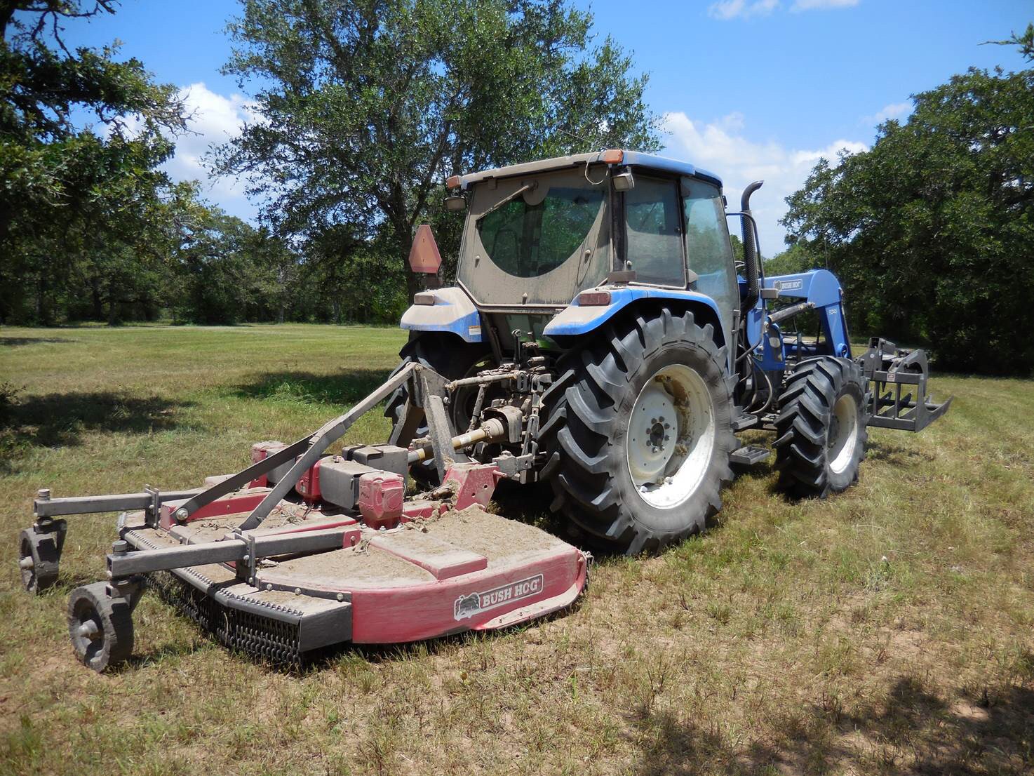

That is another reason why you need a cab when running one of those (dust and bugs). Mine has way more grass and limbs on top after cutting my pasture.
