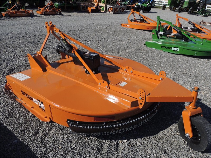

Fast forward to today and I still haven't used this beast. Between work and weather, I haven't been able to cut. I did get the BB720X connected and set the cut height to 3". I even put my 4' level on the deck and measured to make sure I had the proper drop in the front as the manual suggests.
However it just doesn't seem right and maybe it's because I'm down to 3". When in transport position, the tail is way up in the air. At cutting height, my top link is snug, not overly tight. I was also thinking this unit had movement at the top link position (like my previous Woods finishing mower) but it seems about rigid. Not much movement at all.
Far as I can tell, everything is right...just looks odd to me when it's in transport. That and I expected more movement at the top link position.

The flex joint is just behind to upper link connection.
/ Bush Hog vs Woods vs.....? #45
IF the tailwheel is raising too high for your liking when in transport mode.... the toplink where connected to tractor needs to be in a higher position. The higher the toplink on the tractor side the less the tailwheel raises.

I saw the joint but mine didn't move much. After adjusting the tail wheel for height, I think that the kid who assembled this thing thought that over torqued is best. It was all my impact gun (1/2") could do to loosen the bolts. I think I am going to go through that section and loosen and make sure everything moves as intended.

If having the tailwheel way up in the air is okay, then I'm fine - it just looked odd to me. I've never had to adjust the top link between the 3 settings on the tractor. I'm at the lowest point, which I believe is typical. I was unsure of any downside to moving the top link to a higher position? i.e. new tractor and never had a need to adjust that position before on previous tractors.
/ Bush Hog vs Woods vs.....? #48
No issues with the tailwheel hiked way in the air but be cautious of your PTO driveline angles.
Where you have it set now, lifting the tailwheel the highest.....is an asset when loading on a deckover trailer, or crossing a ravine or something similar.

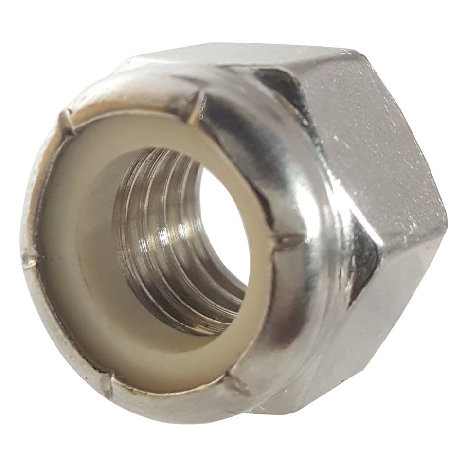

Make sure that Nylock style nuts are used on the flex connections.

I'll see if Woods used Nylock's or not. If they didn't I'll get some and/or blue Locktite.
