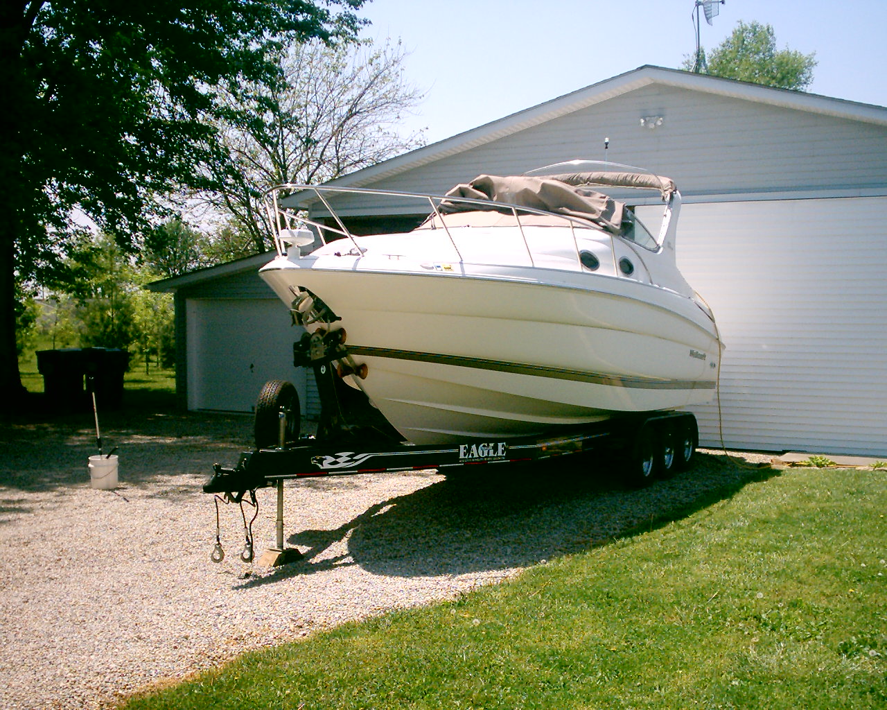

I know we are talking about apples and oranges here but I bumper pull a 31' tandem, a 33' tri axle, and a 38' tri axle boat trailers with my F-350. These are boat lengths so with the tong of the trailer each is about 4-5 feet longer than that. I have a 15,000# hitch on my truck, the 2.5" tube style. It can be tricky to make the turns especially with a boat trailer due to the axles being located 3/4 of the way back or so. On a equipment trailer it should be a little easier with the axles being located more toward the middle of the trailer.
The pic in my avatar is my F-350, not hitched up, and the 33' boat with a total length of 38' from ball to prop on the boat.
Here is a pic of the the boat and trailer also.
Chris

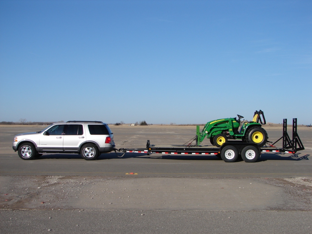

Here is a photo of my 22ft. PJ that has an empty weight of 3,400 pounds and my JD 3320 with loader that adds another 3,700 to the combo. My "Super Duty" Ford Explorer handles it just fine. Just because the trailer is rated at 14,000 pounds doesn't mean I'd load it that heavy. The longer trailer was great when it came to moving the tractor forwards or backwards to shift tounge weight.
My 2 cents

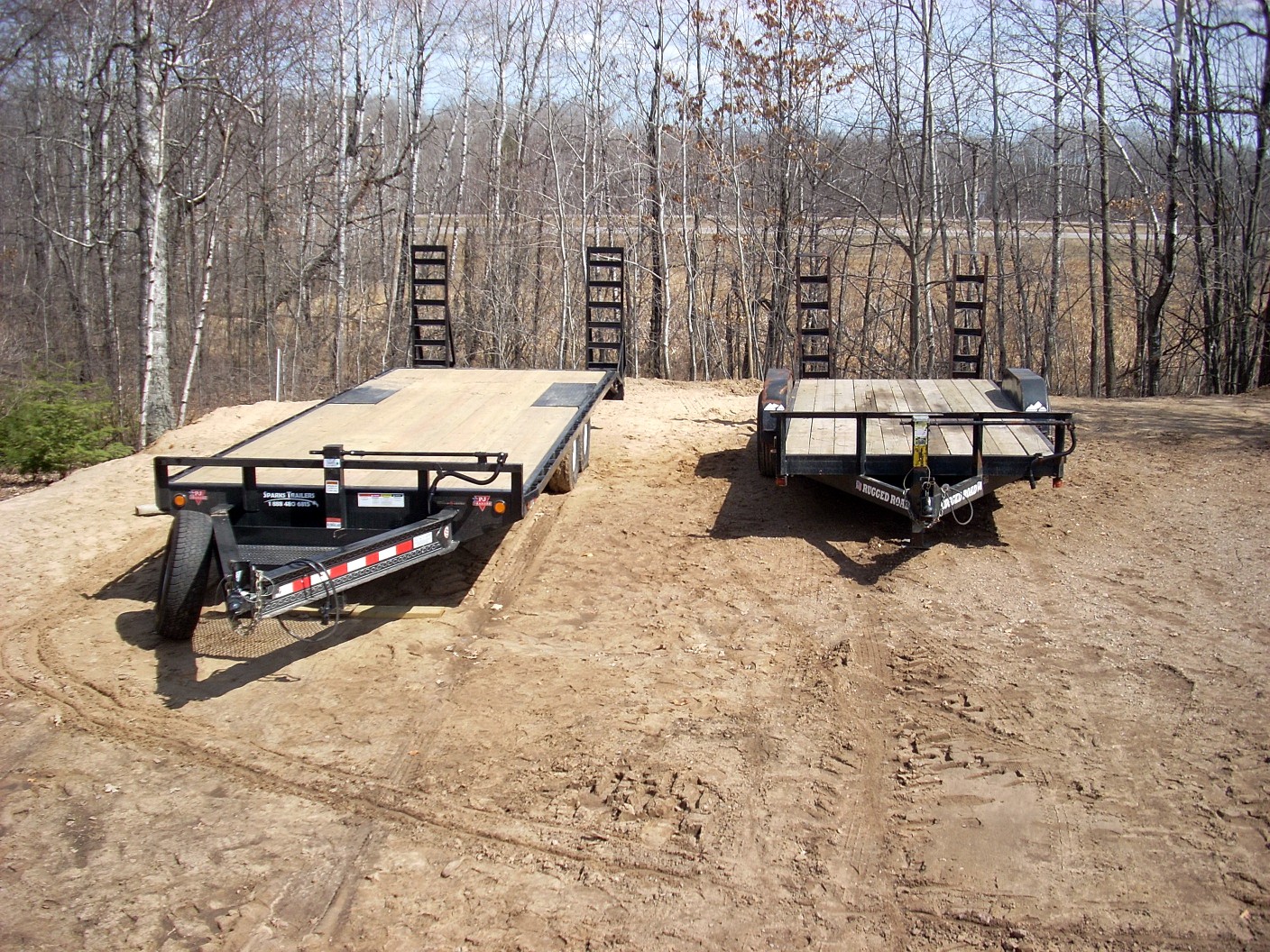

I stepped up from a 12K 7x18 bobcat style bumper pull to a 14K 8x24 deckover this Spring. OAL went from 24' to 31', Weight from 2K to 3.8K lbs. $3.2K in '02, $4.2K delivered to the farm in Apr. Sold the bobcat in June for $1.8K.
6K axles could have 6 bolt wheels, less availability than 8 bolt wheels.
Deckover has 6' tongue vs 4' on bobcat. Makes tight turns easier as the tongue completely clears dump box, and is needed with the longer trailer wheelbase. Deckheight went from 24" to 33", ball height took a significant jump but did not measure, I just went to a trailer parts & steel dealer and ended up with a 20K ball mount and a riser type 30K 2 5/16 ball to get the ride height.
My biggest problem with the bobcat was exposed fenders and un-noticed damage causing tire blowouts down the road. The inner tire sidewall would rub against the fender. Ka-boom & $100 replacement.

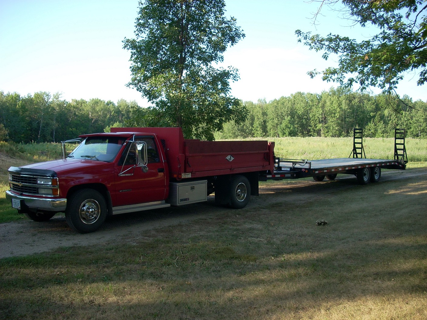

A potential problem with a long bumper pull is hitch weight. Many manufacturers use the 60%/40% rule when placing the axle centerline. this works great with smaller dual axle car haulers, but it tends to place too much weight on the front of longer heavier trailers. Especially when we have to load the tractor far forward so that long bush hog will clear the rear ramps. Anything 20 foot or longer, I would want those axles moved forward a little (8 or 9 inches?). This helps prevent overloading the hitching parts, and still provide a good front heavy balance to prevent sway. Even our 3/4 and 1 ton trucks are often originally equipped with 10K/1K hitching components. A tractor on a long trailer can easily produce a couple times that 1,000 pounds limit. Not a safe configuration at all.
/ bumper pull 24 ft. #14
You are right Crash. So far all my loads have been short enough to keep the tongue load just right. With 20' on the flat I could easily roll a vehicle far enough forward to put over 2000lbs on the hitch. I can see some items left back on the dove to compensate. Right now if I pull a car on and leave the back tire at the back of the flat its just right. Haven't backed anything on yet to see how that looks. The 10% tongue weight recommended doesn't quite work when the loads are 10K or better and it appears its not necessary on the longer trailers either. If I maintain about 500-700lbs on my new trailer that seems perfect regardless of whats on the axles.
