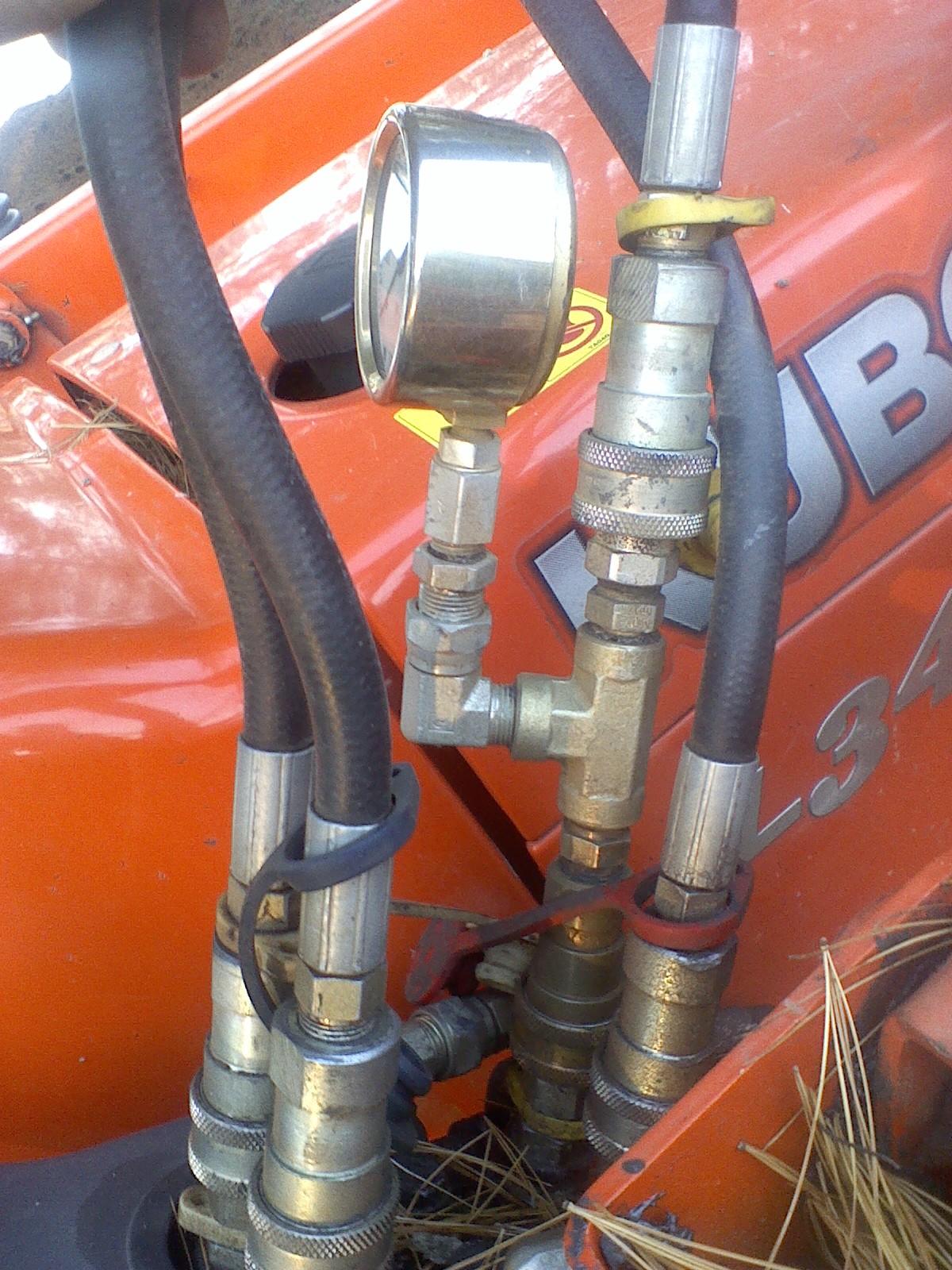

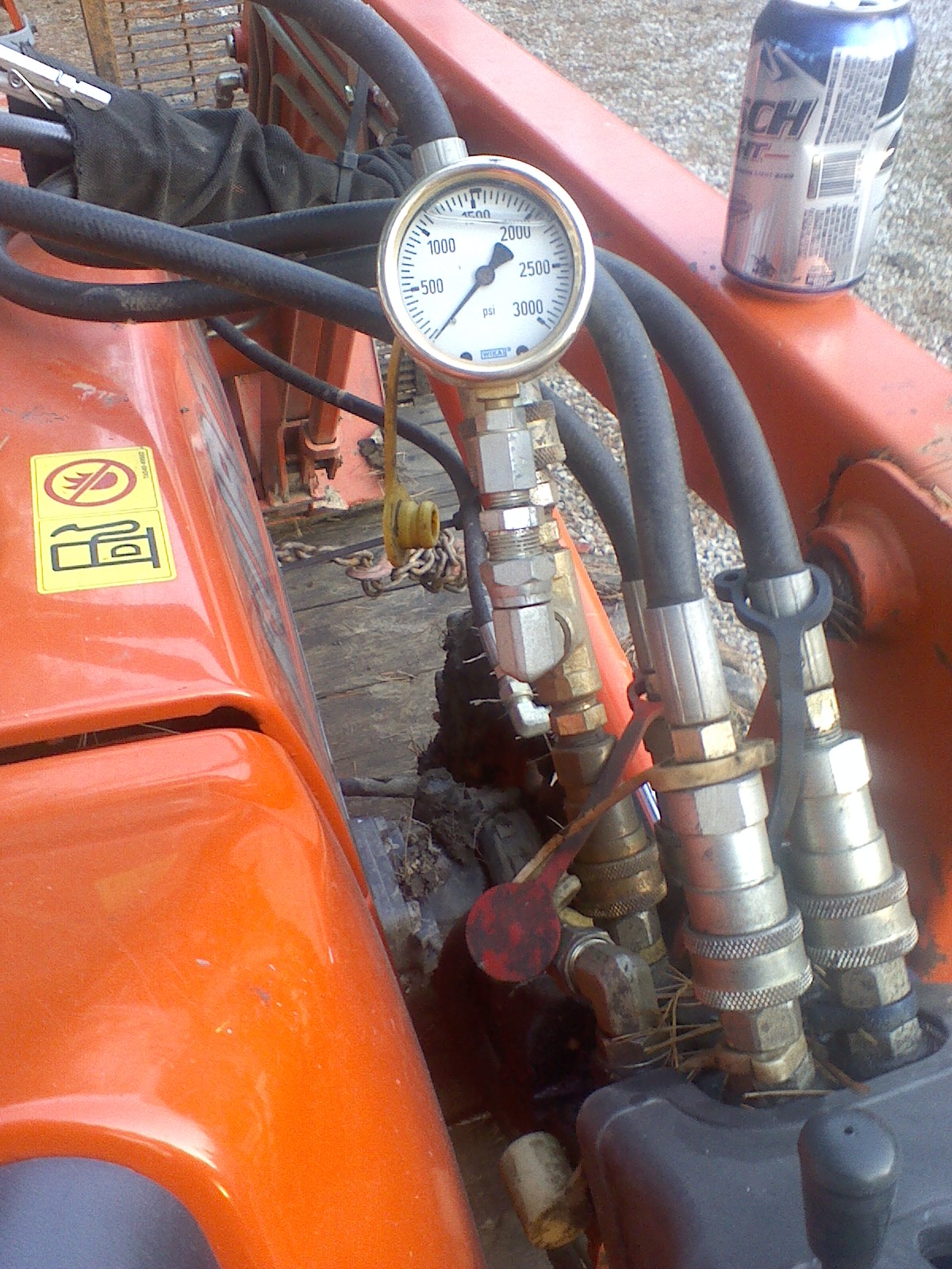

Curious why you did not install the gage in the IN port.
With gage installed in the IN port, it will indicate any pressure develops by your hyd. FEL, remotes, 3pt.
Several reasons actually.
First, the location wasnt the greatest to be viewed from the operators seat.
Second, with a little math and experience, I can judge pretty close, how heavy something is that I am lifting. If I had that on the IN port, I wouldnt have any idea if the pressure I was seeing is from the curl, 3PH, or lift circuit. So I put it on the lift.
It is also installed with quick connects. So if I need to check/troubleshoot another circuit on the FEL, I can move its location easily.
Here is what my install looks like:
View attachment 405516View attachment 405517
LD1, what exactly is the female/male connectors on the FEL are they ISO 7241 A's or ISO 7241 B's? are they 3/8 or 1/2? I never was sure what they were.
You can read the pressure for each spool operated on the tractor with the gage in the IN port of the first valve.
You can also figure load using pressure on the 3pt.
Not sure what the iso number is. They are parker 60-series in 3/8"
Yes, that only allows me to see what pressure it takes to operate. After the valve is closed, I am no longer getting feedback as the circuit is isolated.
I like the dynamic feedback. Like when pushing on something with the FEL, I can see pressure climb. When using curl to try to lift something the loader wont, I can see how high the pressure is getting in the lift cylinders. When loading a bucket full by hand, weather its stones from the field or firewood, I can keep an eye on the gauge to judge the weight.
From the Parker web site.
60 Series Couplings are general purpose, double shut-off, quick disconnects that can be used in a wide spectrum of applications. They have poppet valves and manual sleeves. 60 Series couplings comply with industry standard ISO 7241, Series B.
