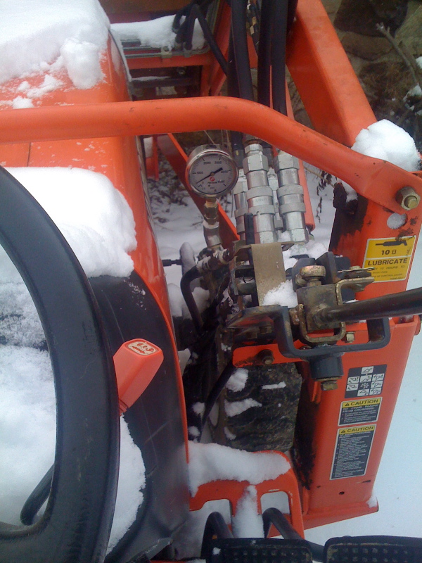

No problem, I did see you have a B2910 so it might not work for the L xx00 models but always good to see photos :D
teg,
Here ya go - taken from the operator's seat:
(Cover for the valve is off because I'm in the process of adding front aux hydraulics for a grapple)
   / Bump up lift capacity of L3400/LA463 Loader #235
teg = you bet, and think I can tighten it a bit more!
I bet you can if not done right the first time.
That is absolutely the wrong way to adjust the pressure on that type relief valve.
You should insert the correct shims and torque the hex plug to the specified ft lbs and then don't mess with it.

teg, Here ya go - taken from the operator's seat:
Thanks, yea, you got extra room... mine's a bit tight (especially after installing my extra spool).
J_J, I guess I'll tighten her down and see what she reads... Dealers are not going to "play with shims" to get it right. I'm guessing most of them do the final adjusting with tightening it up until it reads a target psi. I assume none of them torque to a certain number.
LOL ... yeah, I'd say so ...
Still ...
C'mon ... post a shot of the left side of that valve set up ... I'll bet it could be shoehorned in there somewhere ... :D
