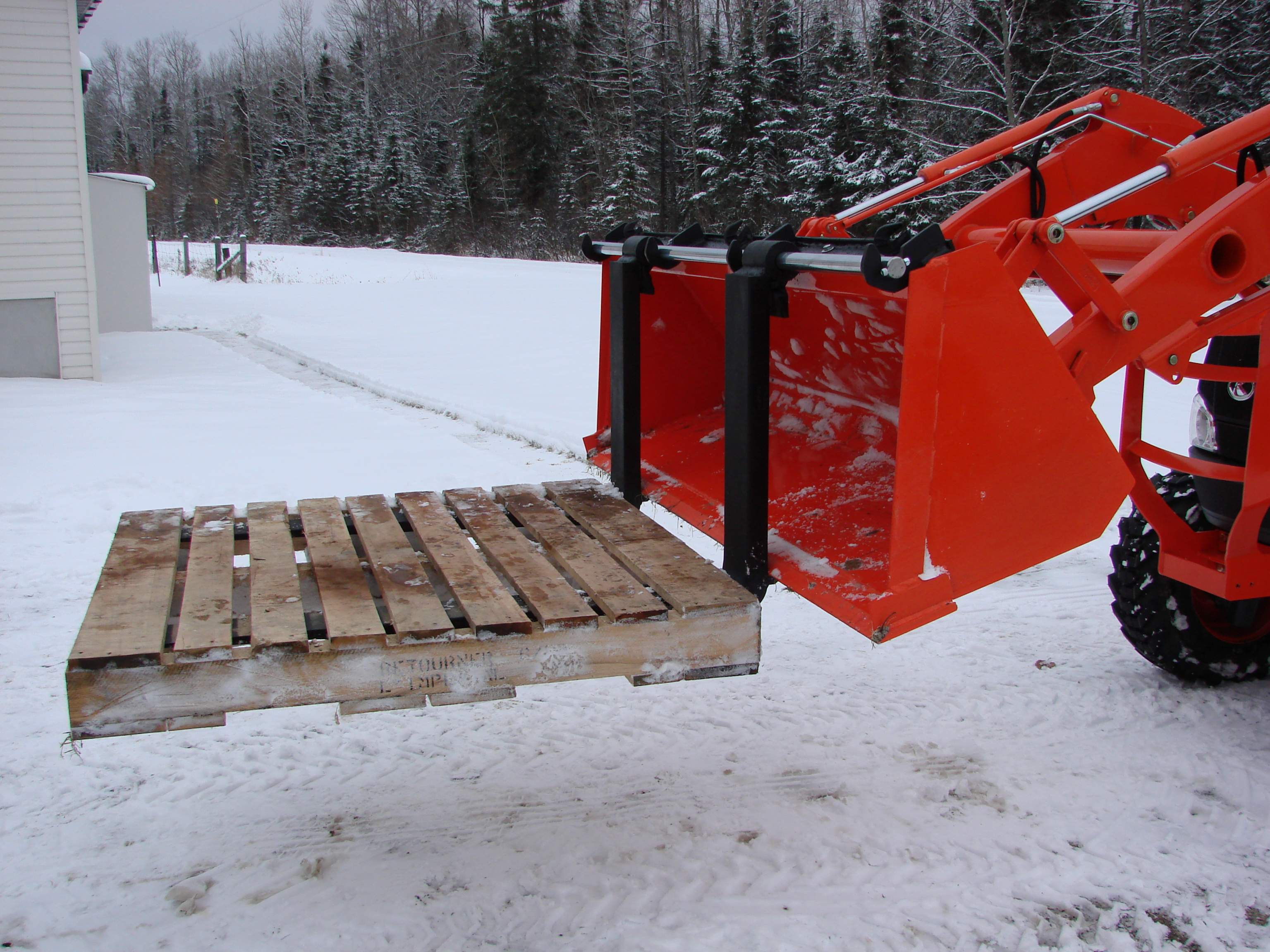

[/IMG]I finally got around to building some quick attach forks for my John 2750 with a 245 loader. The folks over at the Hobart web gave me a great recommendation on 7018 rods on DC+. It made welds that looked better than I ever thought I could make.

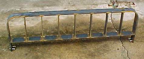

/ Built my first attachment for loader
Thanks for the kind words. I know it doesn't look factory, but I think the tractor will break before it does. My dad and I argued about the channel iron on the ends. I wanted to put a grate so that things cant fall back on the operator and he wanted to cut them off. We compromised and let them stay since it is a self leveling loader..

Just curious, do I see welds where the forks hit the bottom crossmember? In other words, will your forks slide sideways?
Jim
/ Built my first attachment for loader #19
try again
Nice Job.. It just dawned on me.. If you were to weld a couple of eye hooks on the back vertical you could then drill a hole in the middle of the bucket and chain the thing down so they wouldn't lift when dragging backwards.

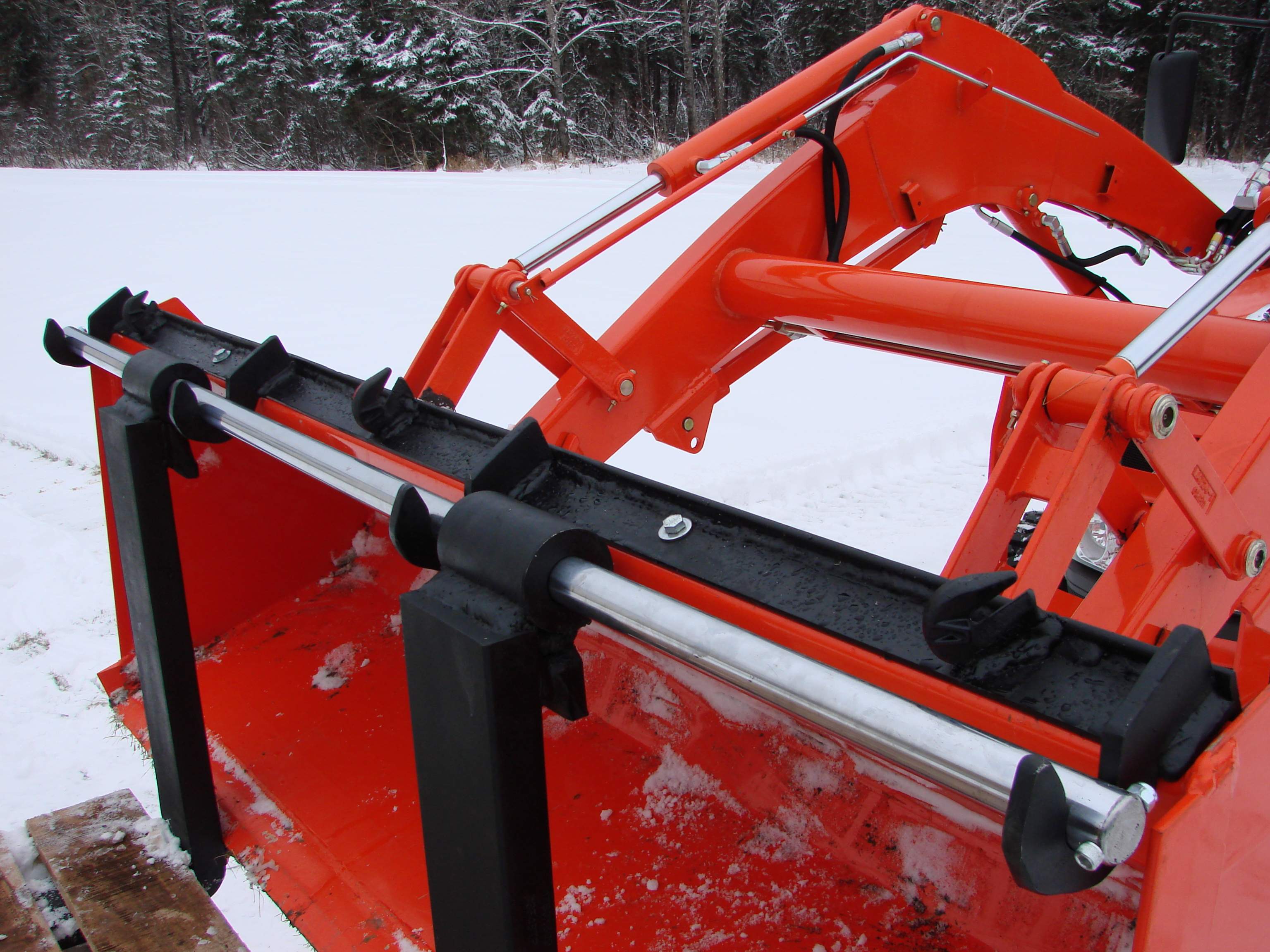

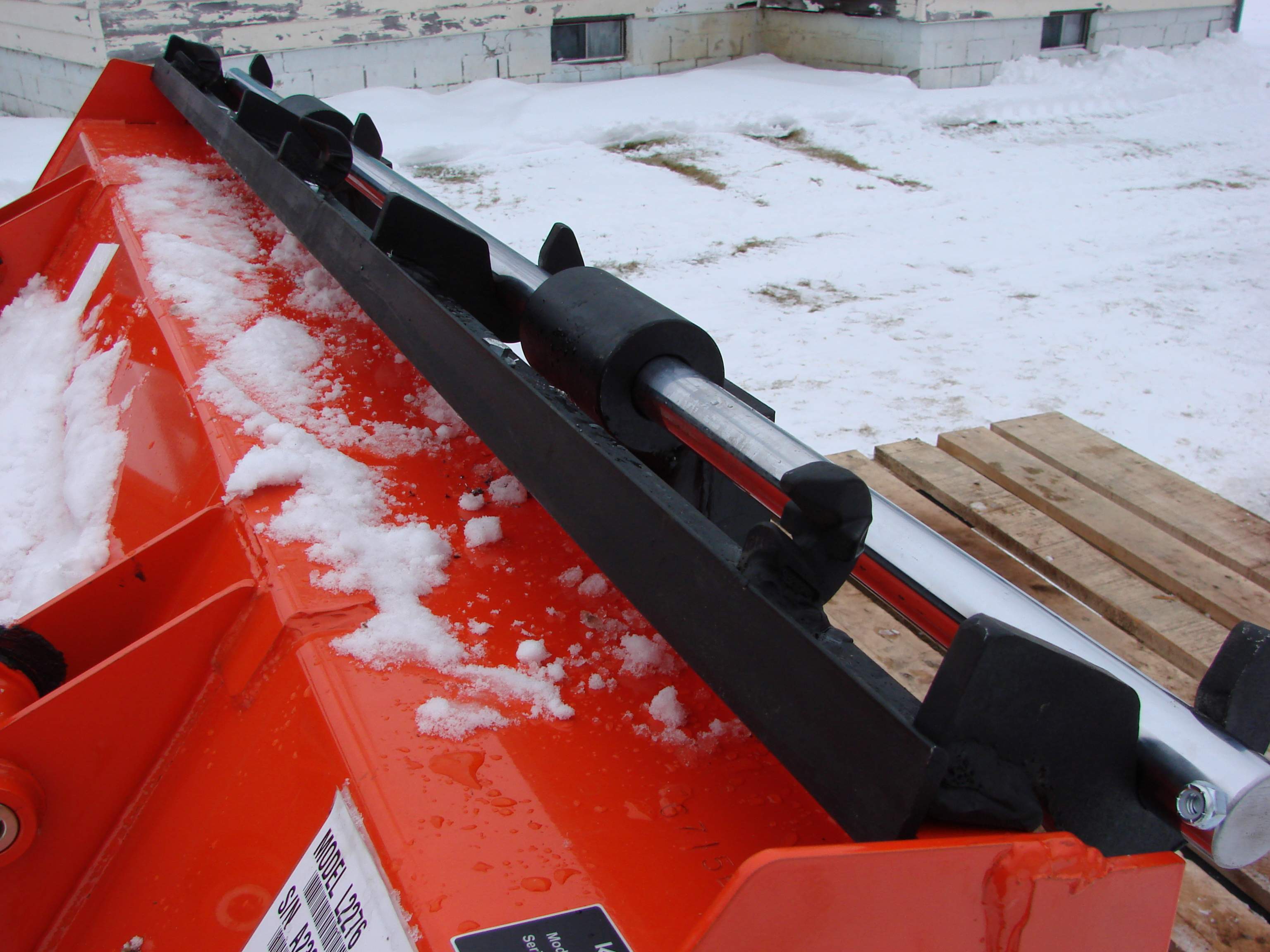

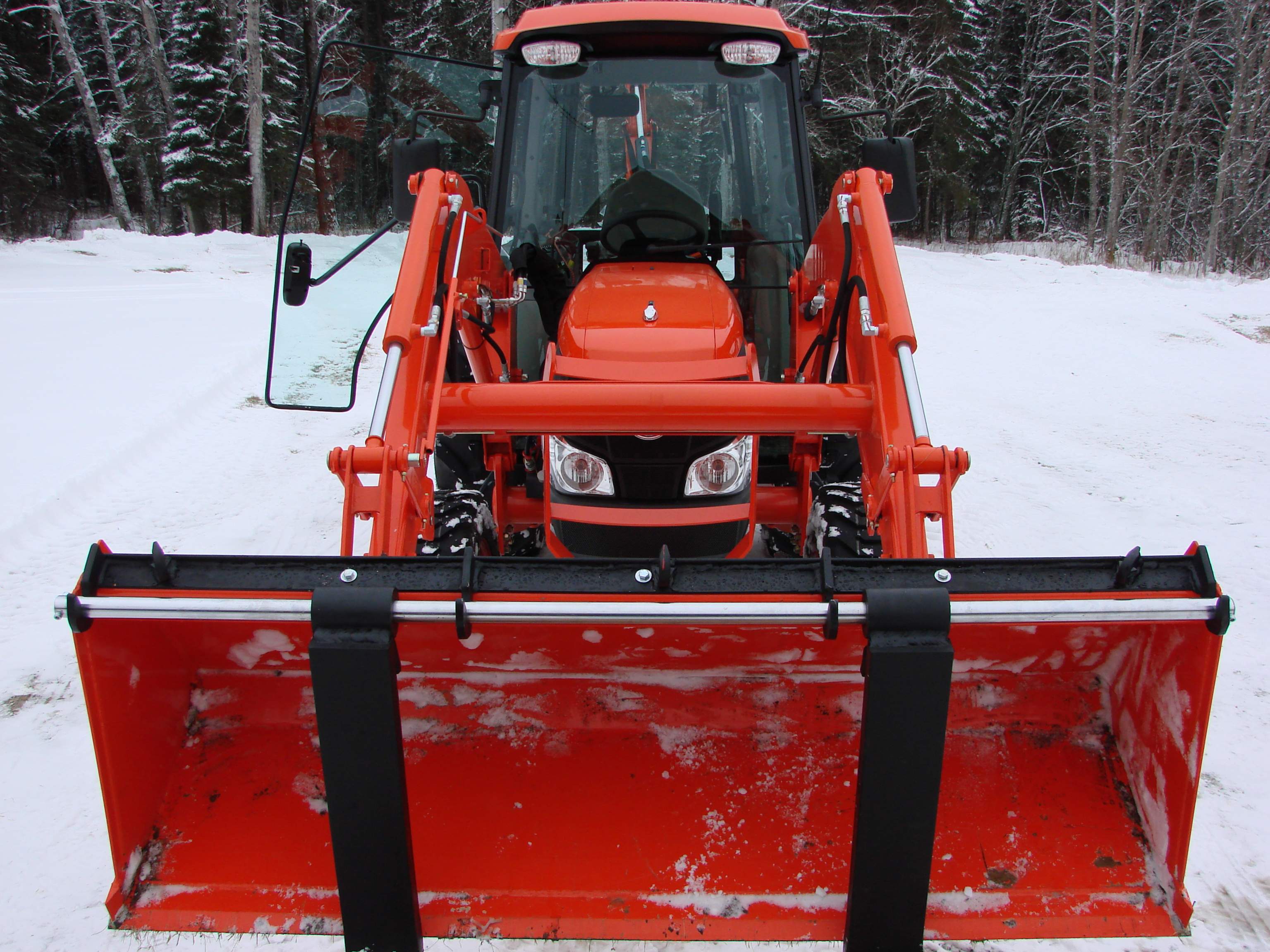

Very nice job. I like the quick hitch mount.
A few ideas to consider:
You could always add the top works for protection. The one I made bolts on. You could bolt to the channel.
I added some pins to mine so I could back up to my Speeco quick hitch and use the forks behind the tractor. The 3pt has a much heavier lift capacity which I use when carrying a 300 gallon tote of water. They probably would fit inside your Bobtatch so your would also work front or back.
Consider a chain hook on each side, near the top. Mine are used much more that I ever expected to.
