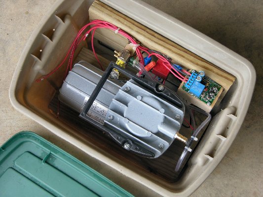

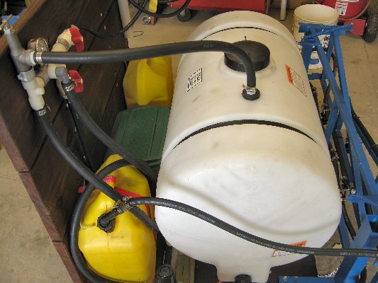

I had an opportunity to test run the compressor this morning for a period of roughly 3 hours straight. Since it was designed to be an aquarium air pump, it ran quietly and with very little heat. I'm very happy with the compressor and it now puts me one major step closer to wrapping up this project.

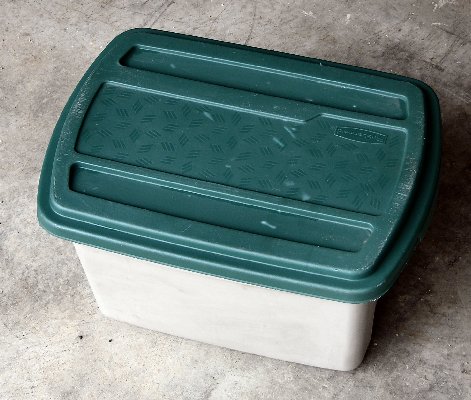

Since the compressor was a bit larger than the 1st it was necessary to find a Rubbermaid container to house the works. You can see by the pictures that that container neatly housed the compressor, solid state timer, relay, and the two air solenoids.
You can also see that the Rubbermaid box neatly tucks in between the 2 Jerry Cans on the Carry All with a nice snug fit. I'm still wondering what I'm going to tell my wife when she starts looking for her bird seed that she used to keep in the container. :rolleyes:
