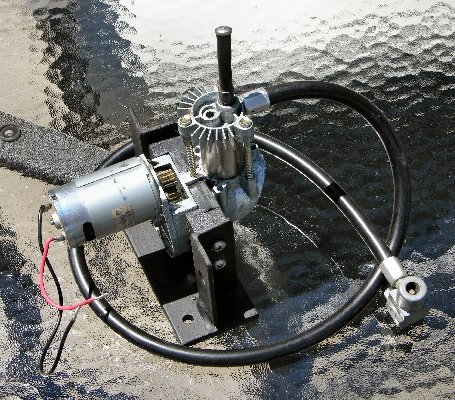

Here's a shot of the small single cylinder 12 vdc air compressor and a small mount that I welded up to fit it. This will supply the air for the foam generators.

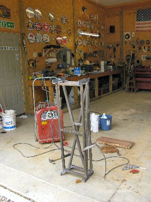

Here's a shot of the hinges being welded up to the collapsed boom.
Wanted to get some primer on the boom because if you use electrolysis to strip rust it's like freshly sandblasted metal. If you don't prime it quickly rust forms very quickly.

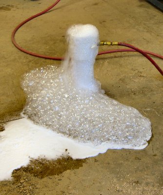

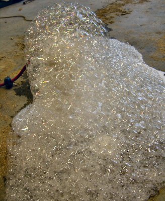

This was the 1st test of one of the foam generators using only 2 psi of air pressure and 1 teaspoon of the foam concentrate.
The 3rd picture was after the generator ran for 2 minutes, you couldn't even see the generator at this point it was covered with suds.
I'm going to add an air stone tomorrow to see if I can get the consistency more like shaving cream. My guess is smaller bubbles will form using an aquarium air stone, we'll see.

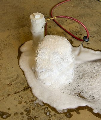

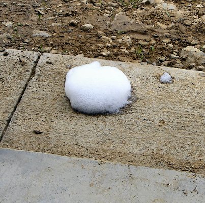

Today I used a small aquarium air stone and got a much drier foam which is what I was after. The 1st picture shows the generator working with the air-stone and at between 1-2 psi air pressure.
The dollop of foam in the second picture was an hour old placed on warm concrete, the ambient temperature is 85 and the humidity is fairy high. The fact that it stayed intact without breaking down is what I'm shooting for since it will have to last for a bit on grass before disappearing.
Woodlot you can purchase the foam concentrate from Agri-Supply here is a link to their page.
Once I get the foam generator dialed in I'll show a breakdown of how it's assembled from PVC pipe. (it's pretty simple in construction and yes, I made it)
I'm also pretty sure the foam is non-toxic but you may want to call Agri-Supply just to be sure. I have seen 110 volt foam generators at eBay that are used for the kids. They look like a sock stretched over a squirrel cage blower and they generate gobs of foam.

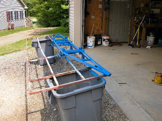

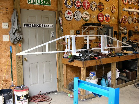

Making a little more progress. :rolleyes:
I'm very happy with the way the boom is turning out. Yeah it's probably a bit over engineered but the steel used in the boom was a gift so I figured what the heck, use what I have. The only items that I've had to purchase for the boom so far were the two break-away boom springs (not installed yet in the picture).
And before you ask just because it's close to the 4th of July it isn't going to end up red, white, and blue, nosirreebob. The white that you see on the boom is just bare metal primer. It will eventually end up New Holland blue just the the Carry All in the foreground.
Still experimenting some with the foam generator.

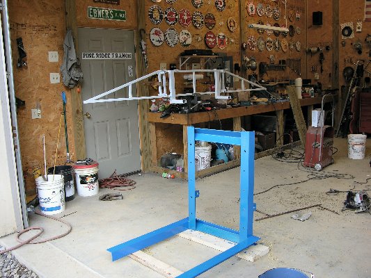

#19
Took advantage of the nice weather today before our Independence Day Party (tomorrow) to spray the initial coat of New Holland blue on the boom. You can see the boom being supported by an identical gate from which it was made. The two make an interesting comparison of sorts.
After some initial testing done with the foam marker think I need a larger chemical tank for the soap/water solution tank. The one I was testing held about a gallon of mix and it only produced foam for about 30 minutes as a result (way to short of a period). I'm looking around a bit to see what my options are. I would like to find something about 15 gallons.
