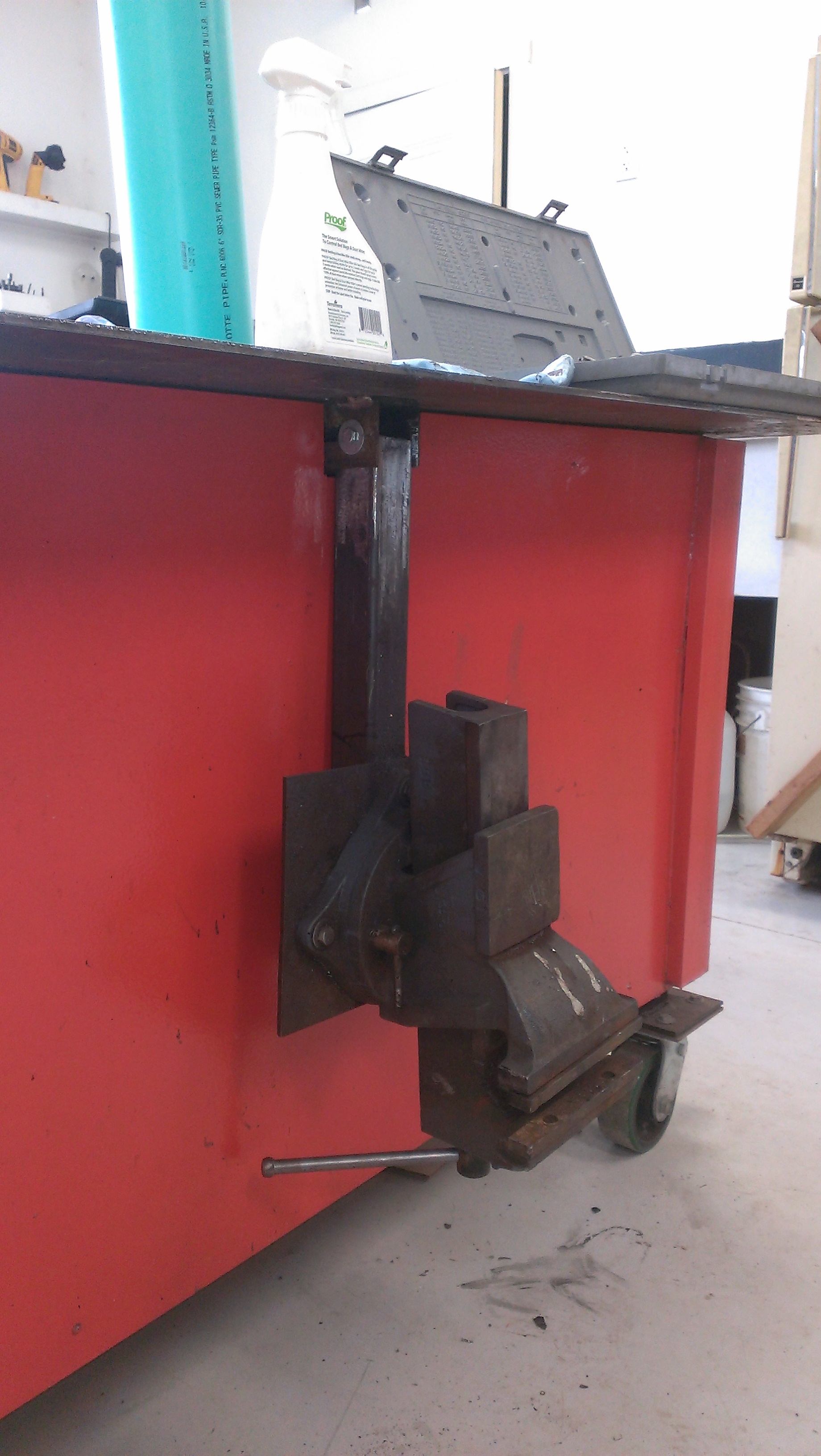

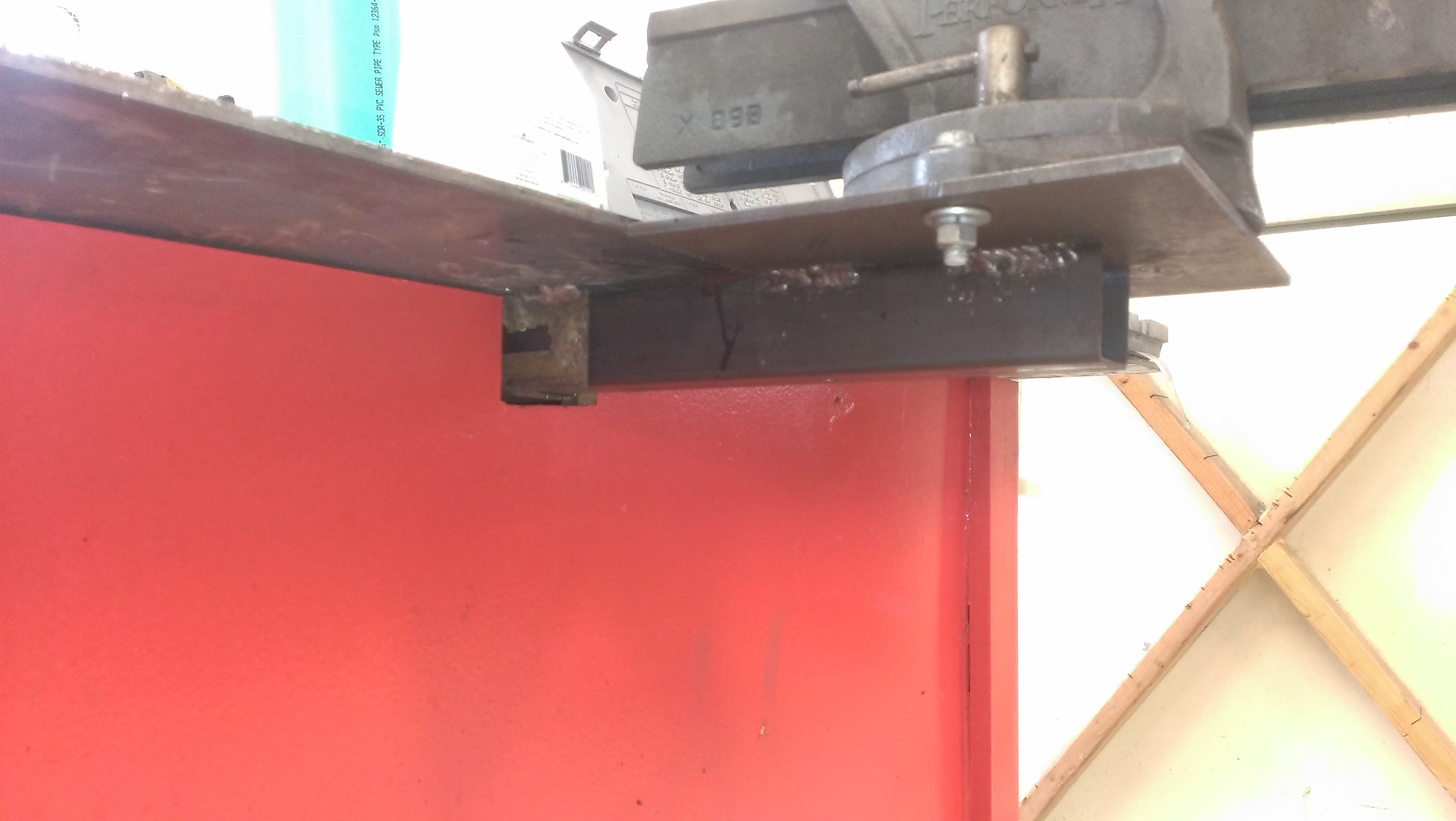

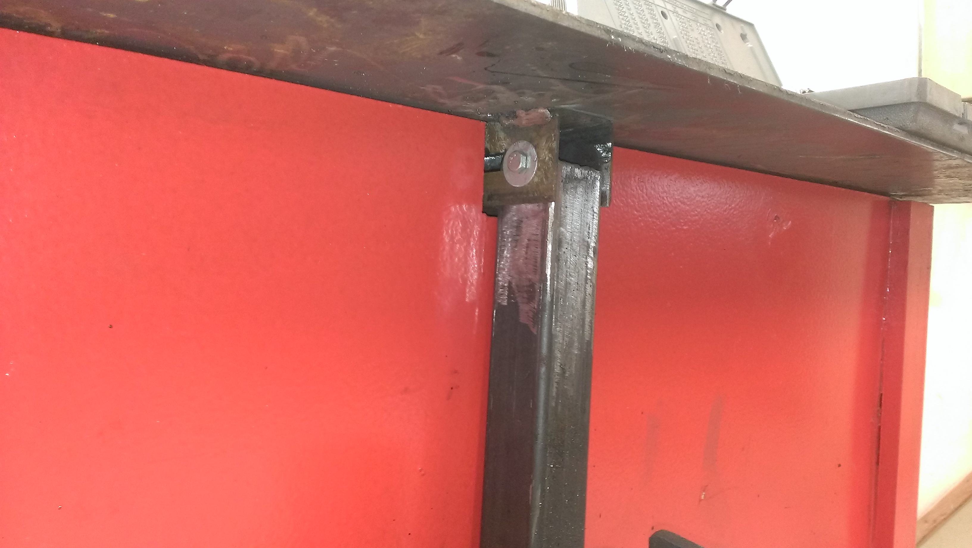

i like it so the vise on the bench flips out of the way. so for the big projects you can slid flat across table.
you notch end of tube so it flips down. and cut slot for through bolt.
you get to the end of the slot it stops the tube from coming out and acts as pivot. vise flips down out of the way
/ Building a Shop / Weld Table #63
Cool idea; I like it... Steve

How far in does it slide? I beat the snot out of stuff in my vise. Need it to be solid. :)
/ Building a Shop / Weld Table #66
if you think about it, your two inch receiver doesn't go in that far on say your truck and it is pretty sold. The one pictured is not a receiver tube as it is a smaller vise. I have made them out of 2" receiver tubes and they are not going anywhere. The one pictured is plenty sold. Slot it with your grinder, i use a 1/4" bolt all it needs to be is a stop and then slot does not need to be as wide.

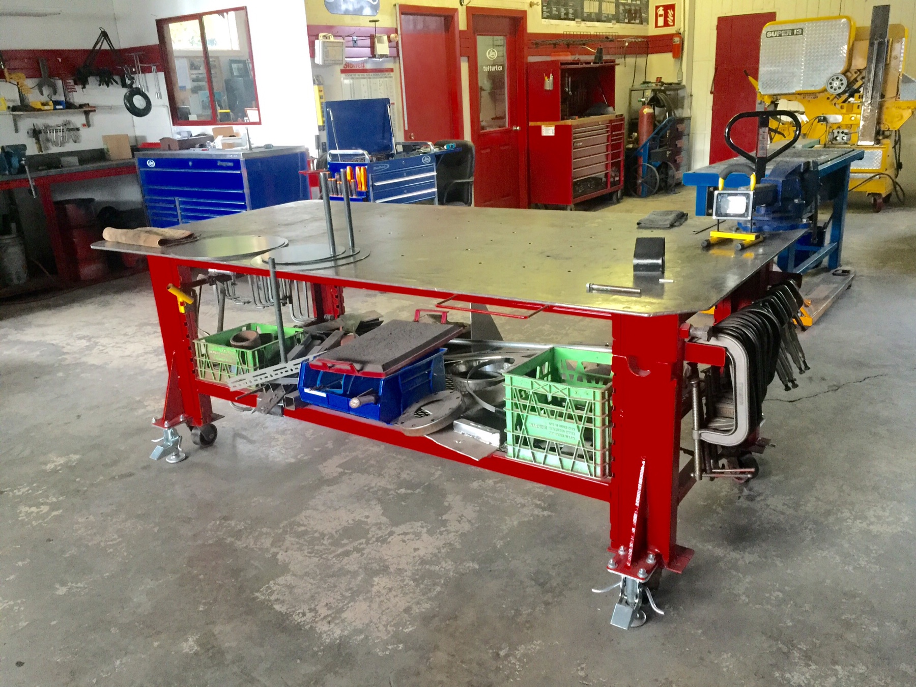

Almost there: Planning on picking up the top and square tubing this Friday. I already have the receivers and the casters.
One more question / worry.
This is the first time I have built a table this heavy and with casters. I am planning on the top being 3/8" thick, 30" deep, 60" long, with a 2" or 2-1/2" inch overhand on all sides. Height will be 36" about 7-1/2 of that will be caster, 28-1/2 actual leg.
If I put a 2 inch overhang on all sides, that will mean that the table legs on the end will be 26 outside to outside. Is this to skinny? I am wondering about the possibility of tipping it over. I had planned on the vise hanging off the long side too. To me that sounds to narrow, but all my table building experience is with wood, not metal.
Is it tipping over a practical consideration considering its weight? The top will weigh 192 pounds, the frame (approx 60' of 2 x 1/4 square tube) will weigh in at about 324 pounds, total about 516 lbs. That is not including the receivers that will be mounted (6 of them) or the grinder brackets, expanded metal bottom shelf, etc...
Just checking I like my toes! Besides, it might chip the concrete if it tips over. :)
/ Building a Shop / Weld Table #74
Things that will decide whether the narrow width is gonna be a problem -
terrain(smooth/level = good, rough/sloped = BAD)
caster size - you got that covered, unless you're on sloped/gravel (or worse)
Center of gravity - lower is better; which is why, if you're gonna mount the vise on the long side, you might wanna consider Truck Diagnostics' post # 62, this thread, and ONLY move the table with vise hanging LOWER - either that, or reserve a place on your LOWER SHELF for the vise, and ONLY move table with the vise down lower - (less of a PITA than a tip-over :eek: )
Where you push/pull on the table to move it - the LOWER the force is applied, the less likelihood you will tip it (might wanna consider something like a "wagon tongue" handle that attaches just above the casters, and push/pull with THAT) - in the same vein, push/pull LENGTH-WISE will be TWICE as stable as moving the table SIDEWAYS.
Example - I can tip my 3'x7', 1" thick table (approx. 900#) over BY HAND pushing sideways (not easy, but doable) - but NO way can I do that LENGTHWISE...
These are considerations I would look at if building a portable weld table; but YOUR level of OCD is probably lower than mine :rolleyes: - ... Steve

Luckily smooth concrete floor, only enough slope to send water to the front door. If moving it much I think I would always spin it a s shove it length wise.
I was thinking more about twisting of shoving something in the vise...

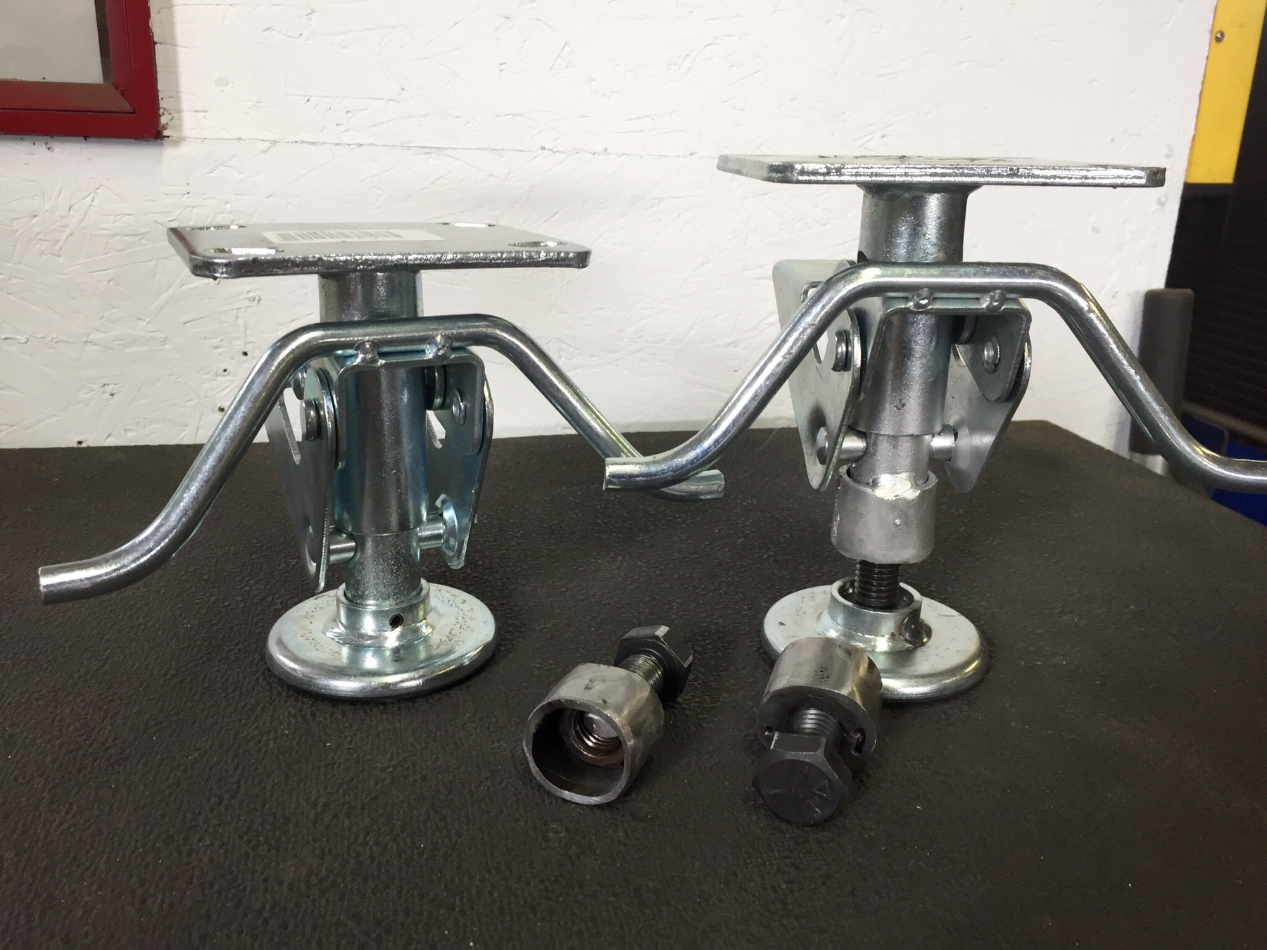

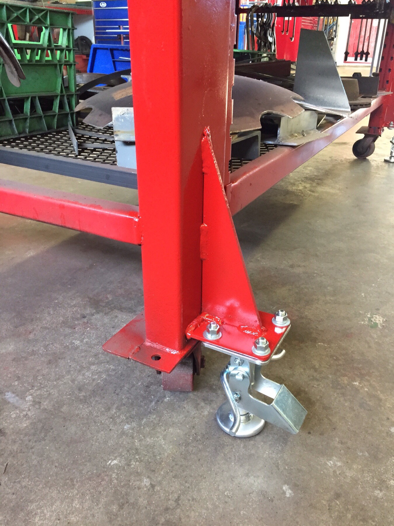

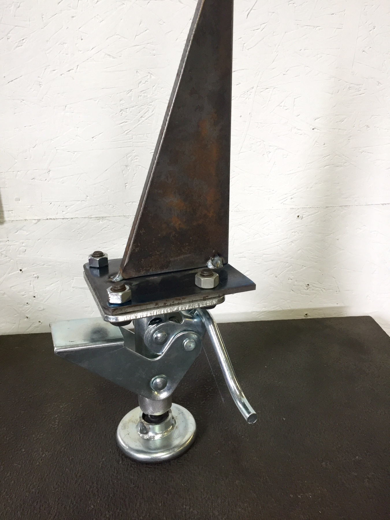

"I was thinking more about twisting of shoving something in the vise... "

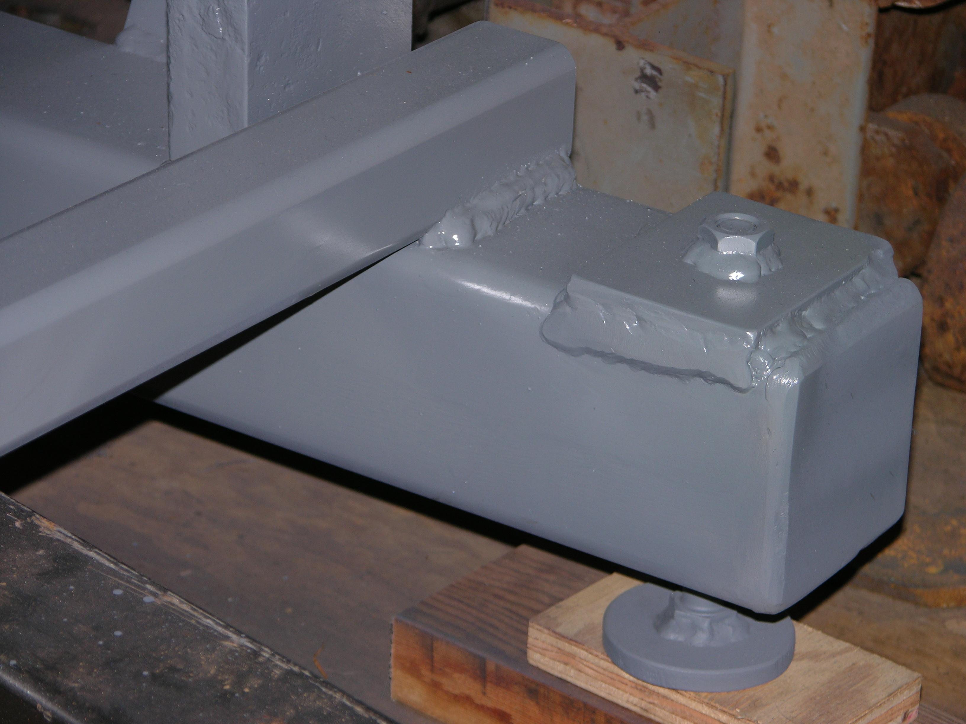

In that case, you may wanna add something like BigBarn's floor locks, or roll yer own like I did for my slip roll -
Those are just 5/8 grade 8 bolts, 3/8x3" foot welded to bolt head - I added 1/4" neoprene to bottoms since that pic was taken. No casters, I set up heavy things to work with either a pallet jack or forks.
Either way, you're probably gonna want pretty solid feet under the table if you're gonna "get vicious"... Steve

Keep your 2" or 2 1/2" overhang on the sides but space the legs 30" apart if you're set on a 30" wide top.
If you haven't already purchased the plate I'd be inclined to go at least 36" wide and perhaps shorter if you're concerned about space.
