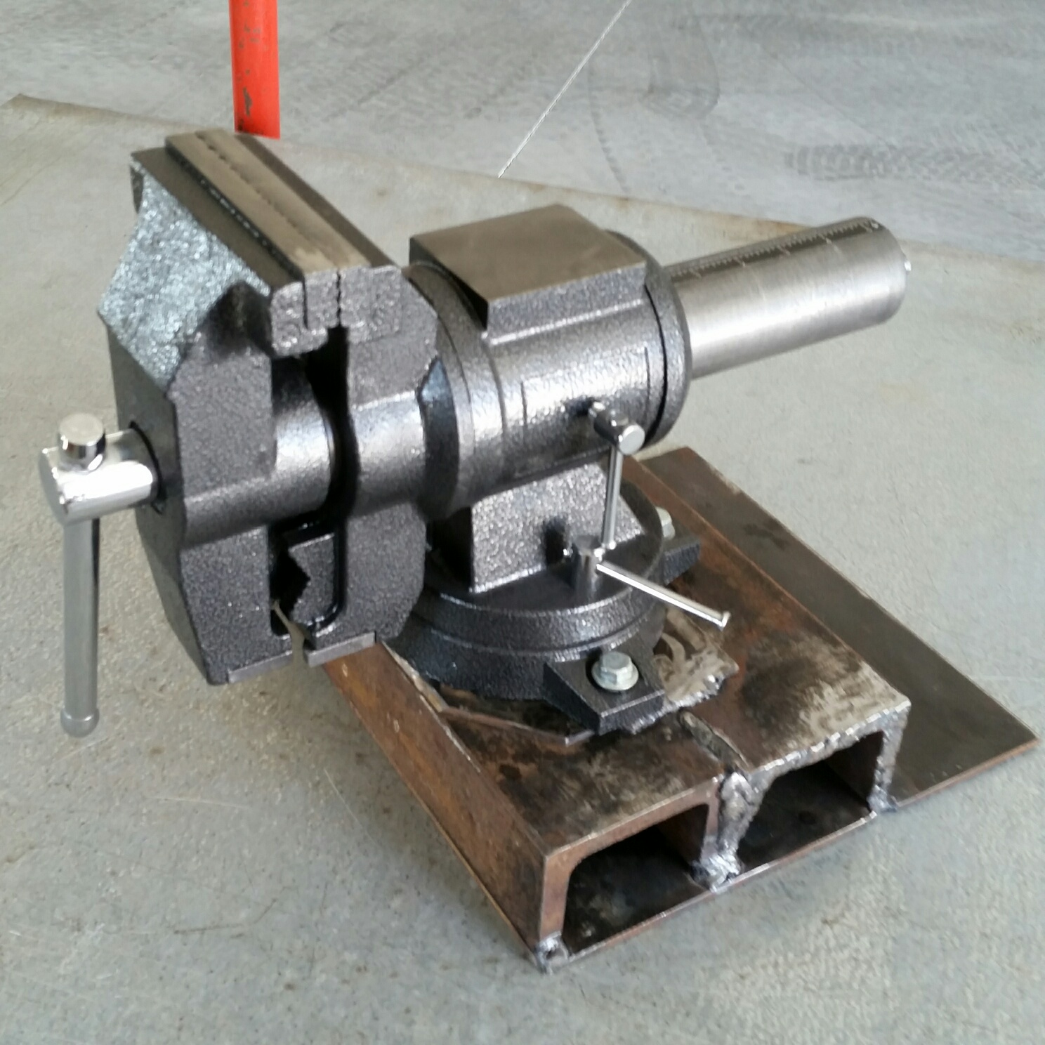

I didn't want my vice bolted anywhere on the table, so I made it portable. I have another vice bolted to the tool bench which is 42" away.

Would not bolt the vise, again losing the flat surface. Could make a few vertical receivers in the table top to take a vise mount.
By vertical do you mean cut a 2x2 hole in the 3/8 top and weld and brace the receiver vertically under the table top?

My table is 3' wide and about 7' long. So far I haven't had an issue with the vise yet. I use it a lot to hold pieces together if I can't clamp them onto the table. I can weld things in the vise because I just ground the whole table. I decided that this is one of those projects that is continuously evolving, so I like seeing ideas from others. I wouldn't recommend putting any tools underneath like I originally did, they just get too dirty from grinding or rust repair. I use the shelf to put pieces I have already worked on or am going to fix.
Thanks!
Yes. That way you could pot other things in there later on also
