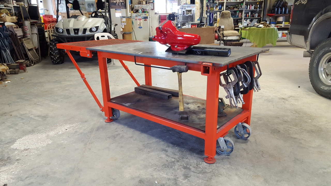

/ Building a Shop / Weld Table #22
Here's mine in it's work clothes.

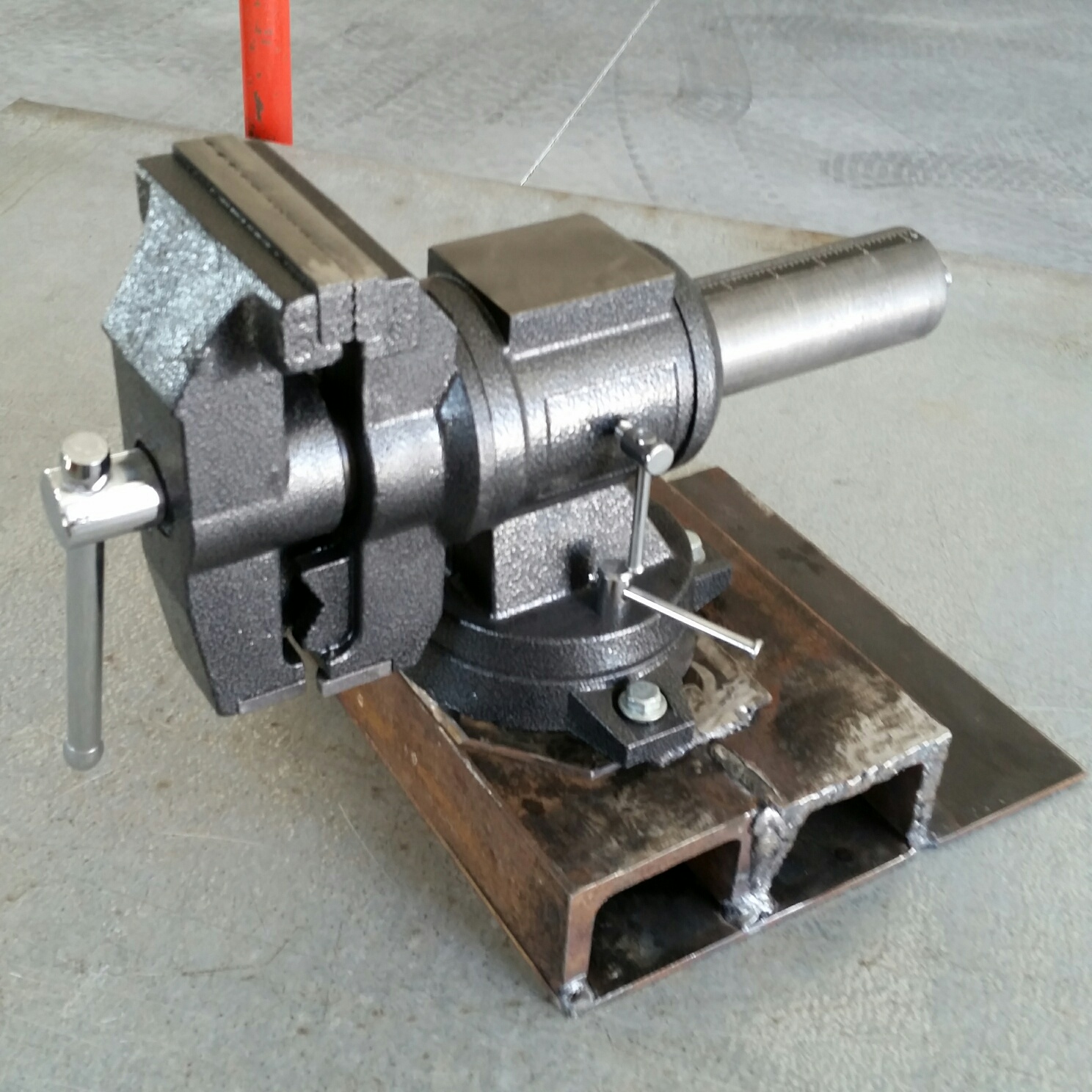

Went to one of our local metal supply place (Wheeler Metal) this afternoon. I asked about what they suggested for the receiver style mounting hardware. Using their sample board it looks like a 2 x 2 x 3/16 square tube fits nicely inside a 2-1/2 x 2-1/2 x 3/16. I know a standard receiver has a collar around the front end - do I need that collar?

The collar won't do much for your application. Instead of a pin I would weld on a 1/2" nut so you can tighten it. The pin will allow it to wobble.

Richard is that a wilton vise I have one from 1940 or so I would have to take it apart to read the date again
Yes. Love these old Wilton vises. I lost one in a shop fire few years ago. Was lucky to find another one. So easy to use and extremely dependable. If you look closely you can see I've bent the handle on this one. I use it hard. :)

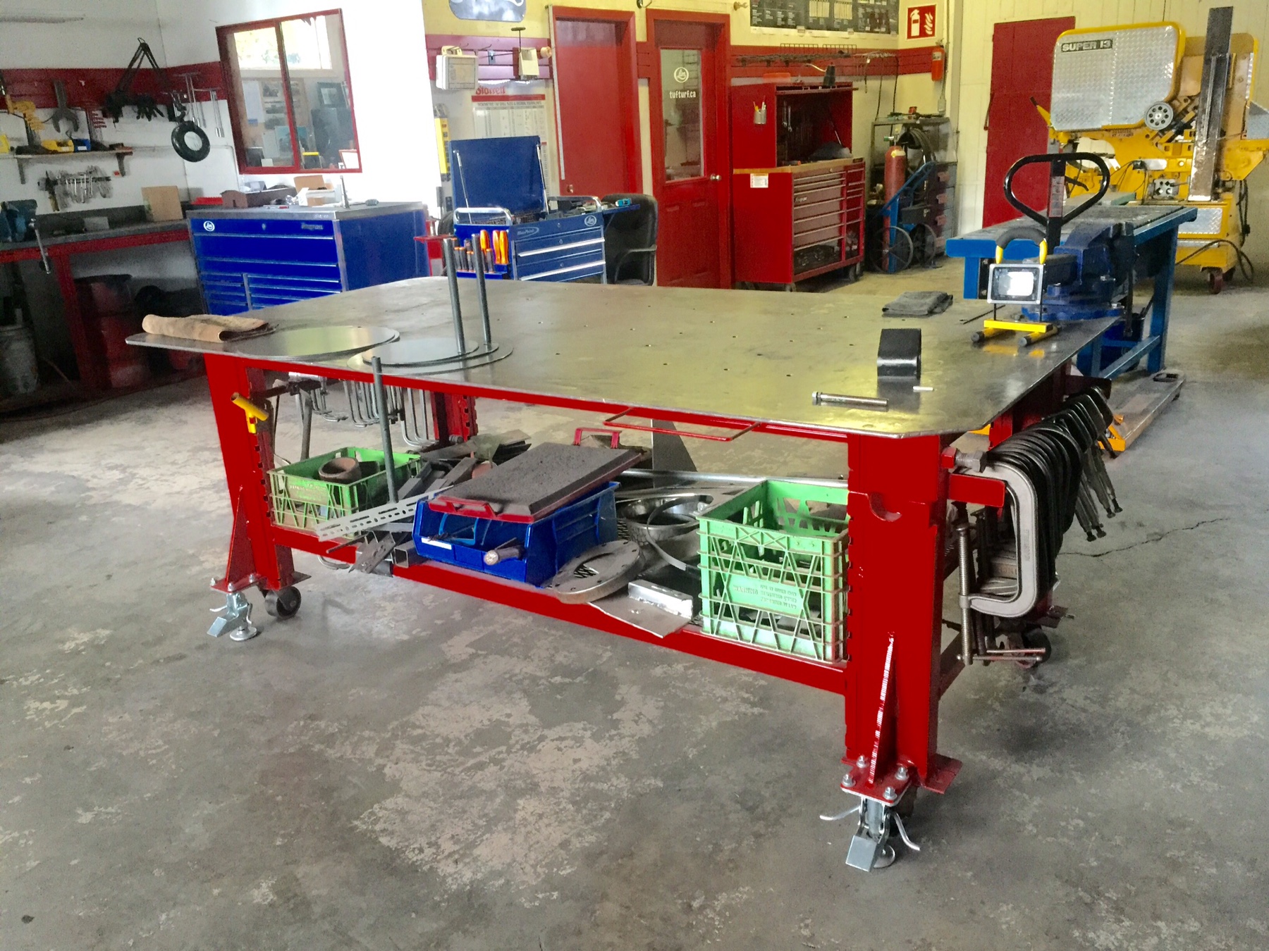

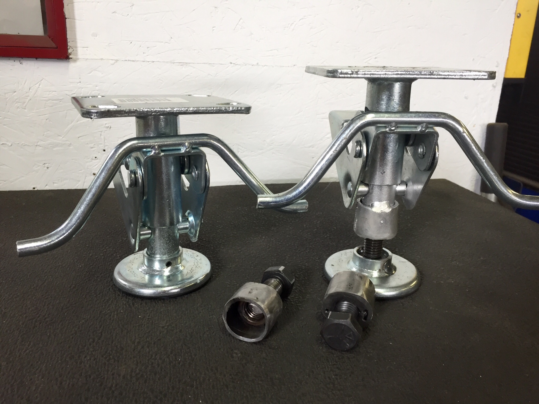

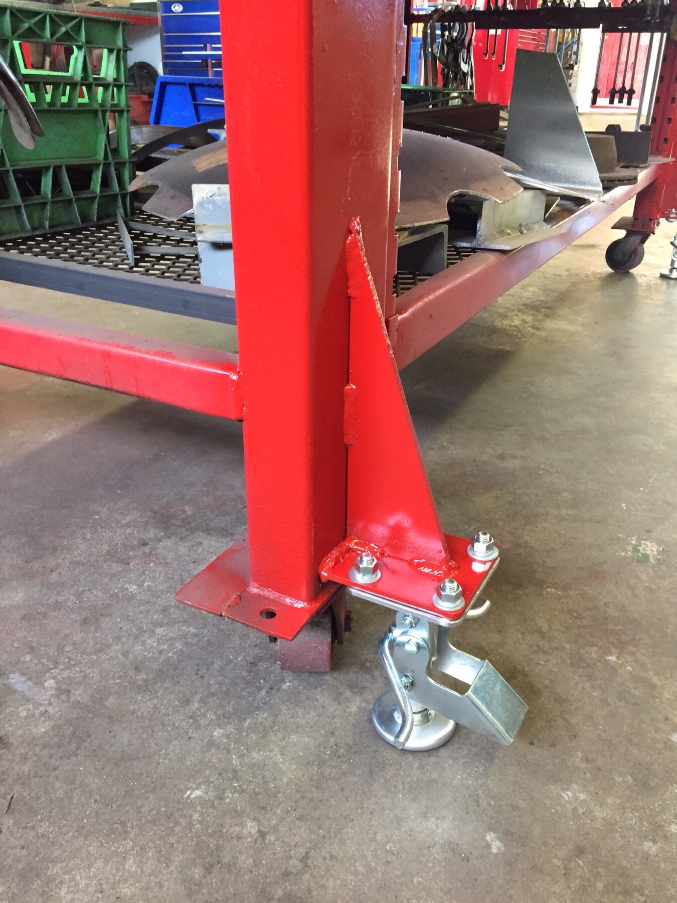

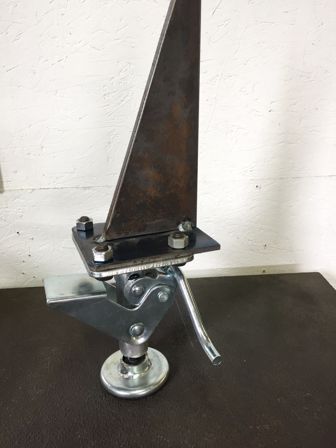

I modified some inexpensive floor locks to make them adjustable and welded one on each corner of my steel castered weld table.
Photo above: Left floor lock OEM. Right one Big Barnerized.
Not only can the table be locked in place, but it's now quick and easy to fine tune for levelling.
View attachment 542216View attachment 542217
I'm pretty sure I'm stealing that idea :) Even if I don't make them adjustable that is a great way to mount them!
/ Building a Shop / Weld Table #34
Me too, I like that idea. Much easier than what I was going to do with threaded rod.

Have a closer look at my photos. Stepping down on the pedal raises the table so that the casters clear the ground and the table is stabilized and level. Using your foot to push down on either of the "winged" rods on either side retracts the(spring loaded) locks and the casters are in contact with the floor once again.
The only mod I did was to make them adjustable for levelling.
I know it's not EXACTLY what you had in mind but adjusting the table to be perfectly level makes some projects way easier to set up for welding.
