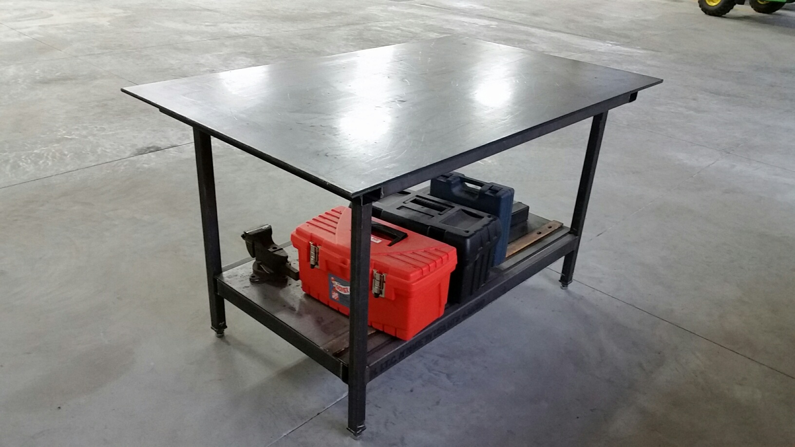

The top on my table is 36x48 and the casters are 28" CTC, and it's 37" high. I did a mockup first with longer legs and shortened it to a comfortable-for-me 37". Quality of life has improved greatly with completion of the table. I've often complained that although I love working on projects, till now the welding was done on sawhorses with a piece of plywood or while crawling around on the blacktop.
It is easy to roll in and out of the garage, and there's about a 1" difference between the concrete and the blacktop. It isn't tippy at all, but it only rolls on the long dimension. I threw a 6' scraper blade on it for repairs and rotated the vise so the blade could rest on the table and stay upright. A project last week involved clamping a 5' piece of 4x6x3/8 galvanized angle in the vise.
The floor jacks are inboard of the casters. I used fixed casters on one end and swivel on the other. The table is easily maneuvered and with the floor jacks on the end with the swivel casters it stays put when I set the jacks. I figured if there were swivels on all four, the table would move sideways on the one end unless there were four jacks

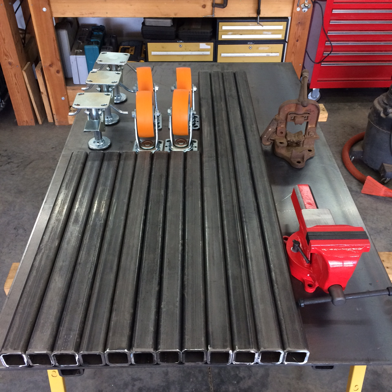

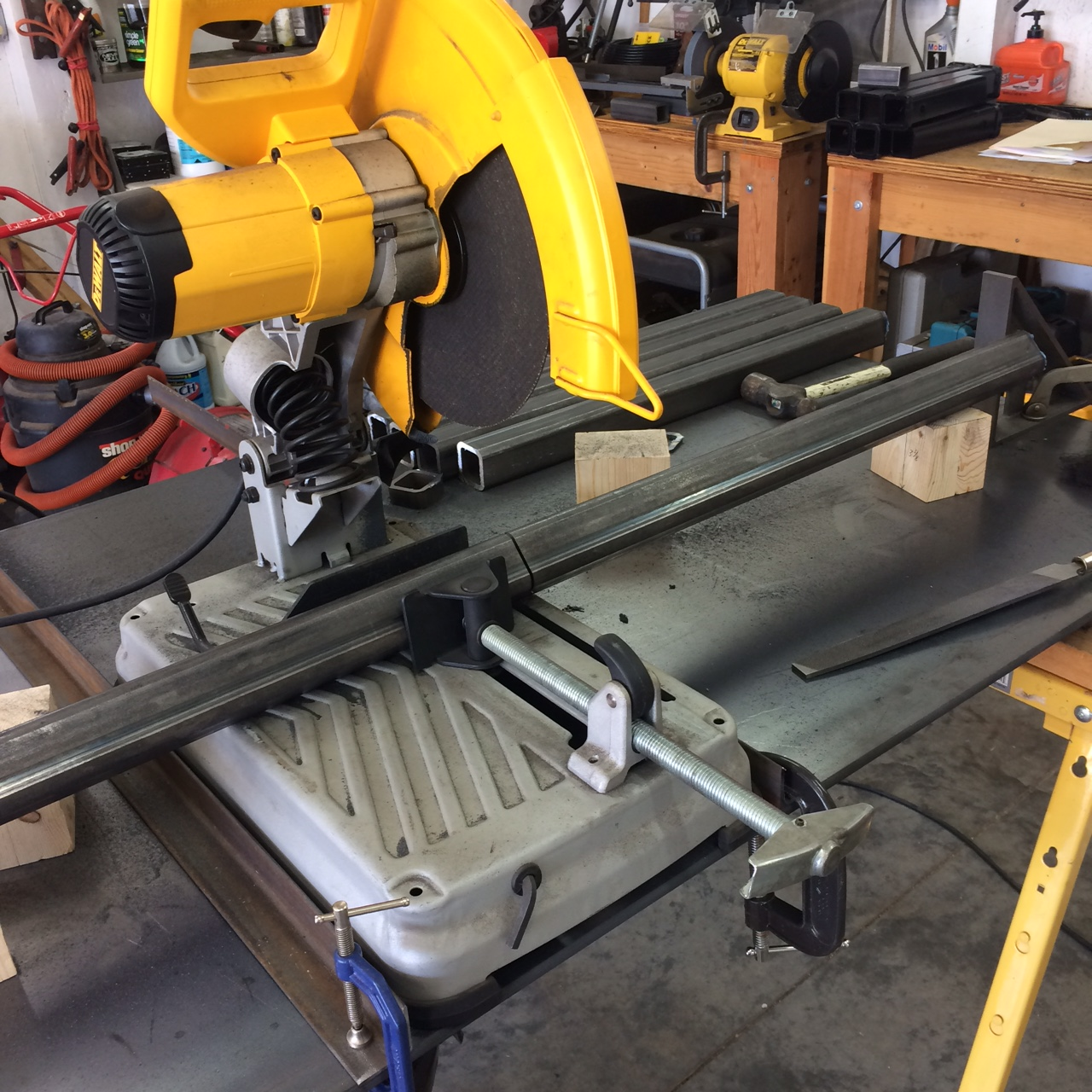

I started cutting pieces for the frame this weekend. I cut the eight pieces I need to make the ends (short side) of the bench and the four long pieces that form the long sides. Cleaned up the ends where the abrasive saw cut them. I have the top plate on a couple saw horses with a couple 2" cross pieces under it for support. Oddly, did not plan it, but the saw horse rig is within 1/2" of the height I want the final table height to be. I like the 36" height.
I made a cutting station to cut the 8 pieces for the ends. Clamped a square to the table top and clamped the cut off saw to the table saw too - I was able to cut the 8 pieces exactly the same length. Just measure from the square to the right side of the blade.
I pretty much have everything I need now. I have the vise (Yost Vises FSV-5), floor locks, receiver tube and casters. I have a couple small projects to finish up, grapple dolly and a small shelf, but I should start welding in a couple days. This will make life a lot easier!

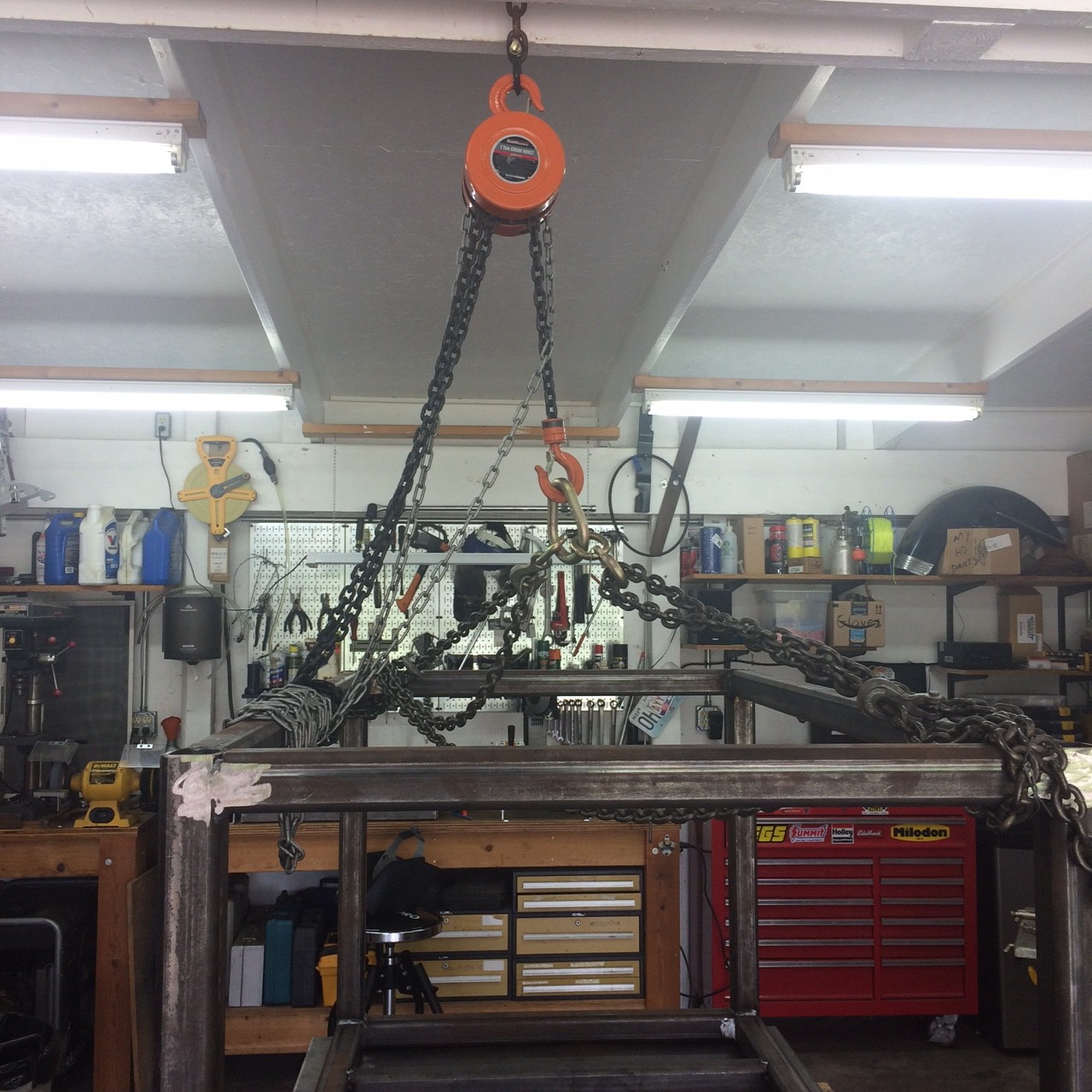

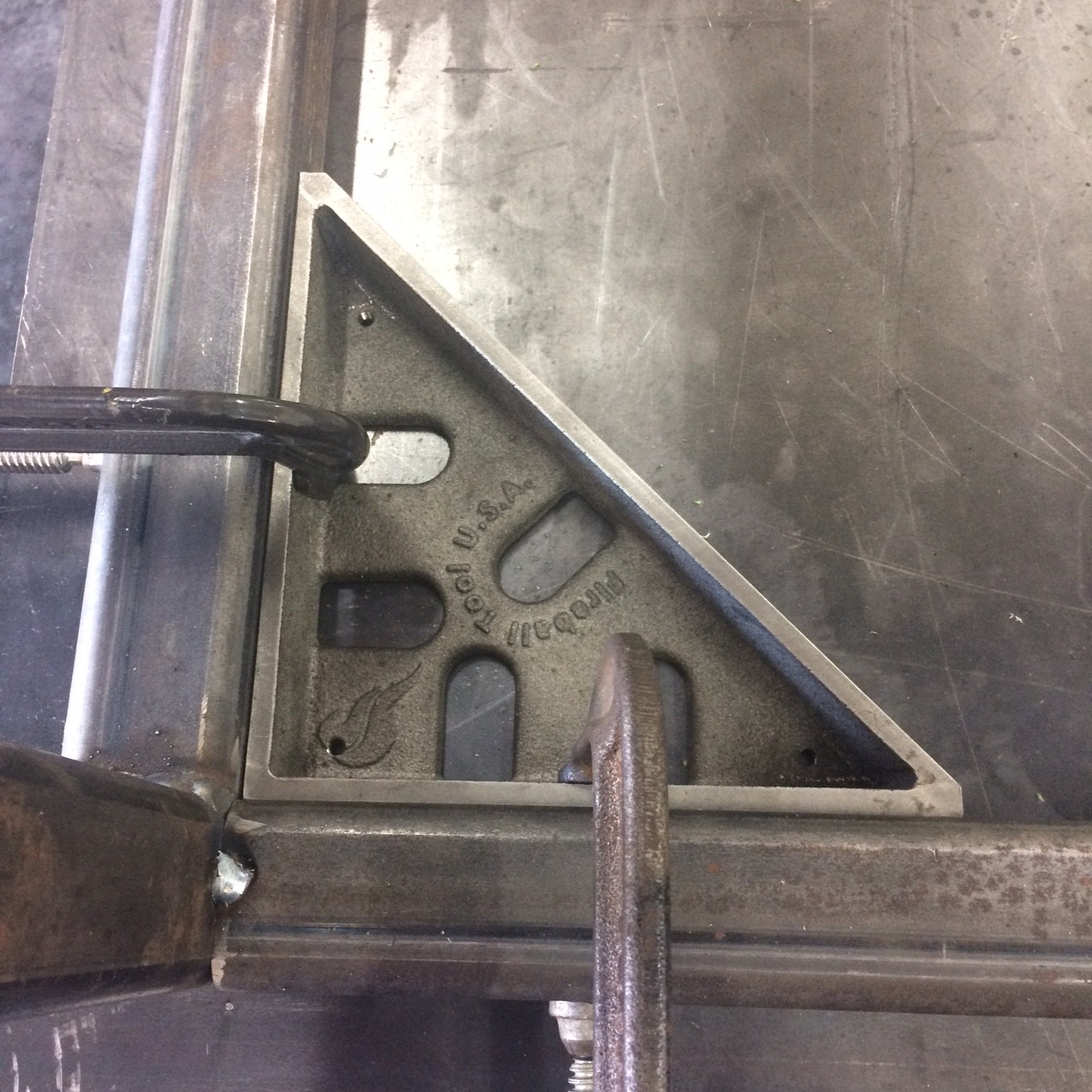

I admit it, I have an addiction... tools. I bought one of the fireball tool mini squares. Made clamping up corners easy. The more weight I added to the table, the more the saw horses would sway when you bumped it the hoist is my safety net.
