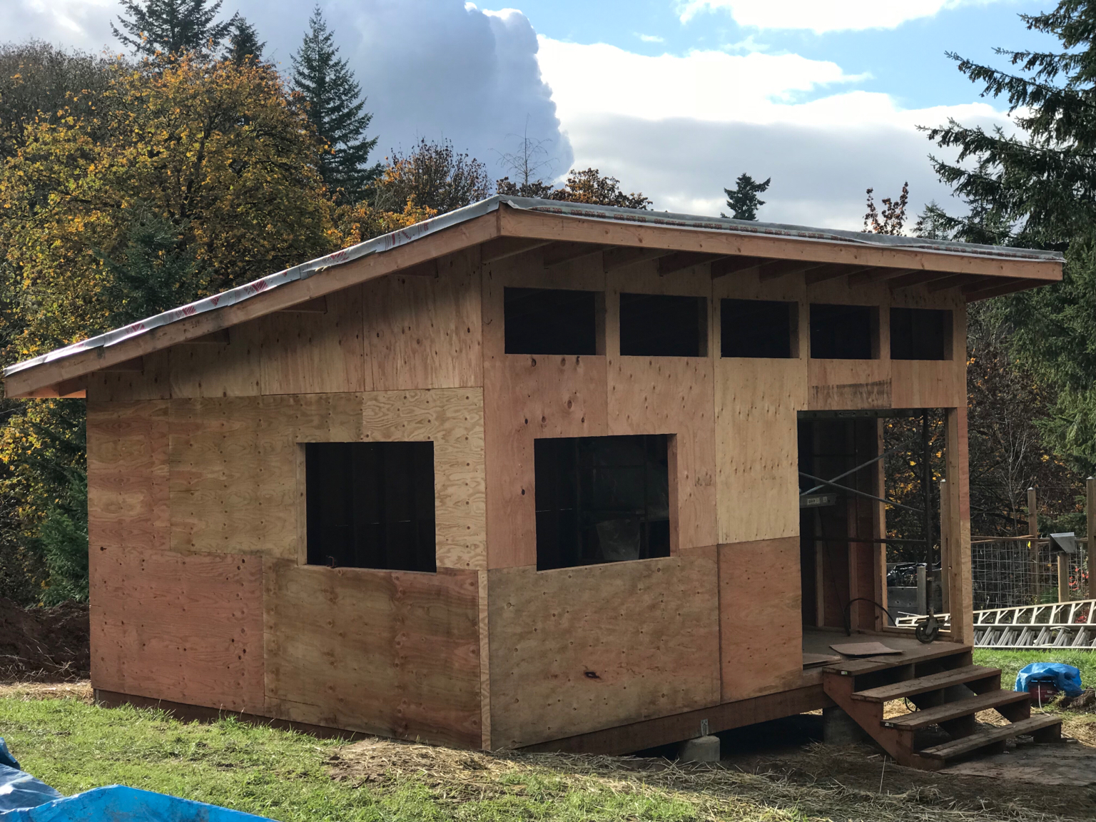

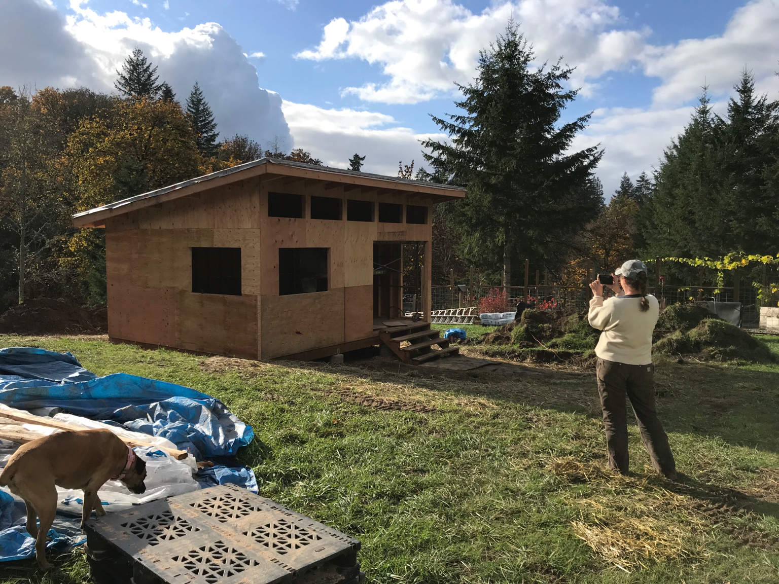

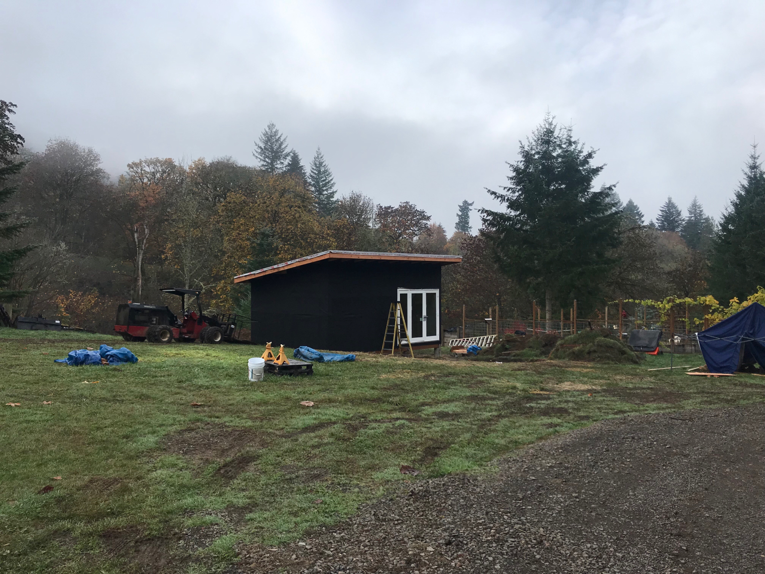

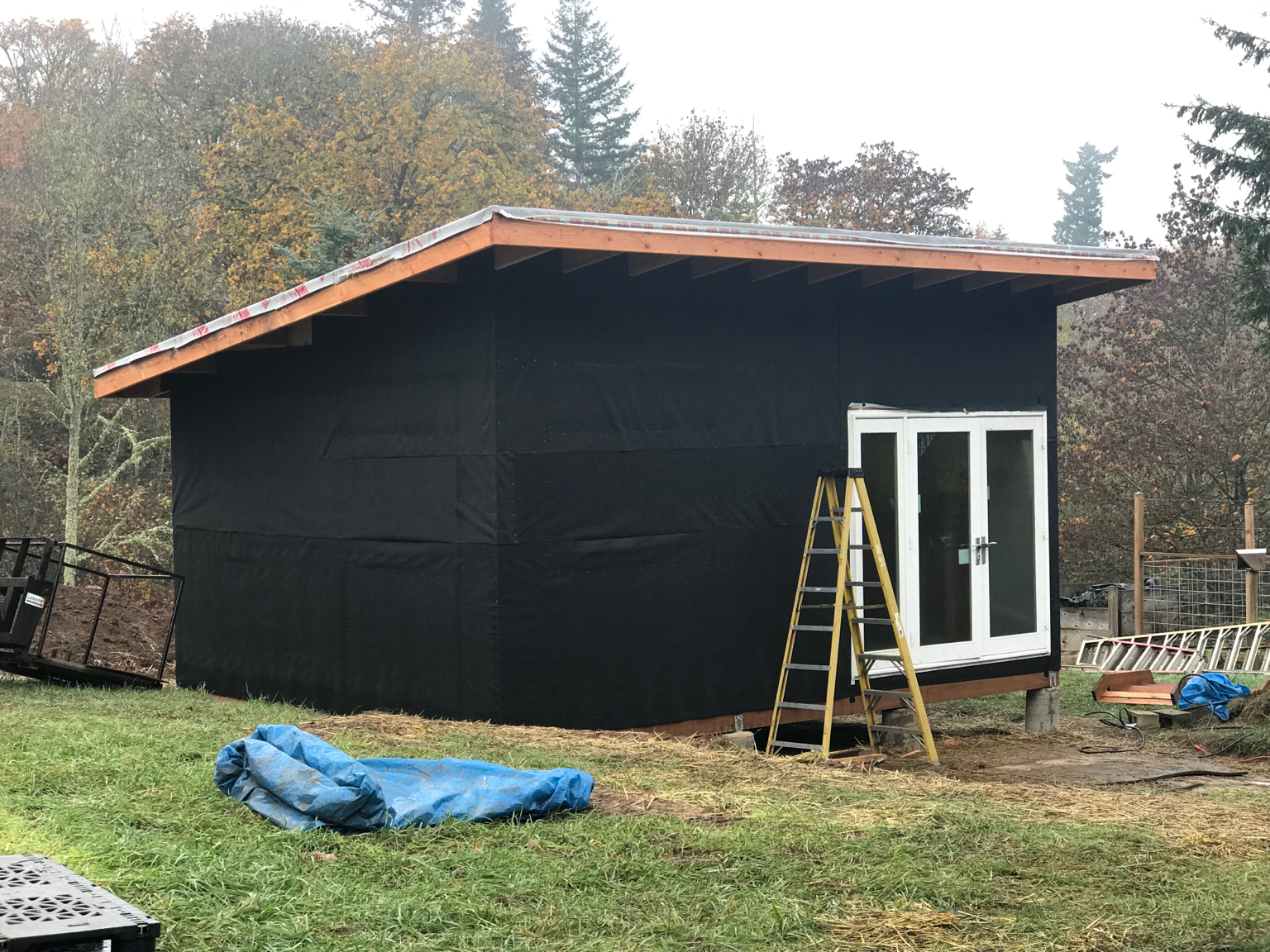

Thought i would throw this up. Sheathing is done as well as a very custom house wrap. We lost the light so no pictures of this house wrap. IMG_6563.JPGIMG_6567.JPG

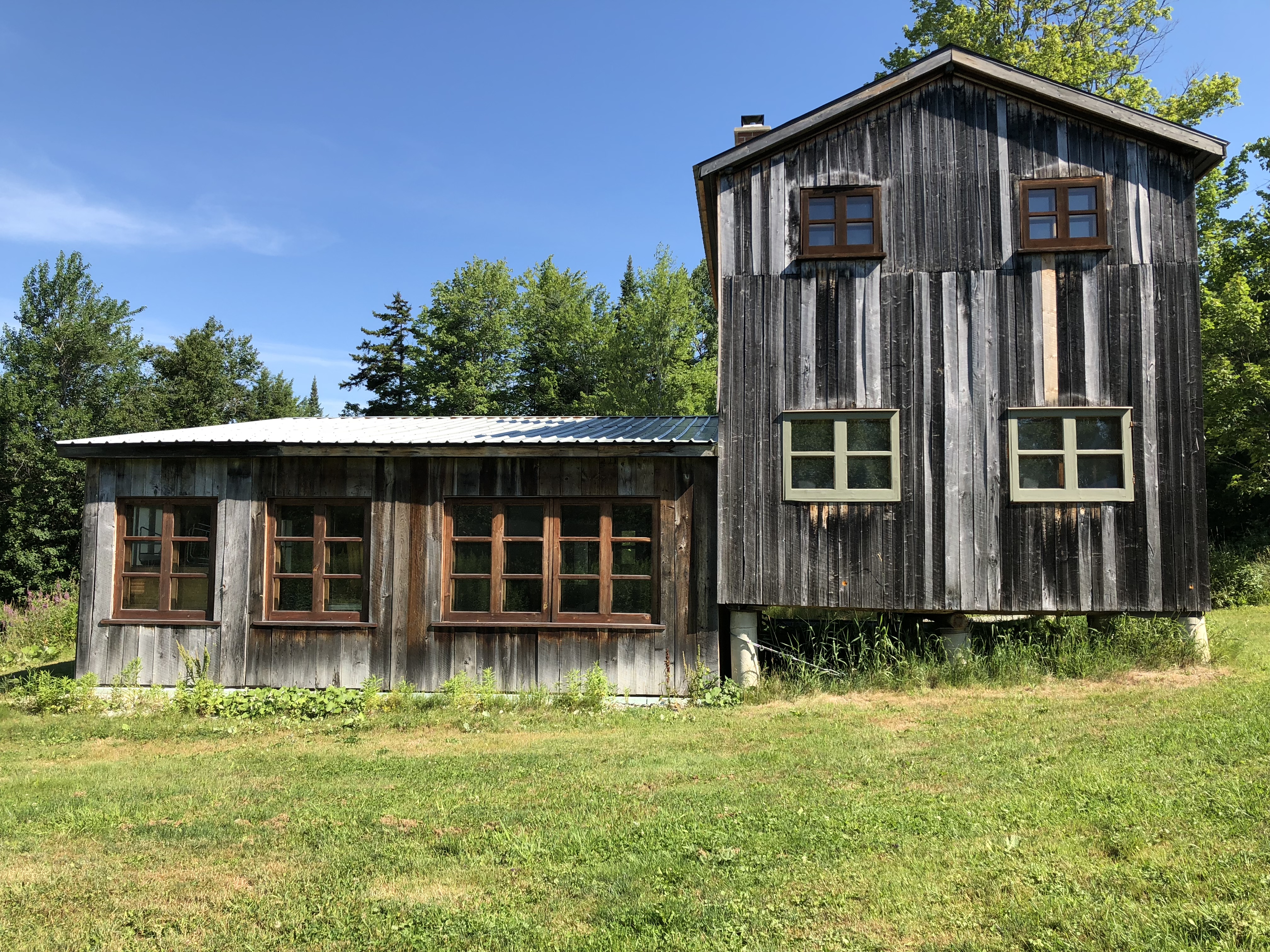

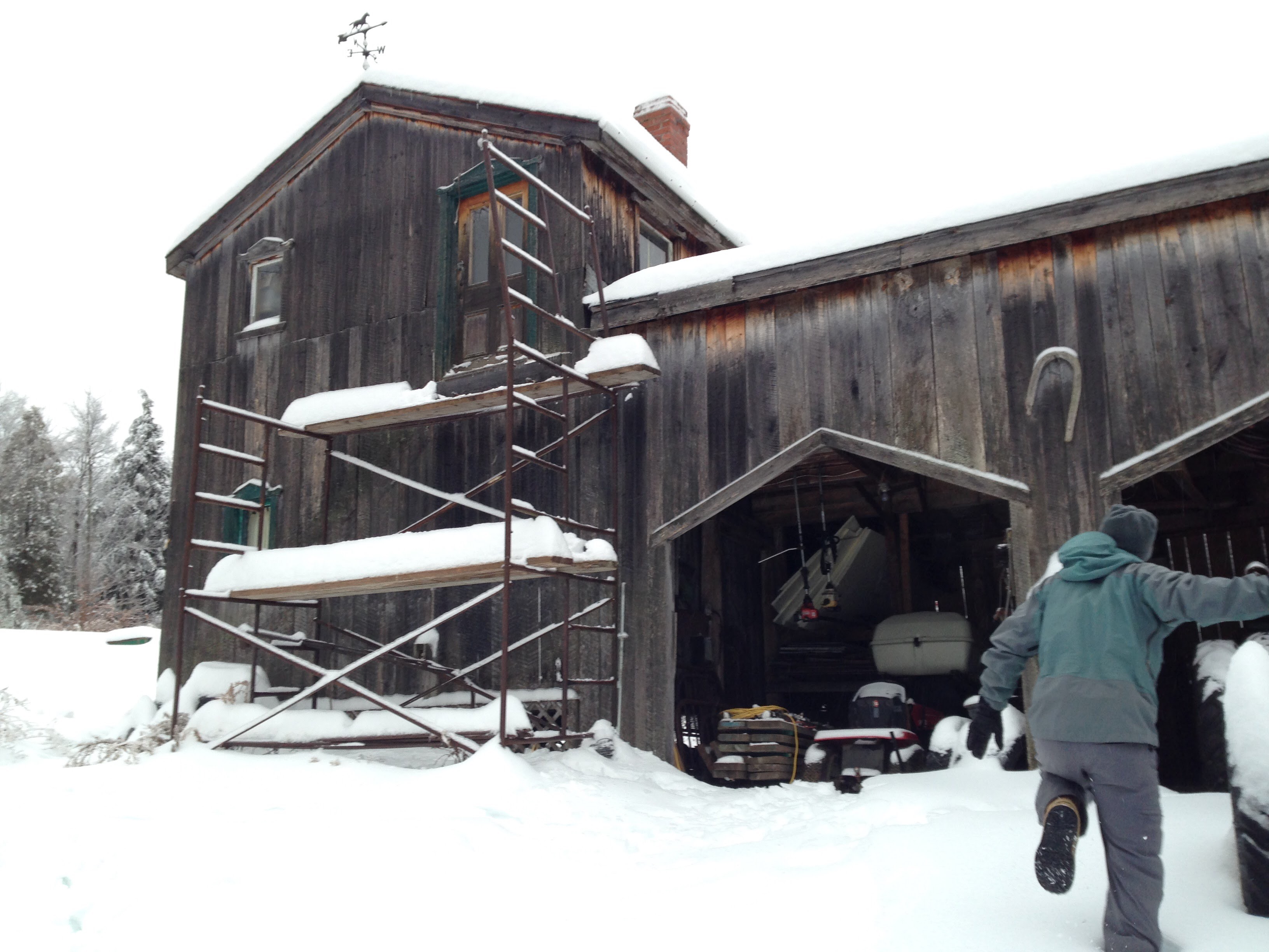

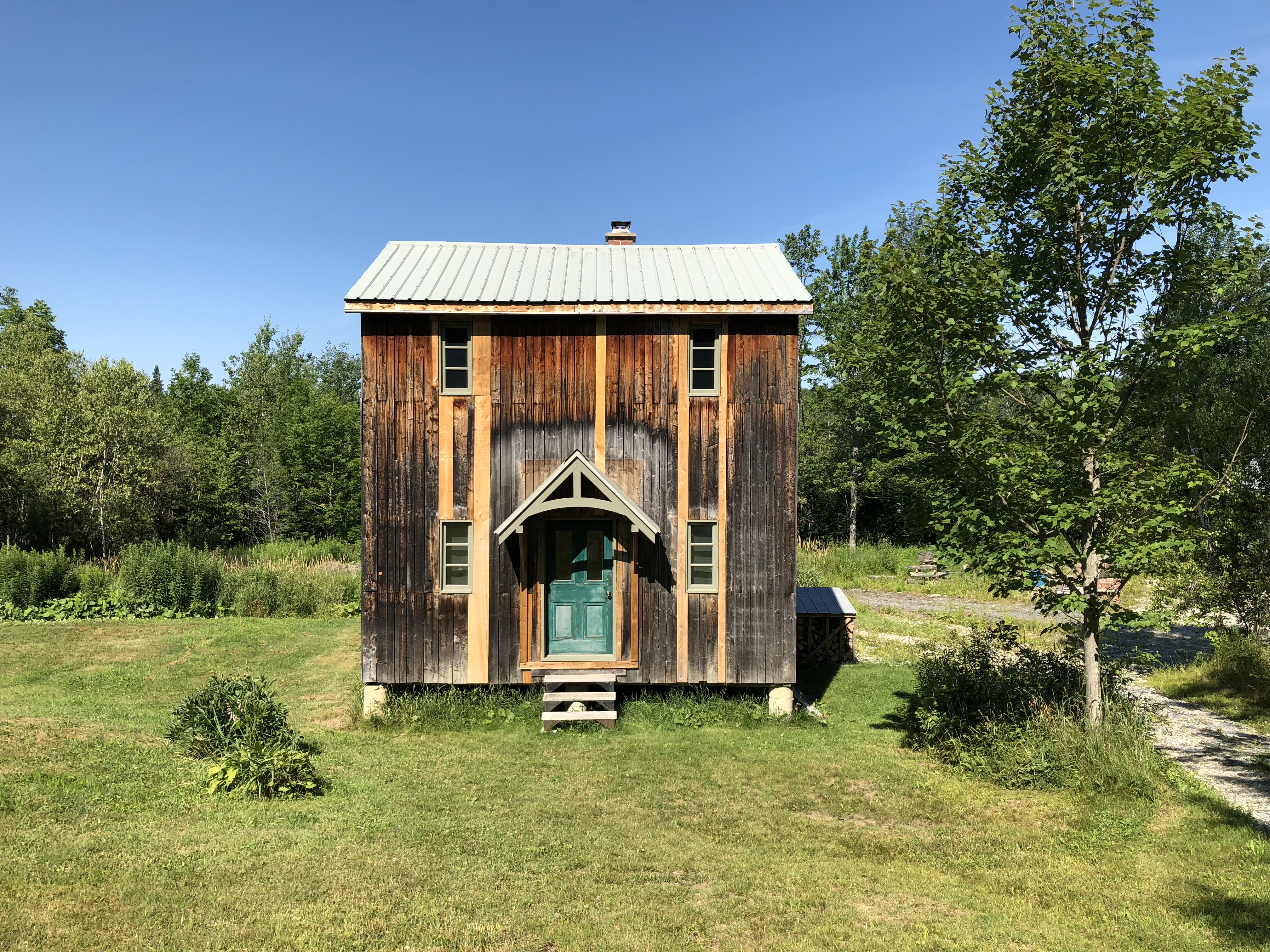

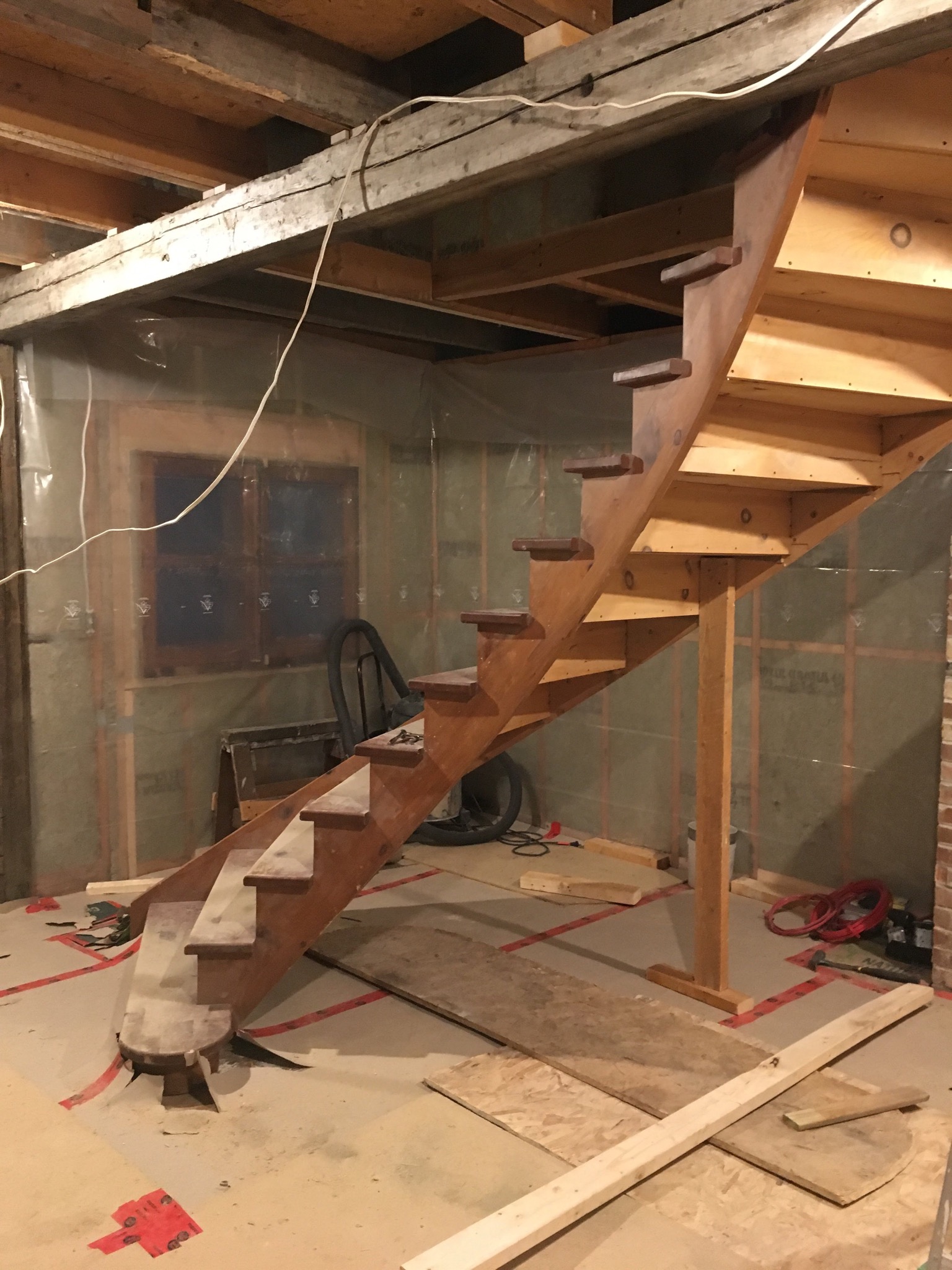

My wife also want to have her own workshop/hobby shop/tool house! It痴 a hard long project, she is mediculous on every aspect. It痴 a multi year never ending project. But it痴 slowly coming. I have use an old shop and incoporate the old tractor garage together. Using existing building add time and complexity!
This what it was in 2013 when we had just bought our property, and how it look now.
