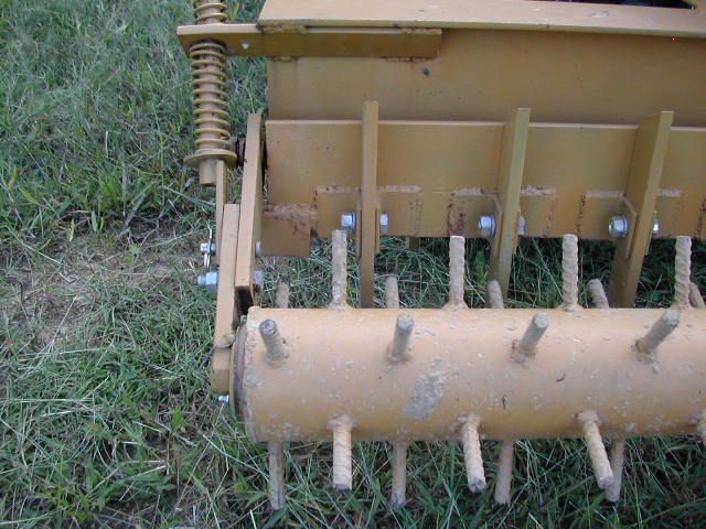

Finally some pictures of what my homebuilt pulverizer can do. My camera did do too well today so bear with me. This one was taken from the seat.

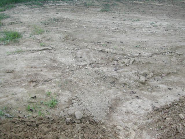

Here is a shot of a rough area of ground before I went over it. This area is hard clay that has had all of the top soil removed from it.
/ Building a Pulverizer
#33
Re: Building a Pulverizer, Painted Version
This is what the same area looks like after 2 passes with the pulverizer.
#34
This pic shows what difference after running the pulverizer over part of the area.

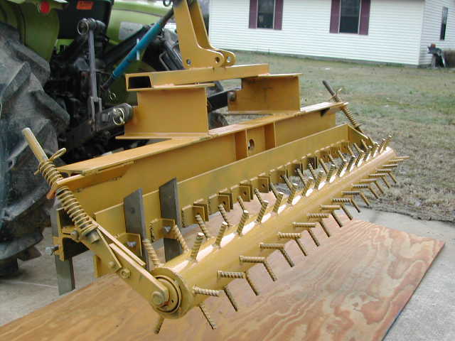

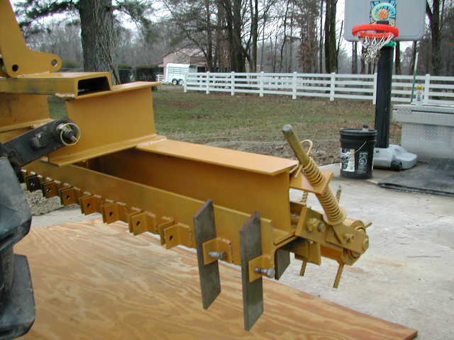

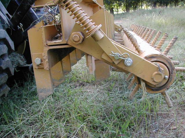

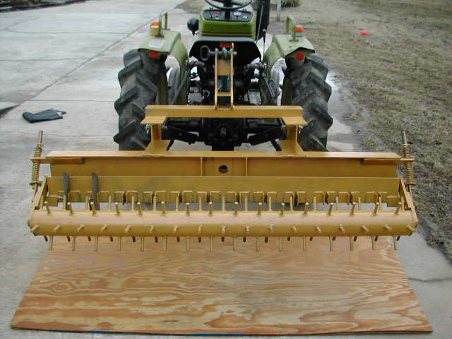

I forgot to take my tape measure with me this afternoon. Maybe I can take some measurements tomorrow. The spikes are welded only, no drilling. Here are a few detailed pictures. Here is the roller assembly and how it attaches. I feel that the bearings are the weakest link on this project so I set it up to be easily swapped out at a later date when I find something else.
#37
From the rear.
