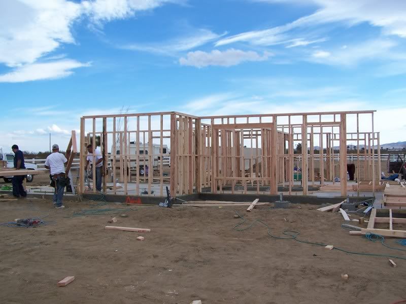

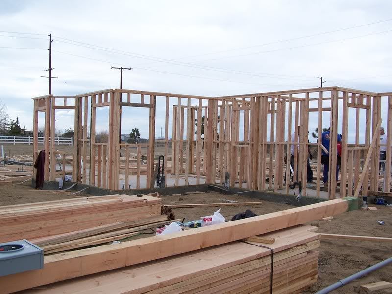

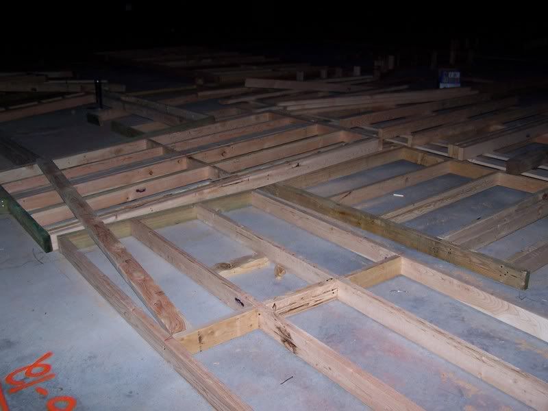

Why the fireblocking inside or outside for that matter? Did your plans call for that?
Rat,
I saw that too. Not sure if I've ever seen that on interior walls before, and never on every interior wall in a house. I wonder if that's why his friend needed extra nails?
Did you notice they also used Preasure Treated Sill Plates on the interior walls? It's common on a bathroom, but why use it on all the other walls? I sure hope they used ICQ nails. Same thing with mixing the PT wood with the untreated wood in the box on the wall with the arches.
Eddie
/ building a new house
#100
That was all the wood I had left he made do with what I had
