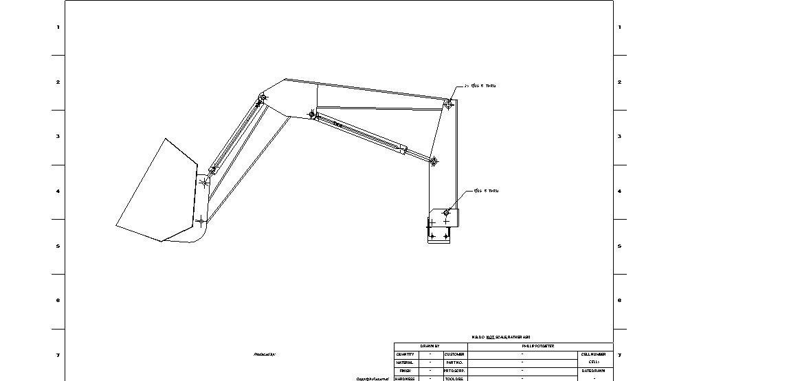

Got this far. any help if I am on the right track.or have I missed the train.

Your title block is blank 😛
What are you drawing in?
And is the lower mount for the lift cylinder low enough?

Looking good. Is it going be "fixed" on the tractor or are you able to take it out quickly if needed?
Also, while it's a little bit more work, I would suggest you would go with the H linkage for the bucket. It will give you more curl back but also more dump.

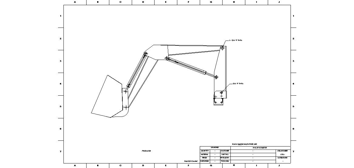

Alibre Design. You are correct,I have lowered the Lift Mount.It function much better now.It would be most helpful if someone with a loader like this could add a few dimension, as I have no sample to work from.
I have search all parts of South Africa, these attachment where not common in this country, and I have been unsuccessful finding even a part there of. To import one is not an option, not with our currant exchange rate.

I would like to ultimately make it quick removable, and yes the H attachment will make it more user friendly for other attachments. That's next.
No but you have missed the bucket quick attach. Once you have that, you hardly take the loader off, just drop the bucket off to gain manoeverability.
And once the quick attach is on the loader, you will start fabricating pallet forks, jibs, brush forks and what not, for it.
