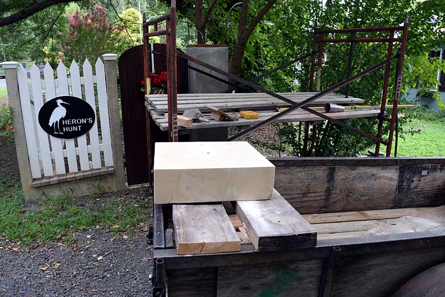

Operation cap stone. Tennessee lime stones for pillars: 20"x20"x6" - it comes to about 200 pounds. I bought them as Christmas present for my wife, she loves stones.
So far so good - but we shall see what my back will have to say tomorrow.:D

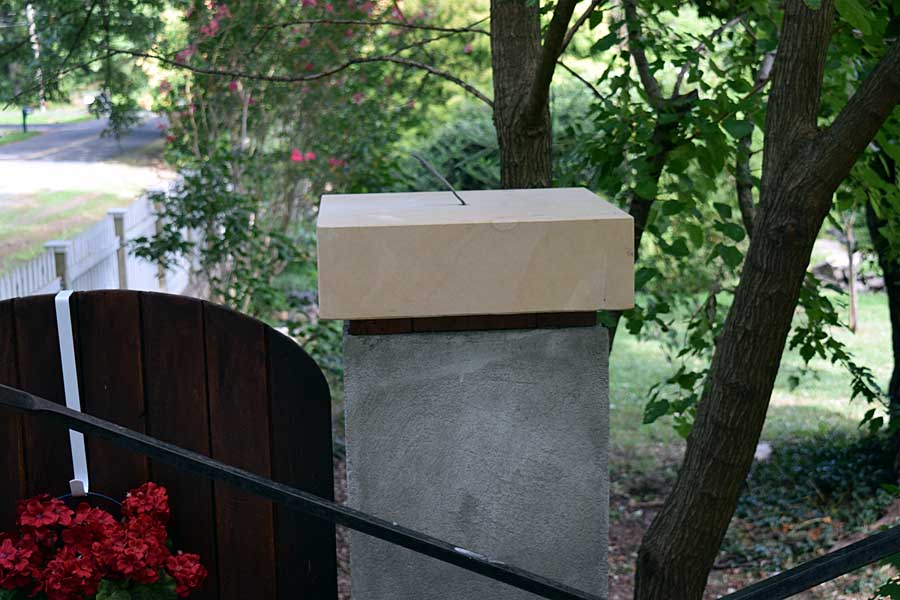

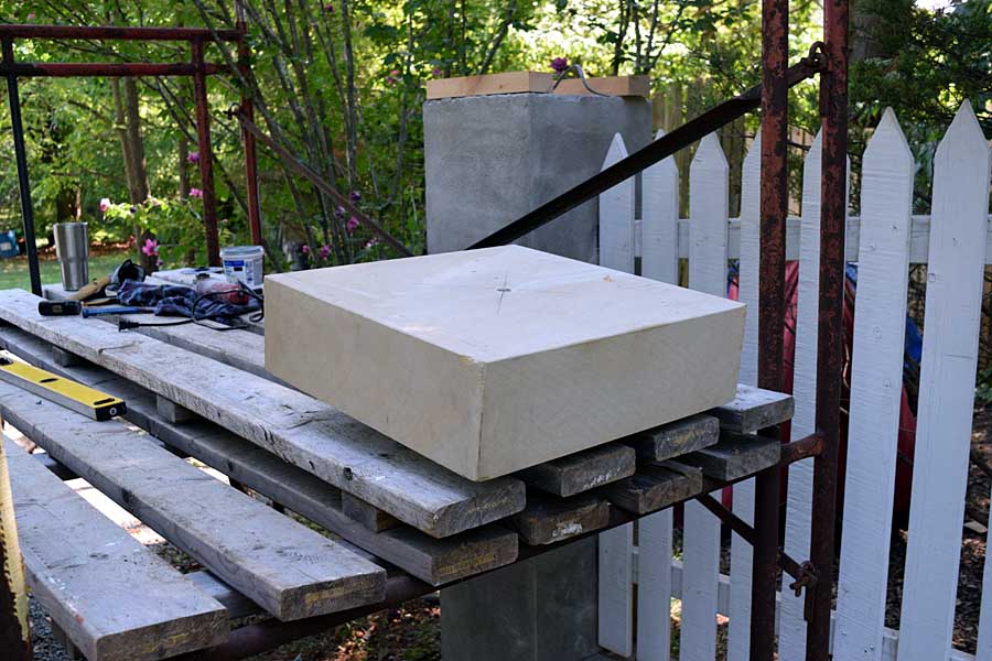

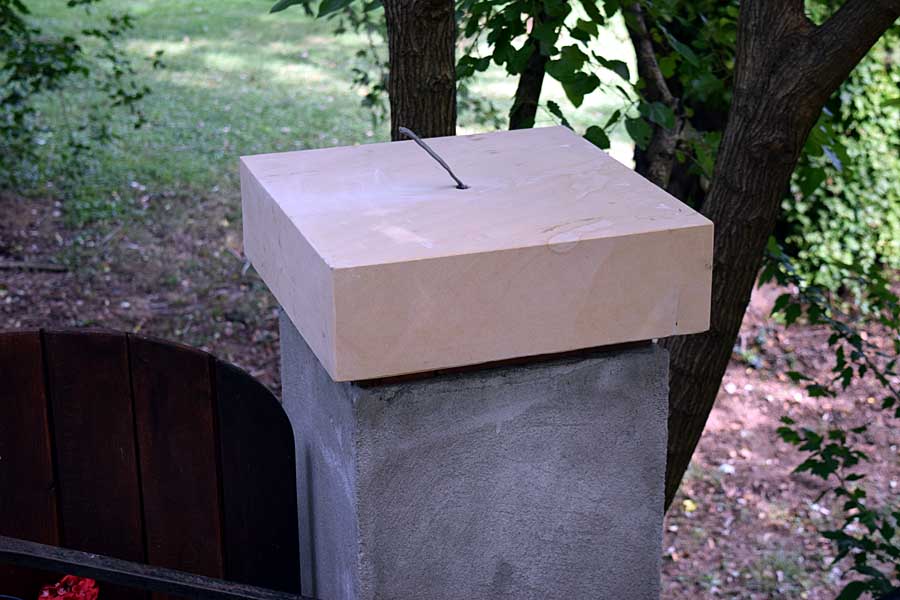

Two days later, the second cap stone is up. It takes four steps to get it six feet high.
I used water level and found out one column is shorter 1.5". I used thin bricks to build it up and I will just stucco over it.

How did you lift the stone from one level to the next.
Norman
/ Building a fence #66
That really looks nice on top of your columns!!

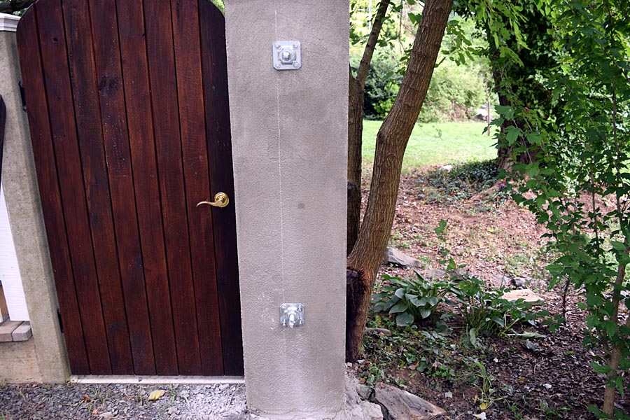

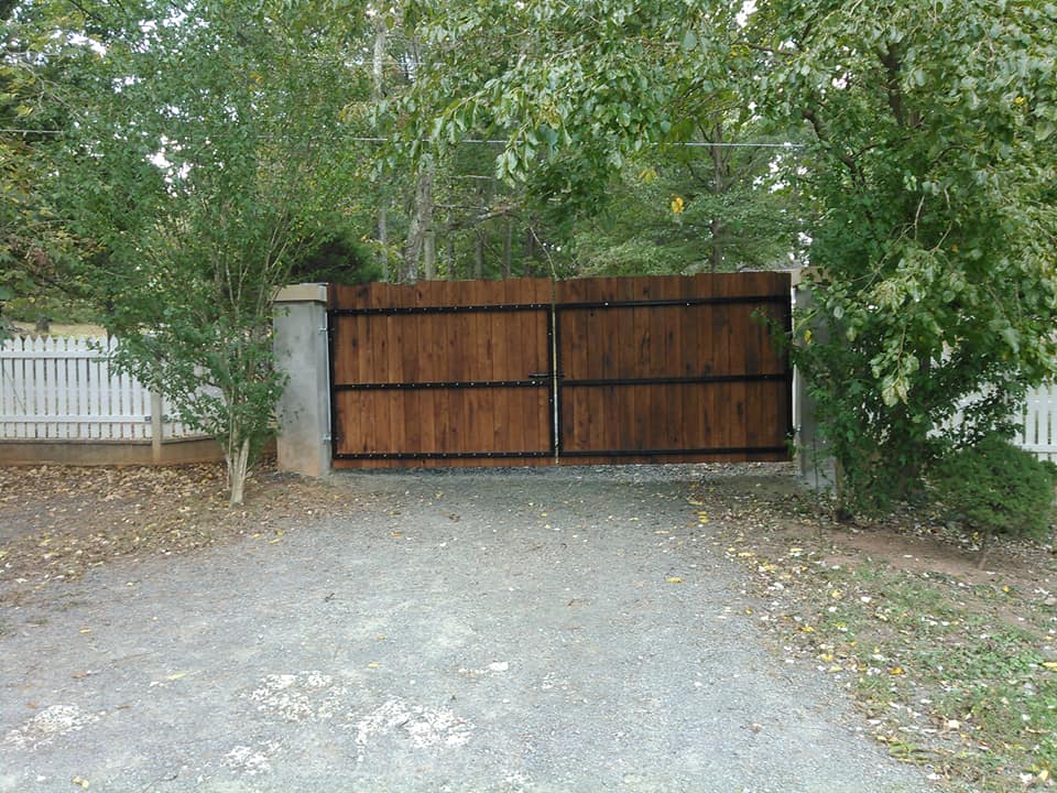

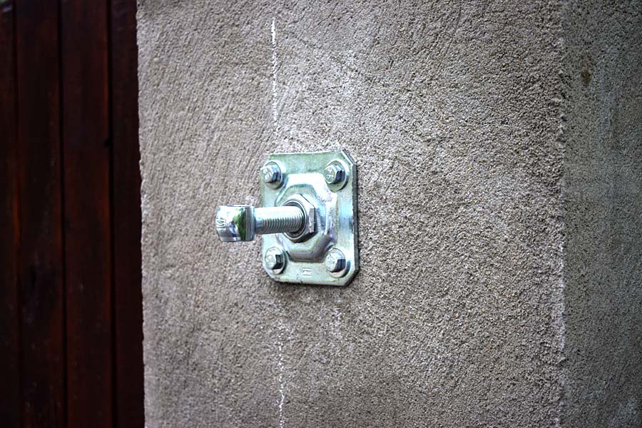

Making progress. Slowly. I bought these hinges in Czech, but they are Made In Italy. Adjustable as needed. It was needed :)

/ Building a fence #69
Gates look perfectly aligned. Will you add a diagonal brace across each gate to keep them square?
That was the plan, just a 3/8" rod going corner to corner with a tensioner in the middle, but I decided I need to fasten boards in three places - I am putting another 2x2" horizontally. It will also keep the frame from sagging. Not as good as triangulation, but it looks better and works too.

Nice work. Looks impressive. Old world impression.
Levers, jacks and blocks are for lifting by the old and frail like myself!

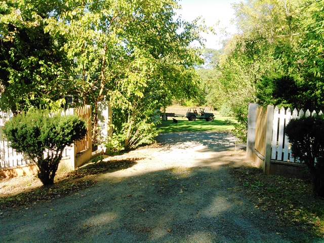

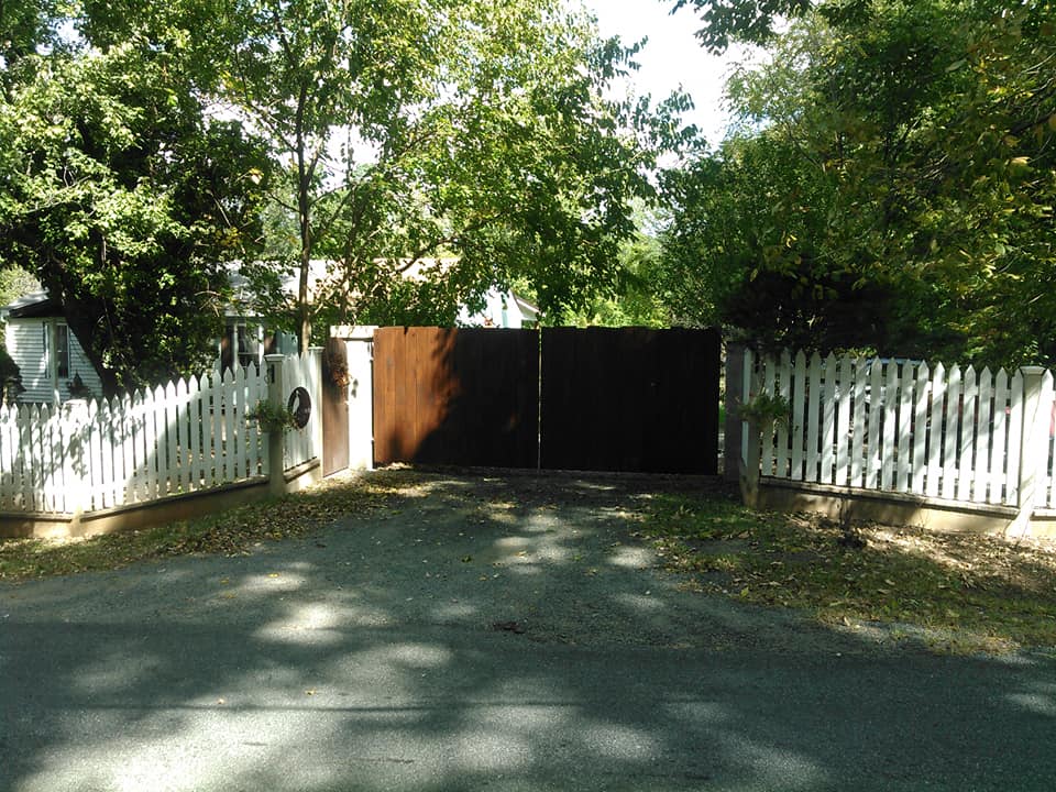

It still needs an overlapping board for the middle and the top cut in half ellipse to match the little gate, but the gate is up and it closes and everything :D :dance1:

#77
Thank you! With my wife we put chairs right behind the gate and shared a bottle of wine :).

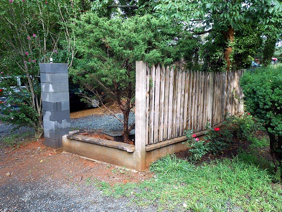

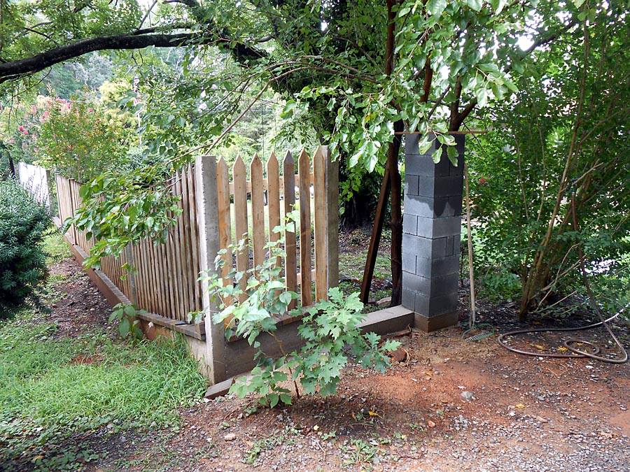

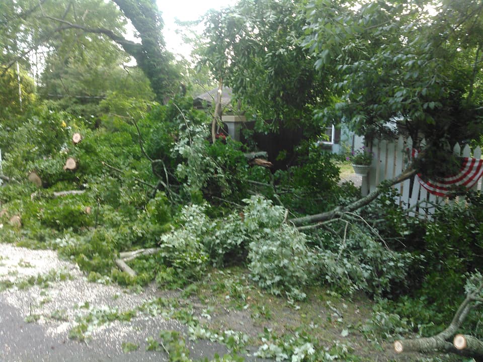

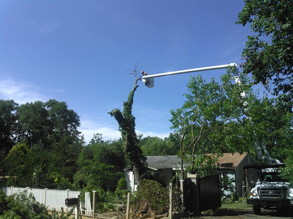

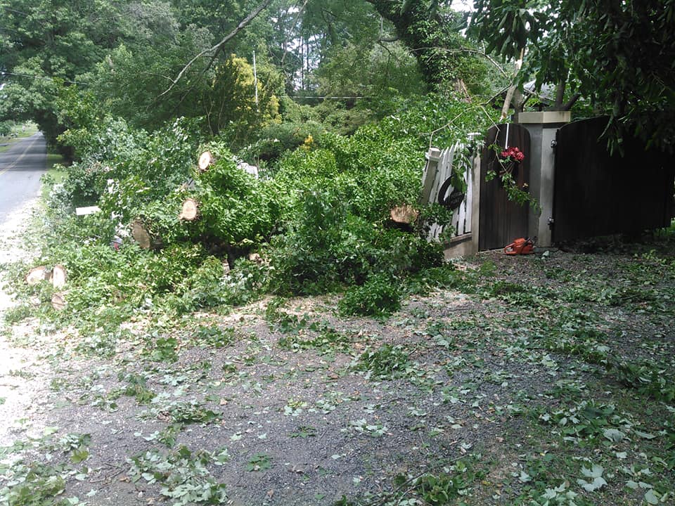

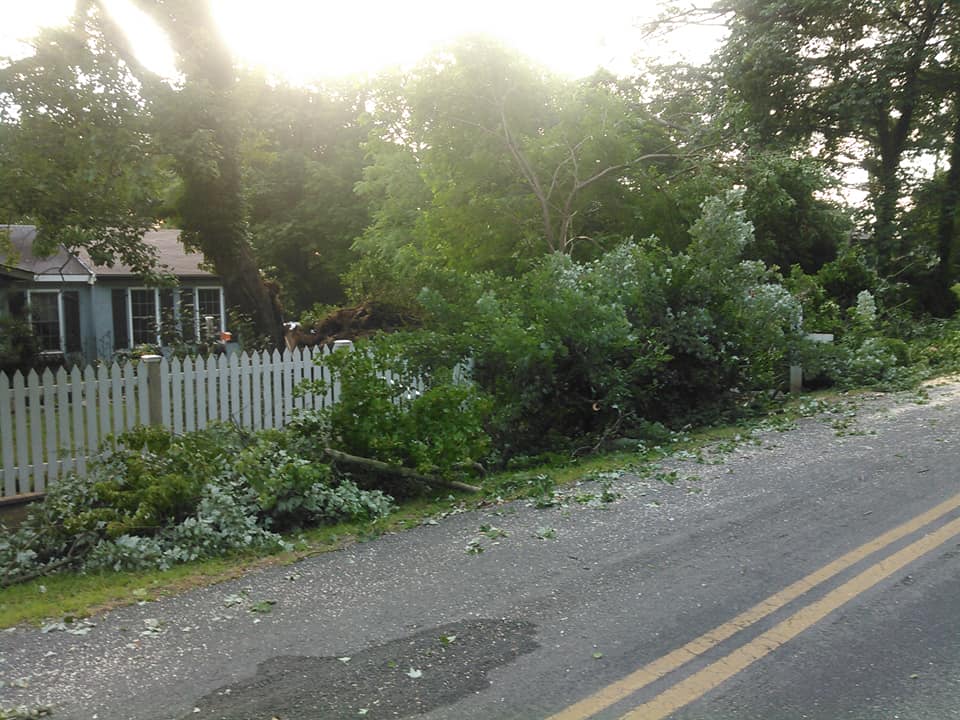

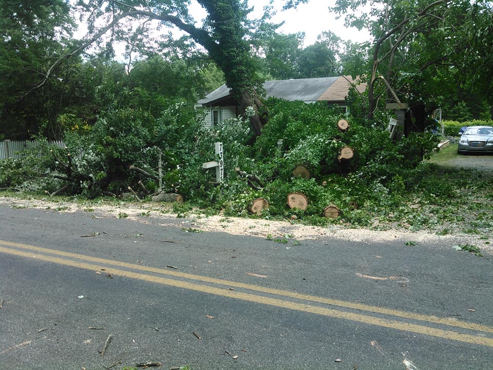

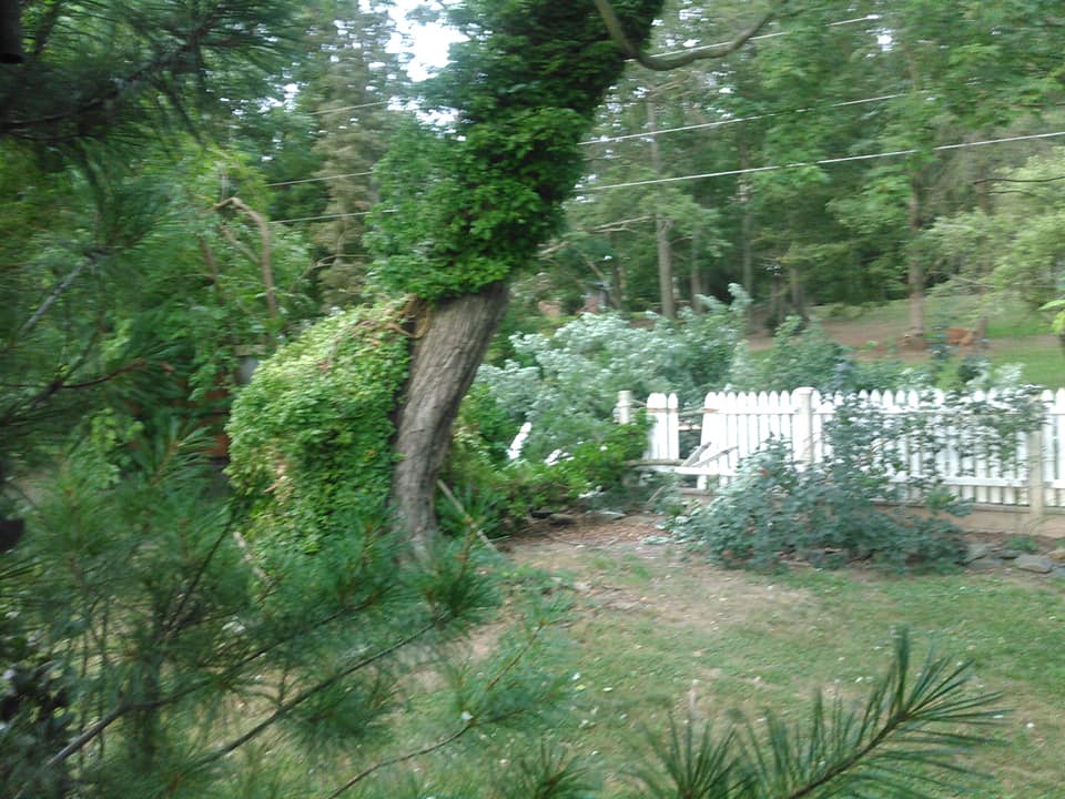

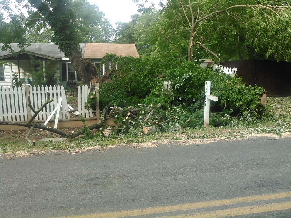

Update:
In July, half of a huge maple came down and broke two fence posts and lot of wood planks. One week later I had the second half removed by a pro.
I am finally done with cleaning up the mess and ready to replace broken fence posts.
