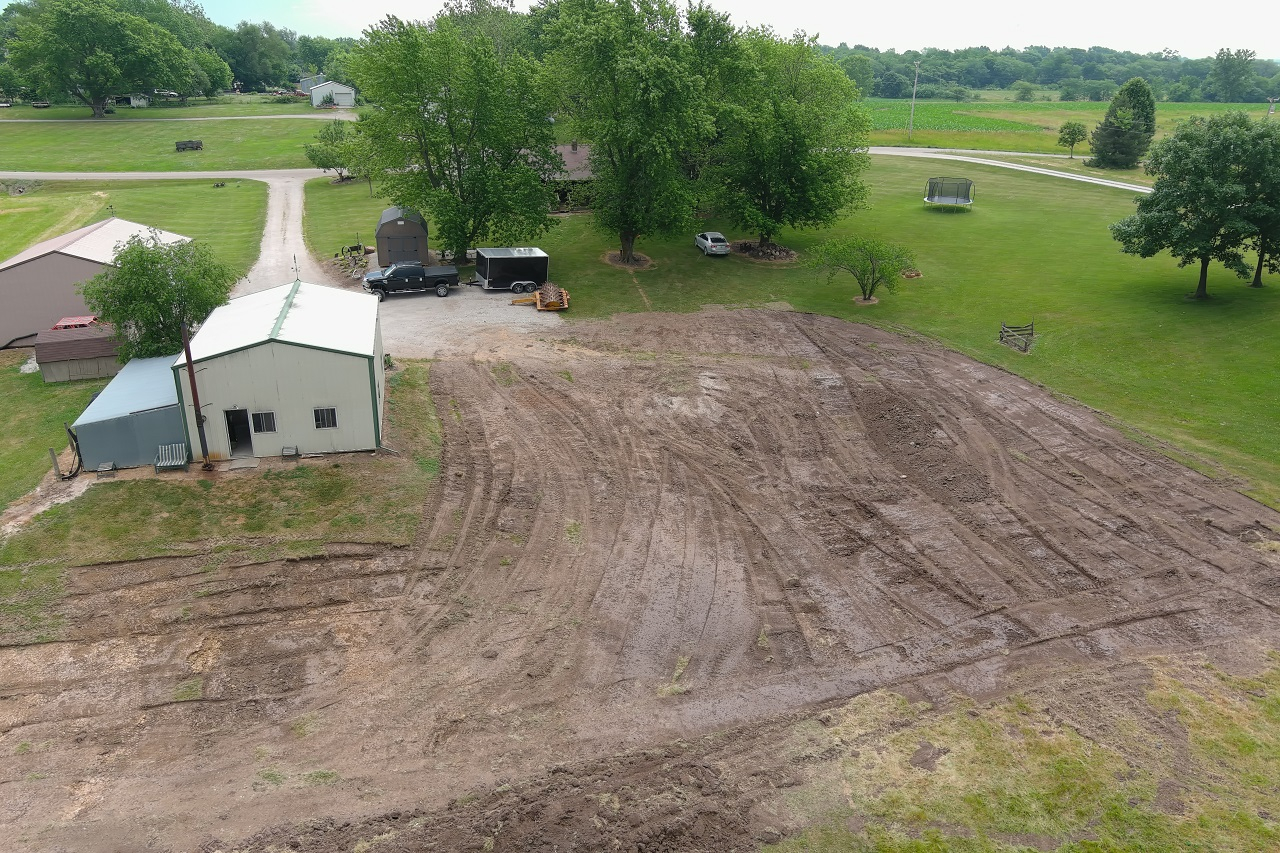

Last Summer we built a dirt pad for my Son to extend his existing shop. The pad is approximately 70ft x 150ft. At the lowest corner we elevated 11ft. We also extended the pad on two sides of the existing shop. Estimate that we moved 1,750 yards of dirt for the pad. Estimate we stripped 350 yards of top soil and then replaced it.
I started the project with my Kubota M9540 pulling a 5.5 cuyd clamshell scraper. Took me 40 hours to do that. I piled it in two separate strip piles that I could drive on and dump.
Once the pad build started I pulled a 9ft Sheep's Foot, dual drum, filled with diesel fuel. A pretty constant load on my tractor. 2,000 rpm, 4th gear, FWA engaged.
The pad dirt was placed with a 425hp JD FWA tractor pulling a 13 cuyd scraper.
Turned into quite a project that took us a couple weeks to complete. This pic is after I stripped the sod. My tractor and scraper setting in the left side of pic.

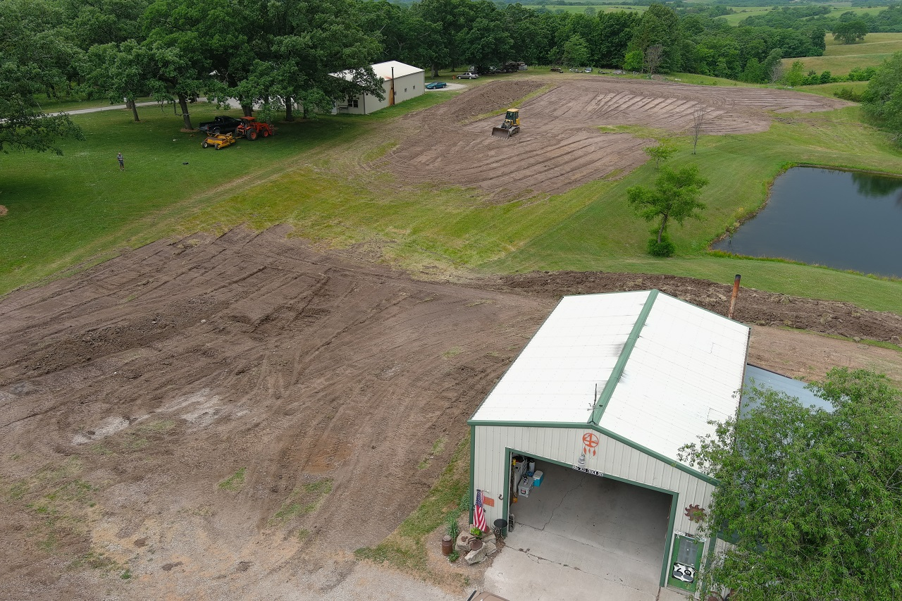

Here's some pics after I stripped the sod, before we started hauling fill material.

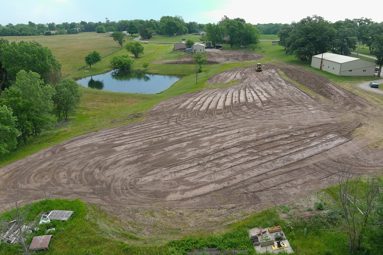

A Drone gives great perspective. But in this case it also "flattens" everything. Hard to envision how much fill was added at the far end and toward the borrow area.
Yeah the drone fish-eye and altitude definitely flatten the view, but in your pics we can still tell there is a huge depression beside the shop that you obviously had to raise up to match the building grade. Maybe even 10 feet or more of fill to bring it up? Wow, lotta dirt. How many gallons of diesel were used to do all this?

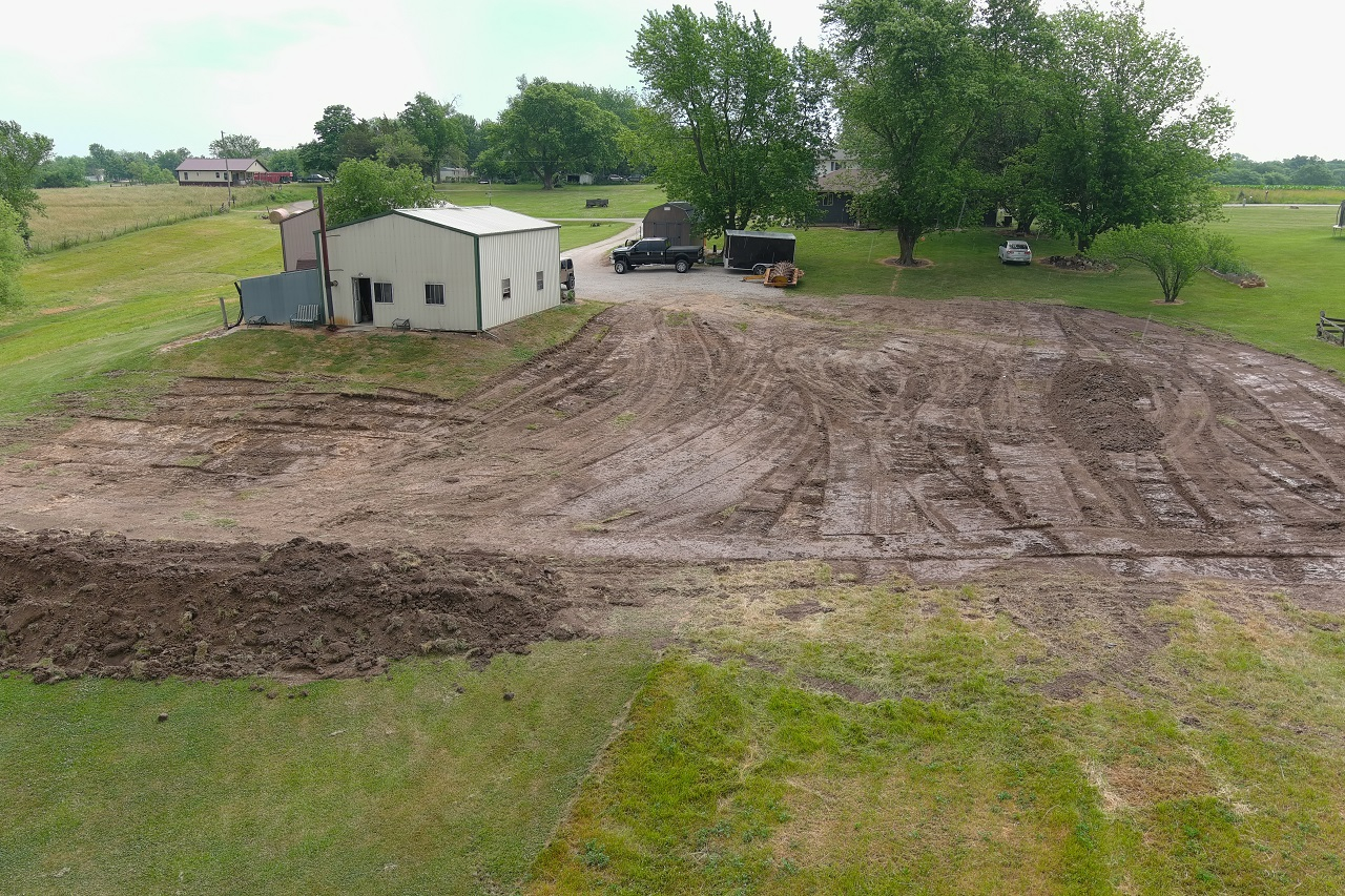

Took these pics yesterday.
Farthest corner from the existing building was elevated 11ft.
Didn't keep track of diesel fuel burned. That's actually a minimal cost that's rarely tracked. :)
