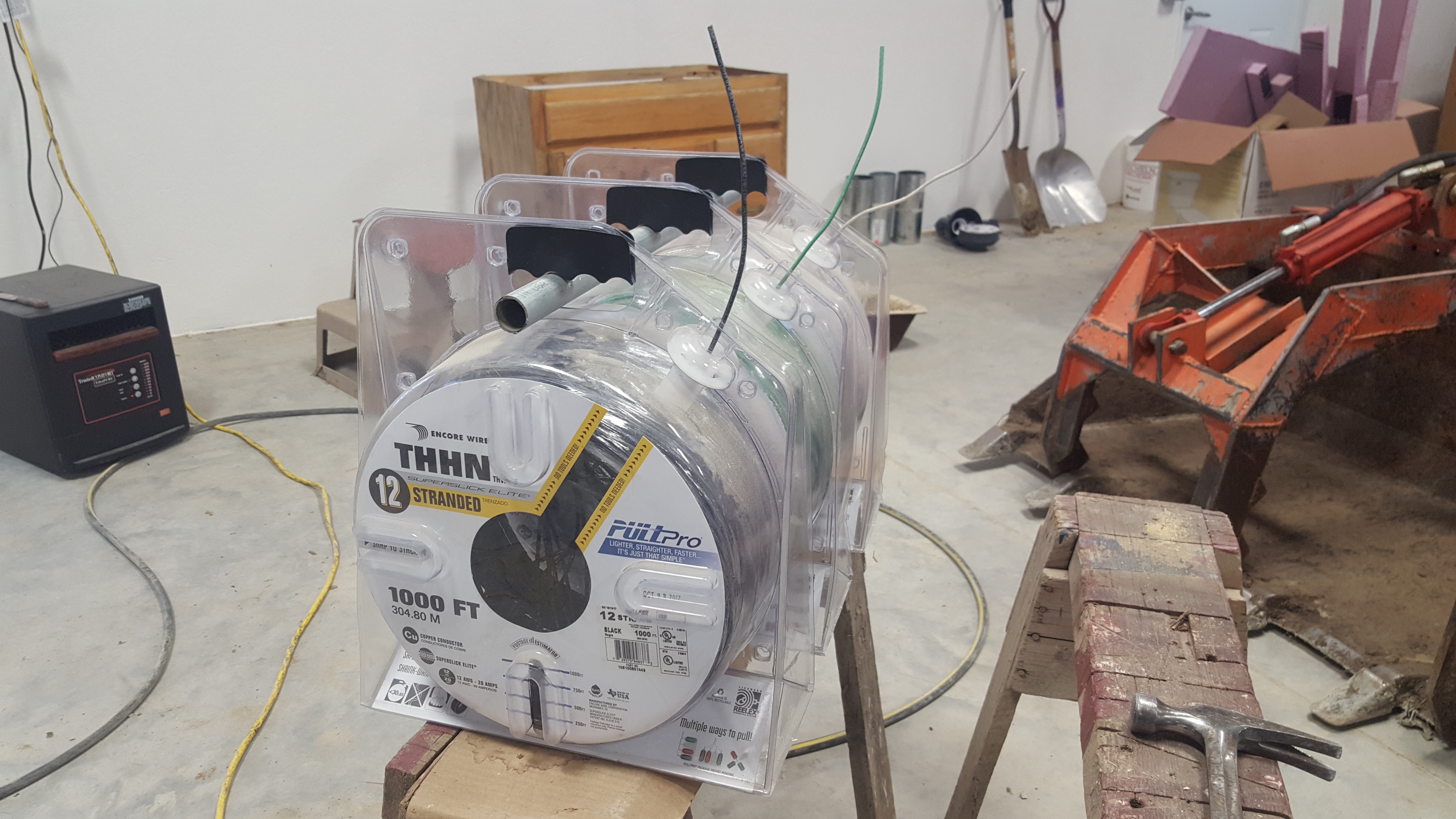

How did you go about running all the wire?
Ran it as your hung the conduit?
Pushed it through after conduit was hung?
Pulled a string?
I am doing all exposed conduit in my shop also, simply for the easy access and ability to change things, plus I love the look.. I’m going with white tin walls also.
I pushed almost everything. Only time I pulled was when running my #6 welder wires. I used plenty of junction boxes. This minimized the length of my runs. I used #12 strand wire for 110V runs. It's designed for conduit use and is easy to push. I'll get a pic of the spools and wire today.

Here's a pic of the #12 I used. To date I've used approximately 2,500 ft of wire just for the 110V stuff. Another 400ft of #6 for 220V stuff.
280ft of 1/2" conduit. 150ft of 3/4" conduit. 35 junction boxes. 50 duplex plugins. 3 220V plugins. 6 single pole switchs. 8 T5 six bulb lights. 2 outside man door lights. 1 outdoor security light. Dozens of conduit connectors and couplers.
I'll get a precise dollar amount when I'm done. I'm guessing now at $4,000 for electrical.
