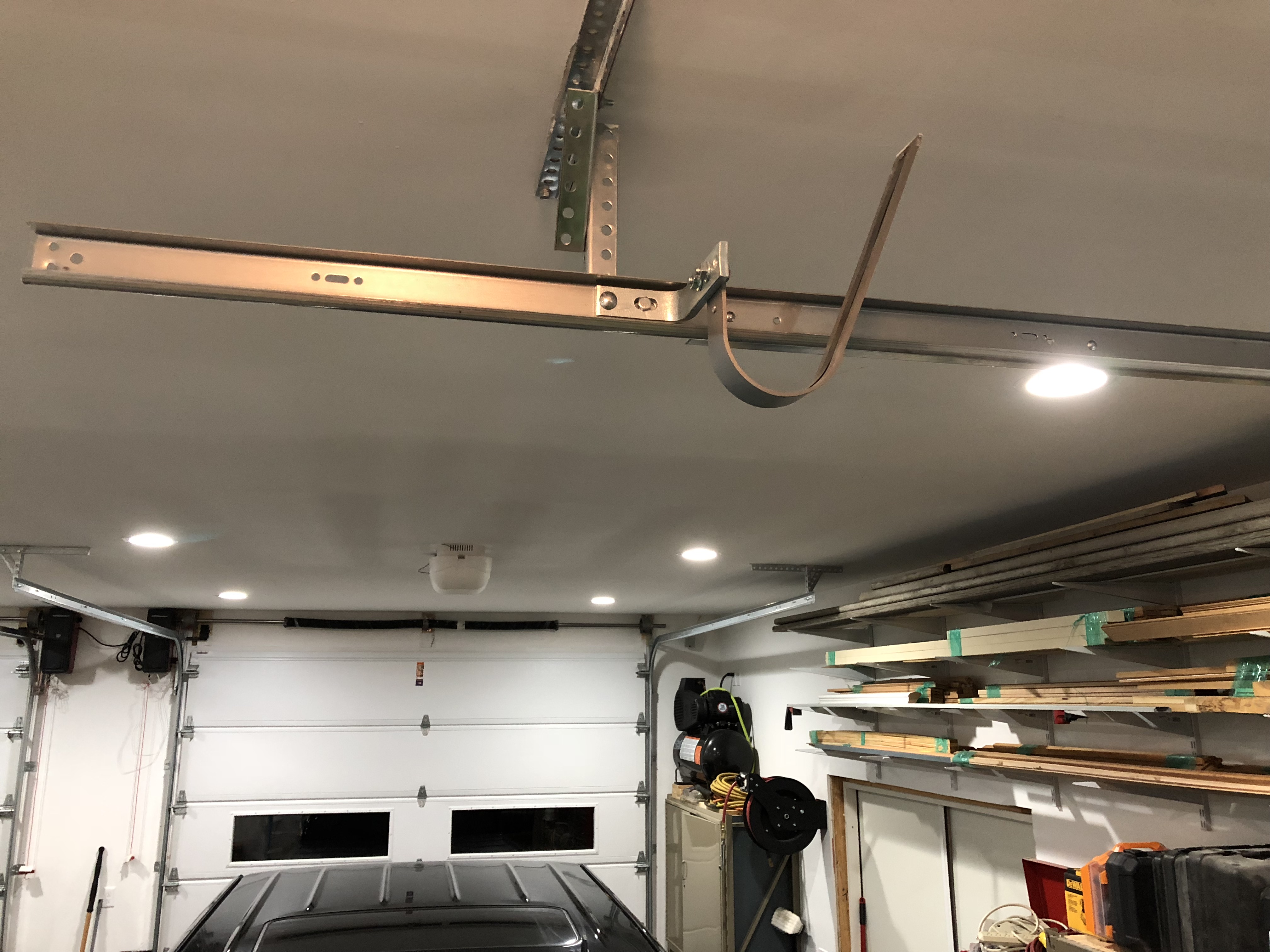

All this talk about garage doors, I lost my head a bit and forgot to tell you how great your shop is. I agree with Citydude, I love the ceiling too. My general shop is 28x32, wood shop is 20 x 20 and metal shop is 12x28. All walls have 1/2" OSB covered with 1/2" drywall. Like everyone says, should have made it bigger. I love the industrial look of galvanized conduit. I had the electricians wire my mechanical room with conduit.

I don't remember what model mine are. They are much heavier duty than Ed's. My Son has three like Ed's, they work fine on his 10x10 doors.

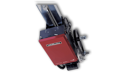

Friend of mine is building a large shop. They are using Liftmaster units similar in size to mine. But they turn the torsion spring shaft via gears and a bicycle chain. They mount on the wall a couple feet below the shaft. They also use a "buggy spring" looking affair that puts downward pressure on the doors when they are full open. They are 10x12 doors.
I have that buggy contraption on my small door, I think because it is only 7'H x 8'W and I wanted it to and track against the ceiling. It angles away from the wall, then curves, goes level with the ceiling and bumps the buggy spring thing. The two 10'Wx9'H doors do not have this contraption.

Yes, my doors are 10'W x 9'H. My ceilings are 10' as I have a 2 bdrm apartment above. I never heard of a slack issue with the cable. I have a cable tensioner thing on each door cable that is connected electronically into the system. To be honest, not sure what it does, if anything but I do remember the installer mentioning it. Looks like you could have done the LJ8900W for up to 180 Sq Ft of door.
The tensioner detects slack and slows the opener to prevent a tangle.

These are my first. I am impressed with the quality. Well sealed at the panel joints. Really like the rollers. Smoothest operating doors I've owned. I'd have to look for certain, but I think they were just under $2K each.
When I bought my first pair in Austria... I was taken back on the price... but, then everything costs more there... then I really took a look and began to appreciate the quality... also the design doesn't have pinch points like my sectional in Oakland... the entire door and opener operate smooth and quiet... plus weatherstriped and insulated.
