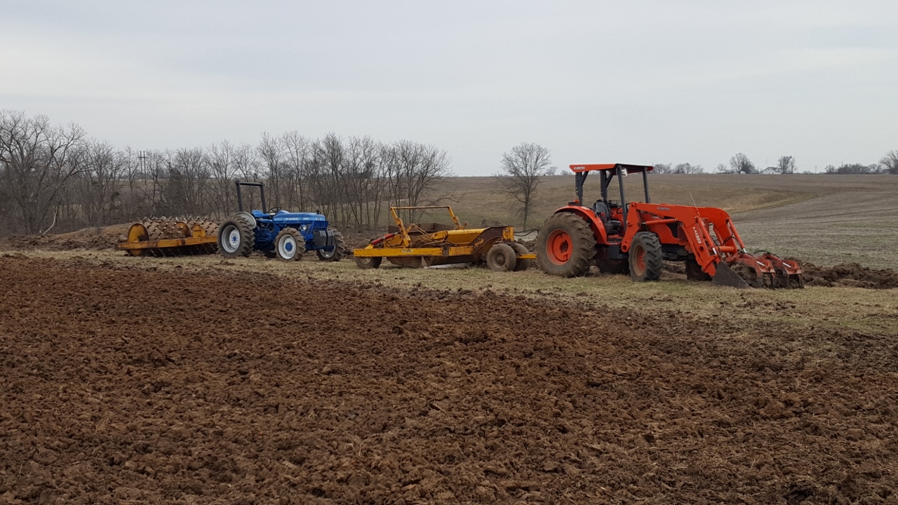

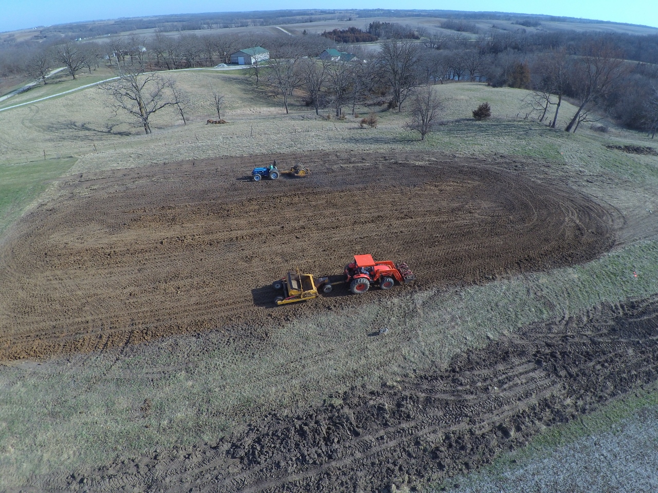

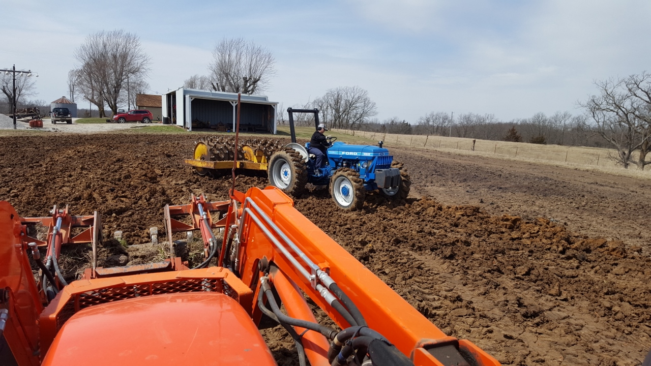

In March we started moving dirt to create a building site. Hauled dirt with my 5yd clamshell scraper and the Kubota. Packed the fill with an 8ft sheep's foot and the Ford. Moved approximately 1700yds of dirt. Started by removing the topsoil and piling it in a ridge pile. Stripped the site area and the borrow area. Had to haul the clay 250yds or so. Many, many trips.
Terry helped me a couple days running the Ford. I actually felt sorry for that tractor. Wide open throttle, second gear, 4wd. She would still occasionally get stuck and I'd have to bump her a little.

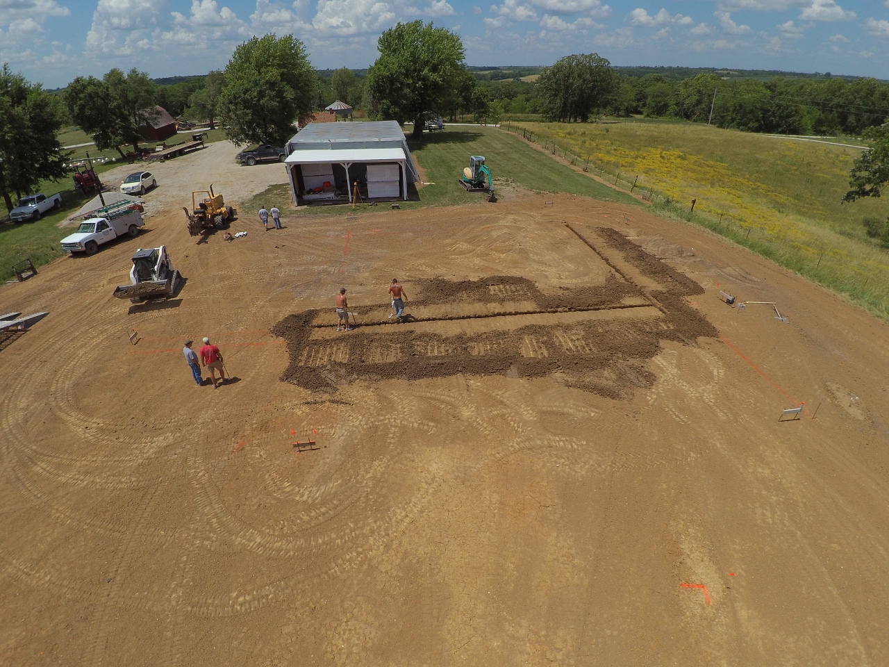

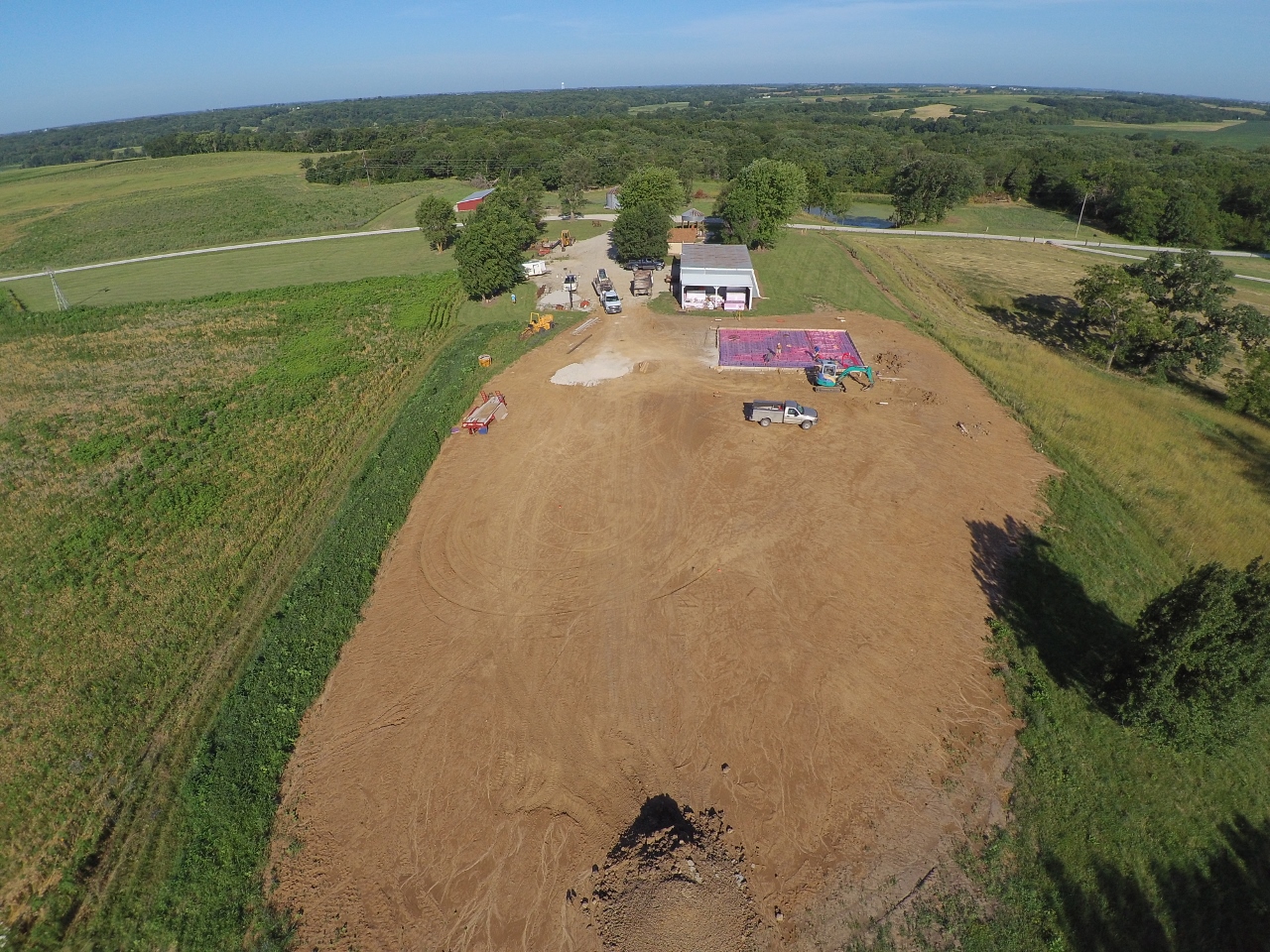

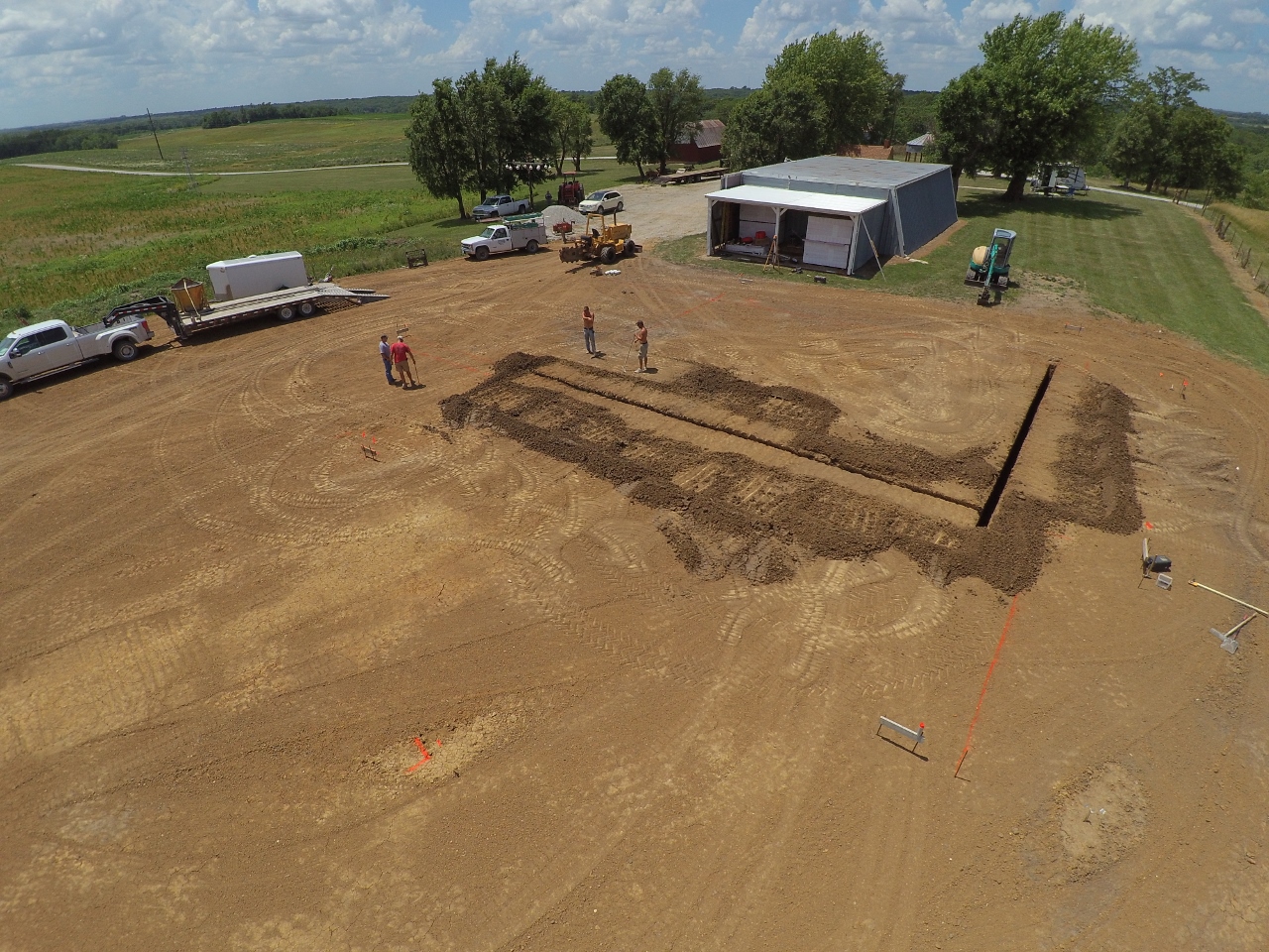

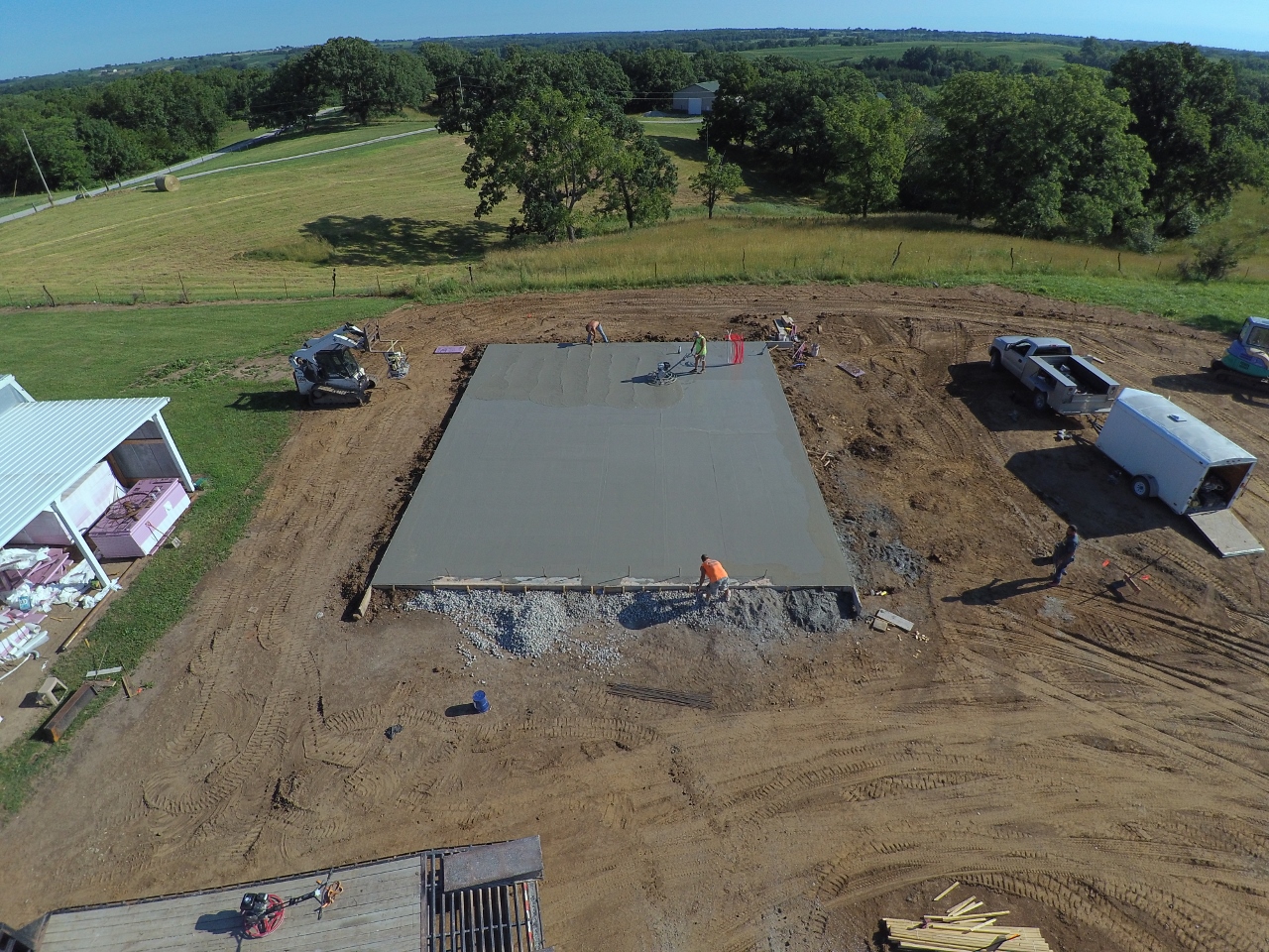

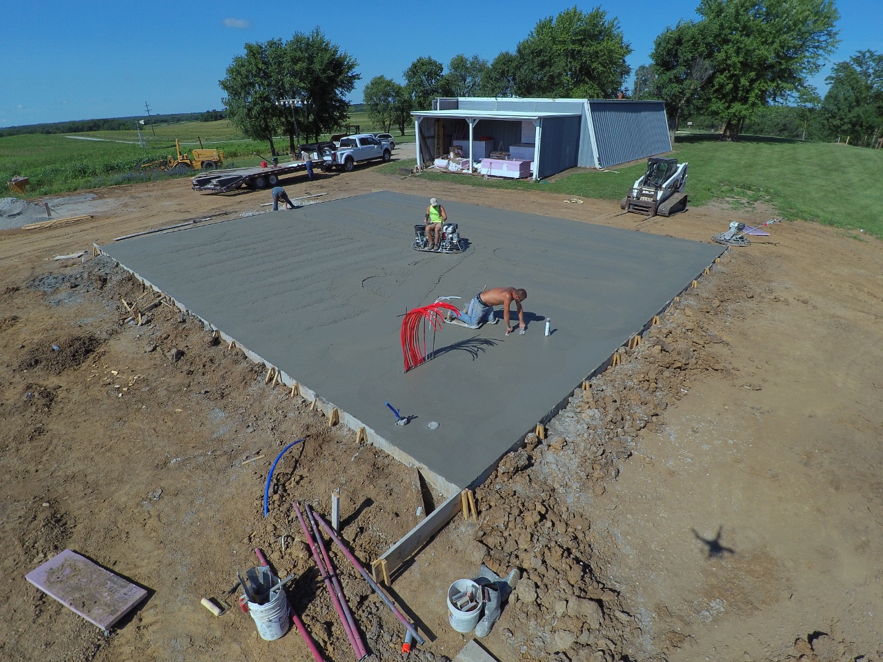

Used a Laser Transit with Terry's help to level the finished pad. Will be the 48x39 shop sitting North/South. 35ft gap. Then the 72x40 house sitting at 205 degrees off the East side of the shop.
Have an excellent concrete crew pouring for us. Very, very busy. You need patience. The quality of his work is worth the wait.

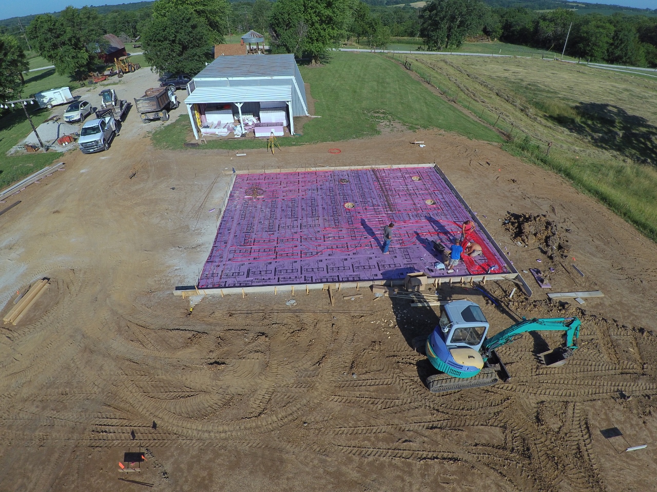

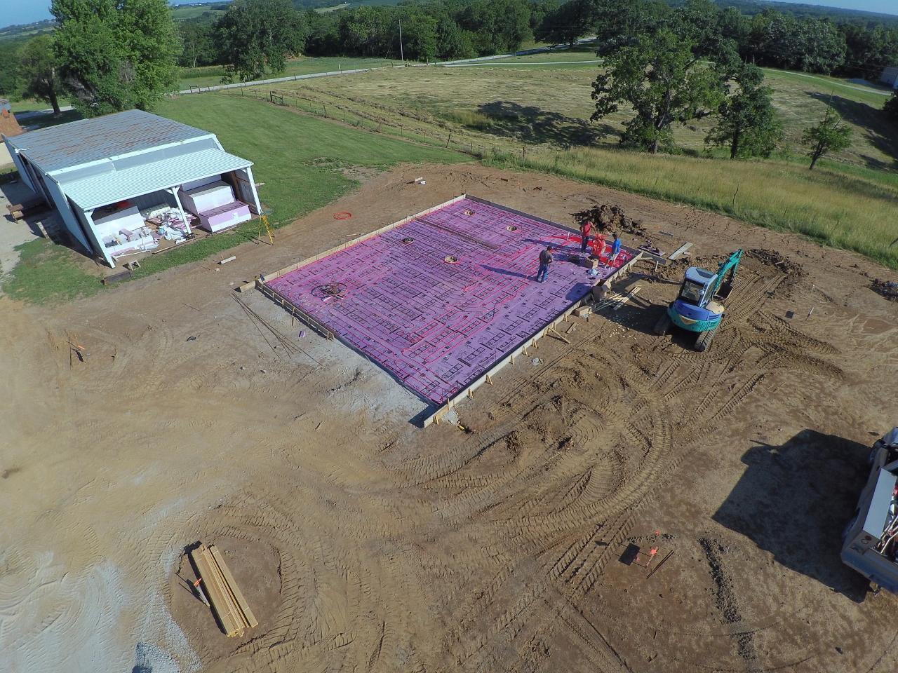

Trenched 42"x10" footings. Lined the inside of the footing with 2" pinkboard. Then 3-4" of tamped crushed gravel. Then plastic. Then pinkboard. Then PEX for floor heat. Then rebar on chairs. Then poured 6" of concrete.

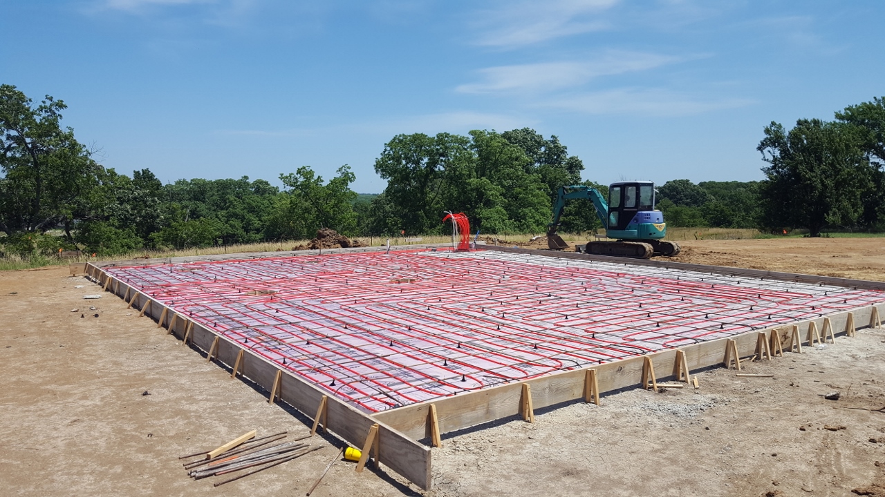

Here's a couple more pics of the PEX process. The loops are 250ft. There's nine loops. One Zone. When I hook it up I'll do a separate thread. The Hydronic Radiant Floor Heat world is something new to me. First thing I learned is there are hundreds of opinions and everyone is loyal to theirs. :)

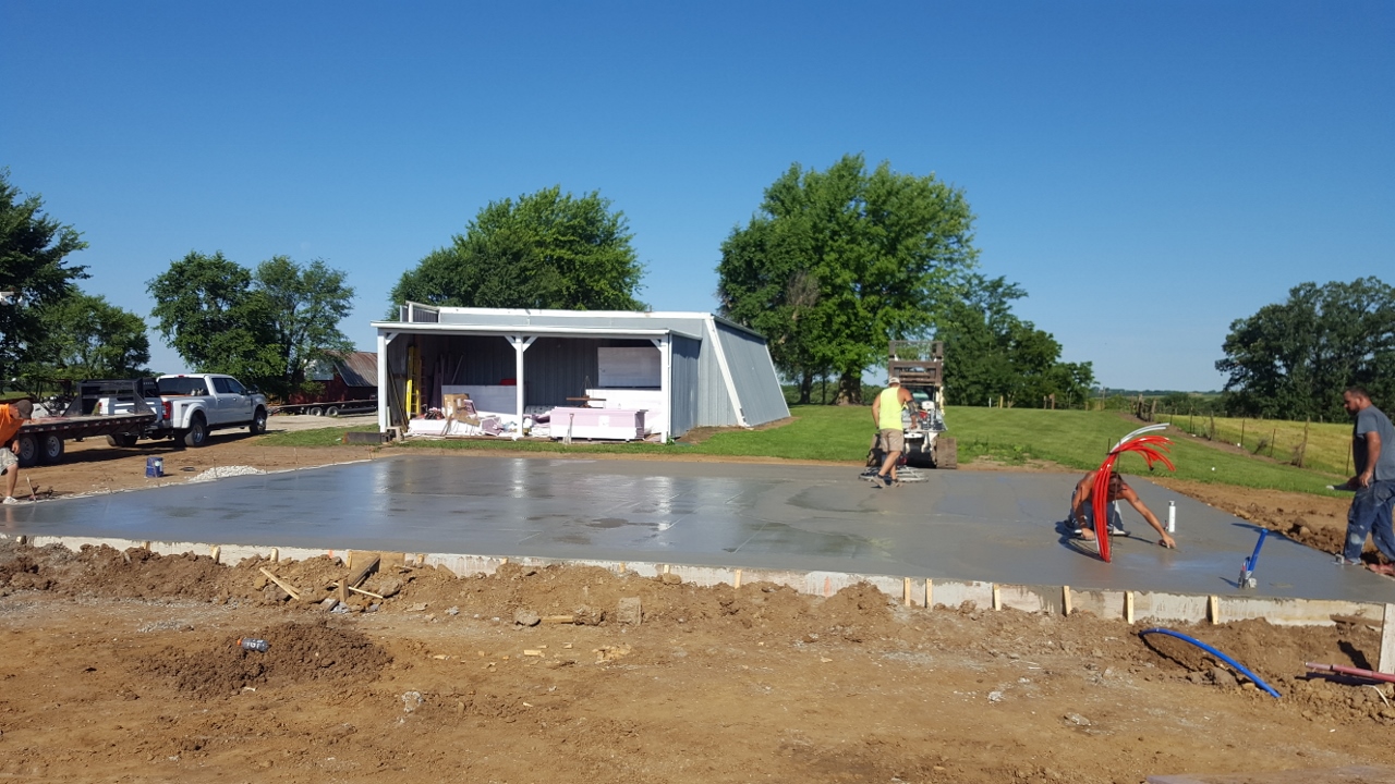

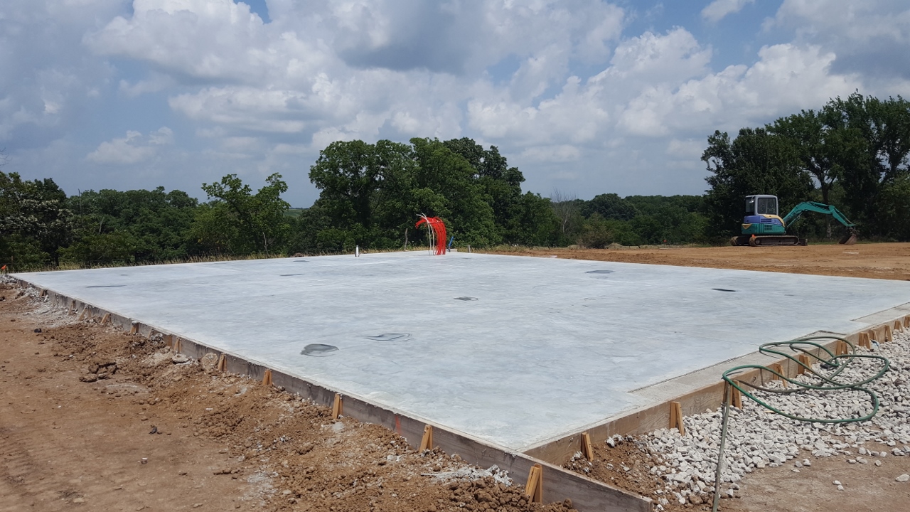

I have the highest respect for concrete crews. Very hard work. Very timely work.
Ledgerwood Concrete did our pour. Heath is widely known for his ability for finish flatwork. He works and is well known over a 50 mile radius of here.
In the corner where the PEX protrudes will be the mechanical/bathroom. Floor heat workings, air compressor, electrical panel, stool, sink, in a 12x7 room. Floor drain in the center.

I don't remember the exact yardage of concrete used. The total bill was just under $18K. Concrete properly poured is expensive. But then,,,, it's what the building is resting on. No room for failure. :)

This building is what us Missourians call a "stick built". No poles. 2x6 studs. Outside of the studs as 2x4 purlins. 2x6 purlin where the wainscoat splices. So,,,, the outside dimensions of the lumber are actually 48ft 3in x 39ft 3 in. This accounts for the purlins. So,,,, the concrete dimensions are actually 48ft 3in x 39ft 3in. Make sense??? :confused2:

There's a 42" deep x 10" wide footing around the perimeter including under the doors. Then the 6" slab poured on that. The footing has rebar which protruded out the top 18". Before the slab was poured that rebar was bent horizontally and embedded in the slab.
Hope that answers your question? Sorry I didn't get a pic of that procedure.

No.. I mean where your door openings are, your heated floor doesn’t extend beyond the door opening does it? To the outside?
