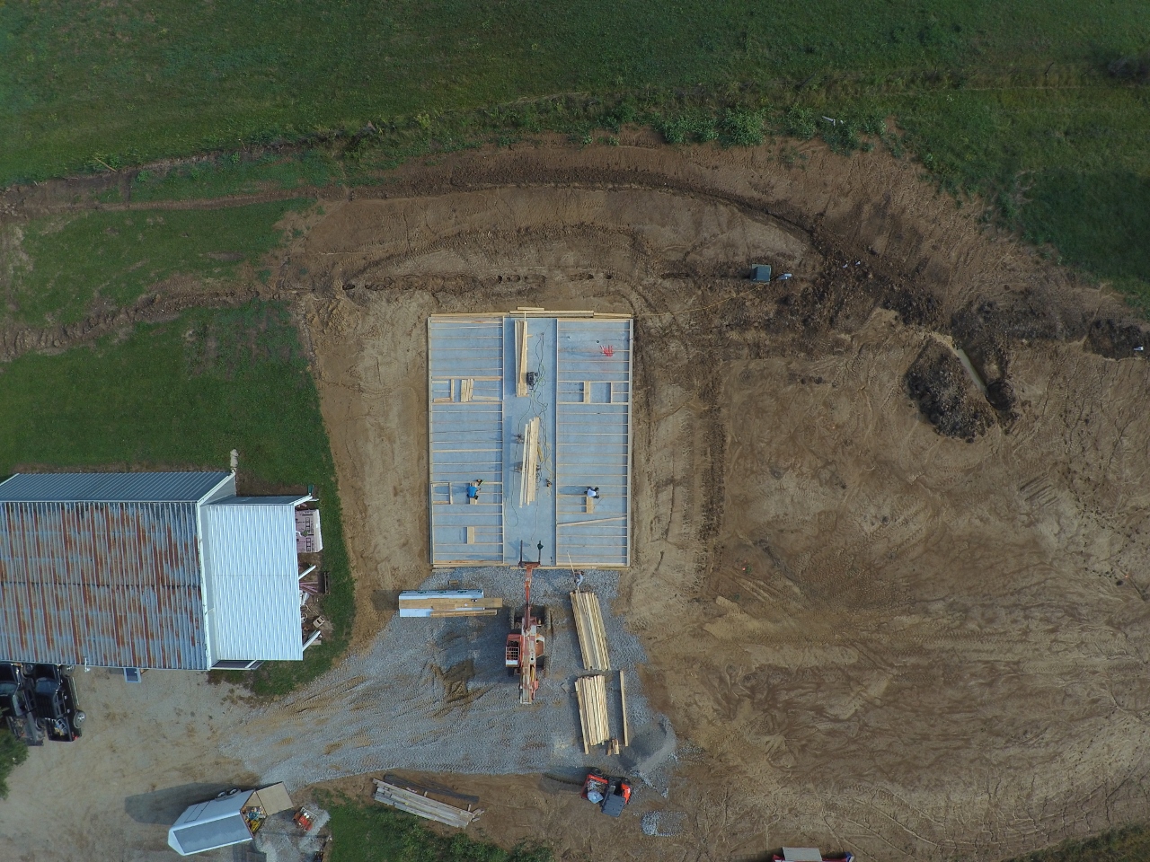

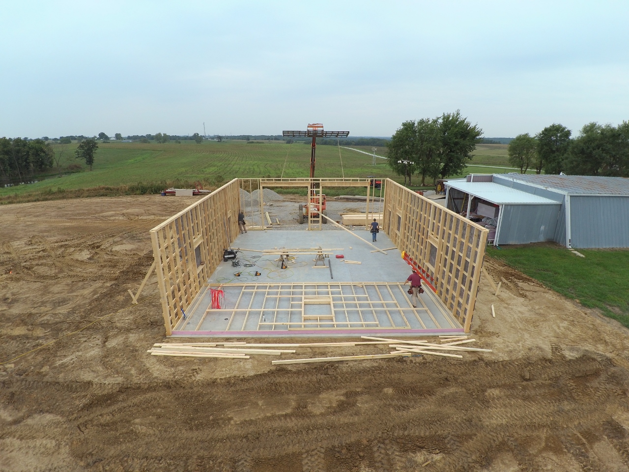

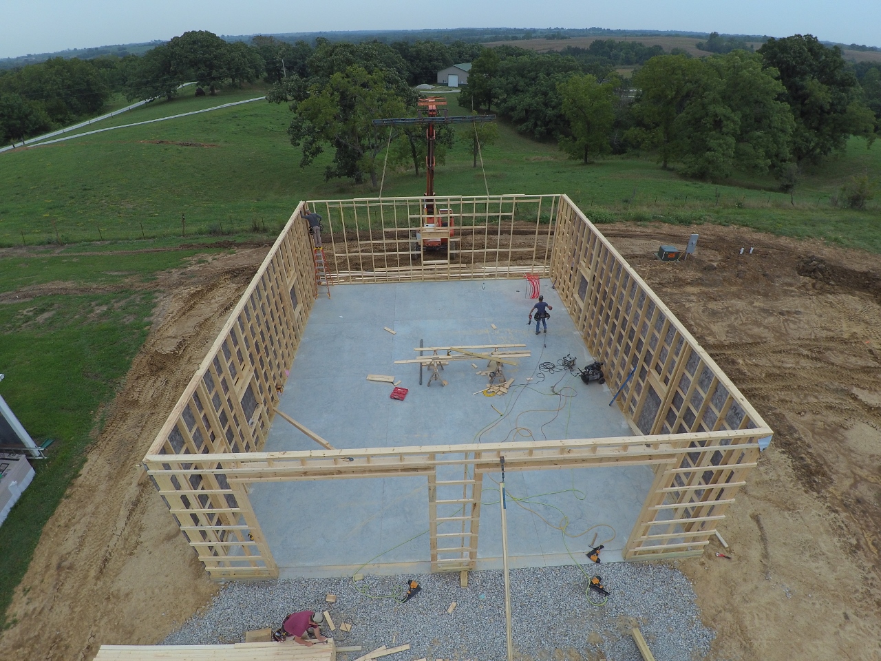

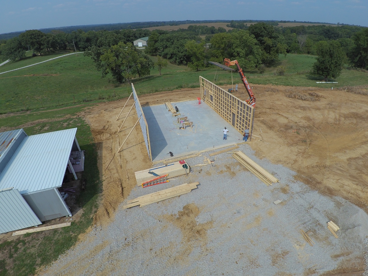

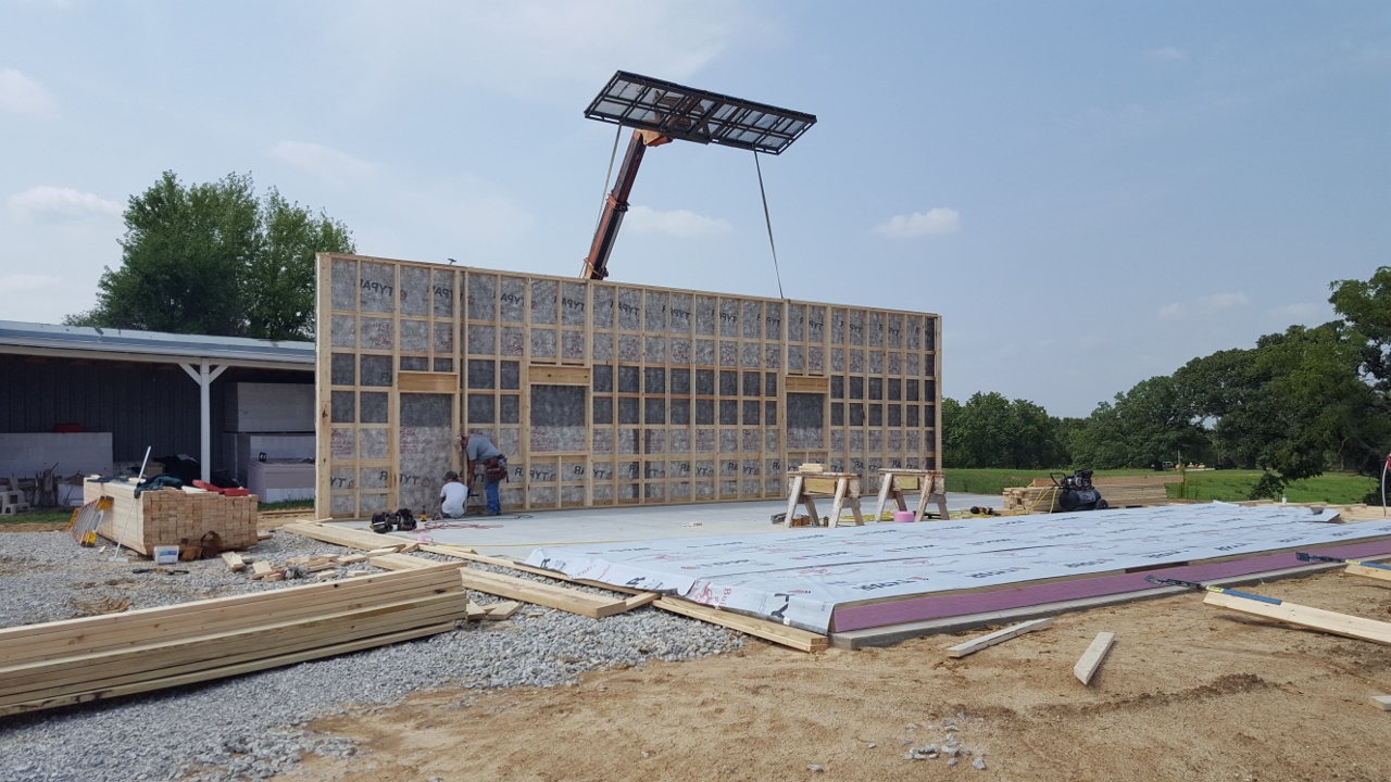

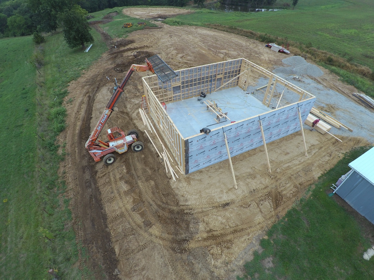

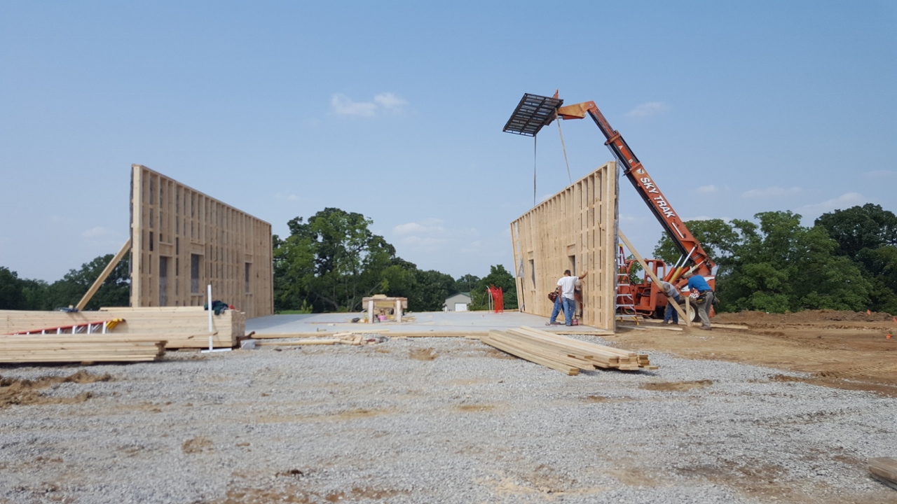

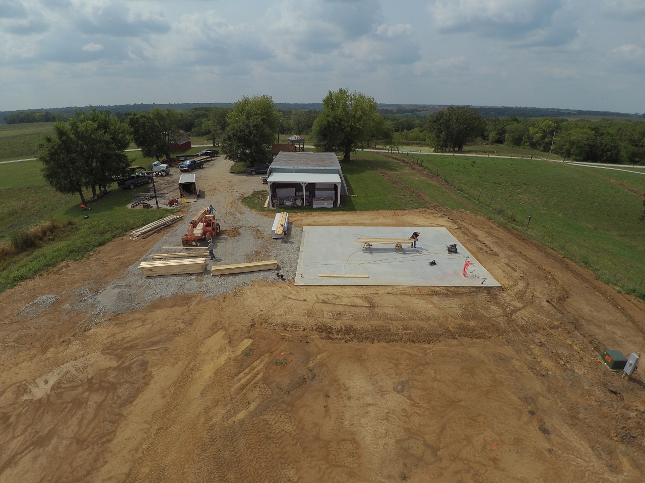

Progress report.
The lumber build part of this started on Wednesday the 22nd of August. When they quit Thursday evening they were ready for rafters. Four guys working. Everything has to be cut. They have electrical and air support. It was a true pleasure to watch them work.

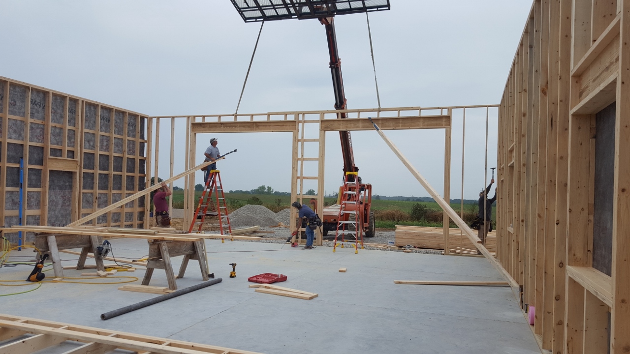

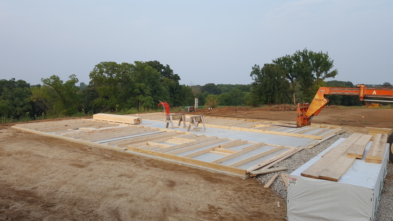

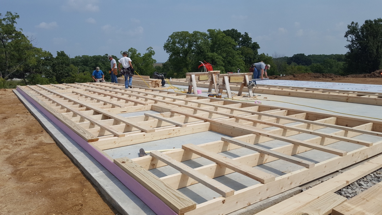

I apologize for my pic size. I prefer to post them large so they don't have to be clicked on to view. My laptop is on it's last leg and won't give me that luxury...
