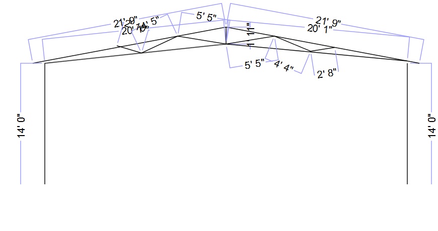

We've finally moved so now I need to build an area to work out of the elements. Budget isn't going to allow doing a fully enclosed building or a concrete slab right now so I'm just building the frame and putting a corrugated tin roof on for now. My plan is to use 2 3/8" drill stem (pipe) for the posts and rafters built sort of like a truss. I'm planning to set the posts on 10' centers (set 4' deep on concrete and with 120# of concrete per post) and the rafters on 4' centers and then bolt 2x4's onto the pipe with brackets on 4' centers to screw my corrugated tin roof onto. Initially, I'll build a 20 x 40 work area so I can cover my container, later expanding that our to 40 x 40 or 60 x 40 as funds allow.
I can get all the material I need for this as I have it designed for about $1,800 but, before I start throwing this up, I thought I'd see what you guys thought of the plan. Attached is a drawing of how I plan to frame it. We have no snow or frost line here but, it does get pretty windy. The soil is mostly sandy loam with some clay for about the first 4' and then caliche below that. If I get down to the caliche in each post hole, I should have a very solid base.
Any feedback, good or bad, is appreciated.

I think your roof is going to be floppy. Take a look at a standard truss. Everyone focuses on the top shape, but the bottom chord all the way across the bottom is what holds the building together and keeps the walls from pushing outwards. I think you need to have a continuous chord from wall to wall and some stiffened legs to hold the top chord.
Fwiw, I'm a civil engineer by trade.

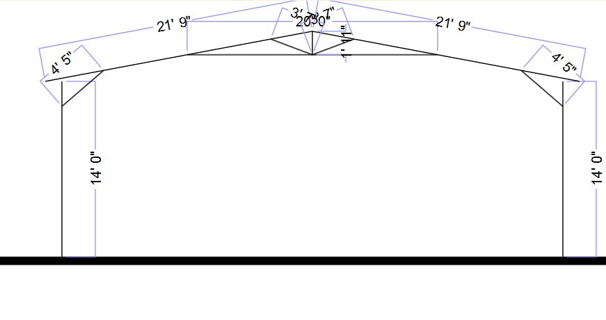

I was planning to run a piece of pipe all the way along the top of the posts and then notch just a u out of the top of the pipe to set the rafter pipe into. I'm also going to run a piece of pipe along the ridge that the rafters will be notched and welded to. I think the structure should be pretty rigid, everything will be tied to everything else somewhere. I'm could do these a little more like a scissor truss, it won't add a ton of material. I'm actually going to have a fair amount of waste with the way it's laid out now. More like this.
I am concerned that 4' spacing for the roof purlins might be a little far though, I might cut that down to 2', it only adds about $300 to the materials.
I agree but I'm only an electrical/electronics engineer by trade albet a retired one. Something to help hold the walls together and make the roof trusses into a complete triangle and so stiffen the entire structure.

The walls will get girts when I enclose it. If it seems loose, I could add one 3' or 4' down from the top now to stiffen it.

Both designs look like you are trying for more than 14 feet clearance in the center. If this is needed, then just make the posts taller and use a simple triangular truss for the full span.

I do stack stuff pretty high inside but it's more that I hate wasting all the overhead space with regular trusses.

Op, your walls will be plenty stiff. I was worried about the impromptu rafters trying to spread the top of the walls apart. If you had a chord to connect the tops of the walls with the same direction as the rafter it will be all the better. We have wooden trusses in our 80x40 building that are on 4ft centers so that shouldn't be a problem. I would really want to run a truss analysis to see if everything would be allright. Have you ever priced out trusses??? They are super economical and are most likely built cheaper than you can do it unless your materials are free.
/ Building a covered work area with a 40' span, will this work? #9
Do you know someone who is actually a structural engineer? The calculations are fairly simple, but I think this project needs to be analyzed. As a first step, I would go with a full scissor truss instead of the tie approach you started with. You are going to have a real potential for the rafter to buckle where the tie connects.

With your design the pipe will act as a beam not a truss. I do not know the strength of the pipe to know if it will work as a beam
The cost for an engineered design and material would probably be higher than the cost to buy trusses
Four foot spacing on 2x4 to support metal roof is not adequate

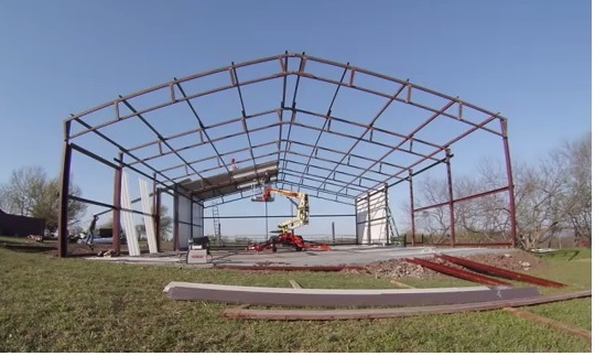

I've been looking at some steel structures with steel trusses online. A lot of it on really long spans, like aircraft hangers, has webbed beams with horizontal cross supports part way down, sort of like my original plan except that the top becomes a webbed beam. They look to be constructed mostly of angle iron. Then I see some that are webbed square tube but, I also find a lot like the ones I've attached here that are basically just bent square tube with some gussets. I get that these aren't quite as long of a span, although one of these looks to be a little more than 30'. Even given that my span is longer, the fact that pipe is stronger than square tube, and definitely stronger than angle iron, and then add that drill stem is hardened steel (although it will have some internal wear from use) and it doesn't seem like this is really too much to ask of it.
The last picture here is a 40' span. I don't know what the material is but the truss design sure is basic on it and they're spaced much further than 4'.
And here are plans for a 40' span using webbed angle iron trusses.steel-truss-barn-plans-front.png

Our 40' span is like the one in the first pic, but improved upon. 2-1/2" square tubing. If you follow this design, it will be plenty strong. Our building got hit with 50 mph winds last Spring and even with 14' walls it held just fine.
