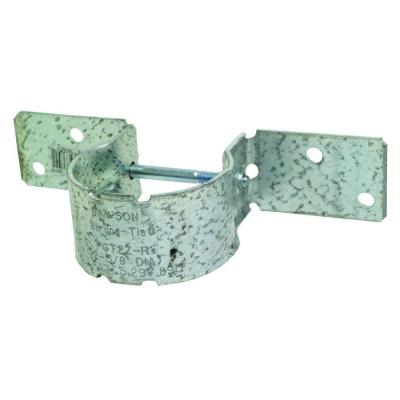

I think you mentioned bolting your purlins to your trusses. Adding holes to your trusses may or may not affect their integrity. I wouldn't do it. The common method is the weld on a piece of angle iron or U channel to set the purlin in. Then drill a hole through the tab and run screw through the hole into the wood.
How you attach and hold your purlins in place is going to be VERY IMPORTANT.
I plan to use these to attach the purlins if I use pipe. If I use square tube, I'd have to come up with a different plan, along the lines of what you described. These are made to attach the 2x4's to galvanized fence posts, which just so happen to also be 2 3/8" OD, which is why I like that pipe diameter so much. I also have bender dies and notcher saws for that diameter so I don't have to buy any tools to use it.
