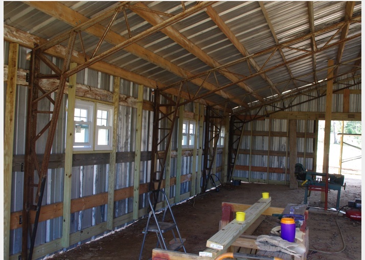

My chicken barns are 40' spans. They are steel trussed with angle iron web style trusses. They are a scissor style truss. 10 foot truss spacing with 2x6 purlins. There are U shaped pieces of about sheet metal welded to the trusses. The purlins are set edge ways in the U brackets and nailed in through drilled holes with 6 penny nails.
Does your framing look something like this?

I would never use used drill stem for a structural component. The issue with used drill stem is that the drilling mud is very corrosive. It will deteriorate from the inside out where you cannot see it till it's too late. Like Eddie said most people use it for fence pipe and even then eventually it has to be replaced. That is why it is cheap and available, drillers just want to get rid of it.

The main reason for the availability right now is that the oil patch in South Texas is essentially shut down because of low oil prices. That's put a LOT of white and yellow band drill pipe on the local market for as little as $26 for a 31' joint. Yellow band pipe is still 85% or more of it's original thickness so it'll take a LONG time to rust out.
That said, I hear what you're saying and with orange or red band, it is definitely a serious concern. I'm not saying I disagree with you, I'm just thinking on the keyboard.

An earlier post mentioned that round pipe was stronger than square, and that just aint true. Equal size, Equal thickness...Square is stronger.
You also mentioned drill pipe was hardened. Do you know the exact material? Have you welded it before? I would be concerned using some used, hardened pipe for trusses. Especilally when you have proven designs using angle or square that wont cost much more at all, And will probably speed the assembly up alot without all the notching.
What is the thickness of Drill pipe? No doubt 2-3/8" drill pipe is thicker and stronger than 2x2x11ga tubing. But the square will be lots lighter, easier to cut, easier to set, etc etc. And proven.

I'm not 100% certain but, I believe it's 1/4" wall thickness.
You make valid points, I'm kind of leaning towards doing the posts with pipe and the roof support with square. It'll speed the build and should still keep costs within budget.

I'm still wanting to build my shop much like you. My plan was to set drill stem 4' in concrete, leave about 4' exposed on the top, weld a square plate on the use the chicken house trusses for the side wall and truss. They can be had for close to scrap and usually can get the tin too.

I wish the chicken house trusses were available here. I found some like that on CL but, they want $750/ea for them - 33 foot pipe trusses. No way. Another one wants $400/ea for 40' (steel trusses and poles). Better but, still too much.
