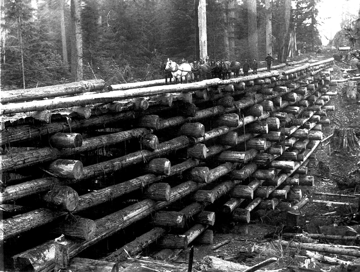

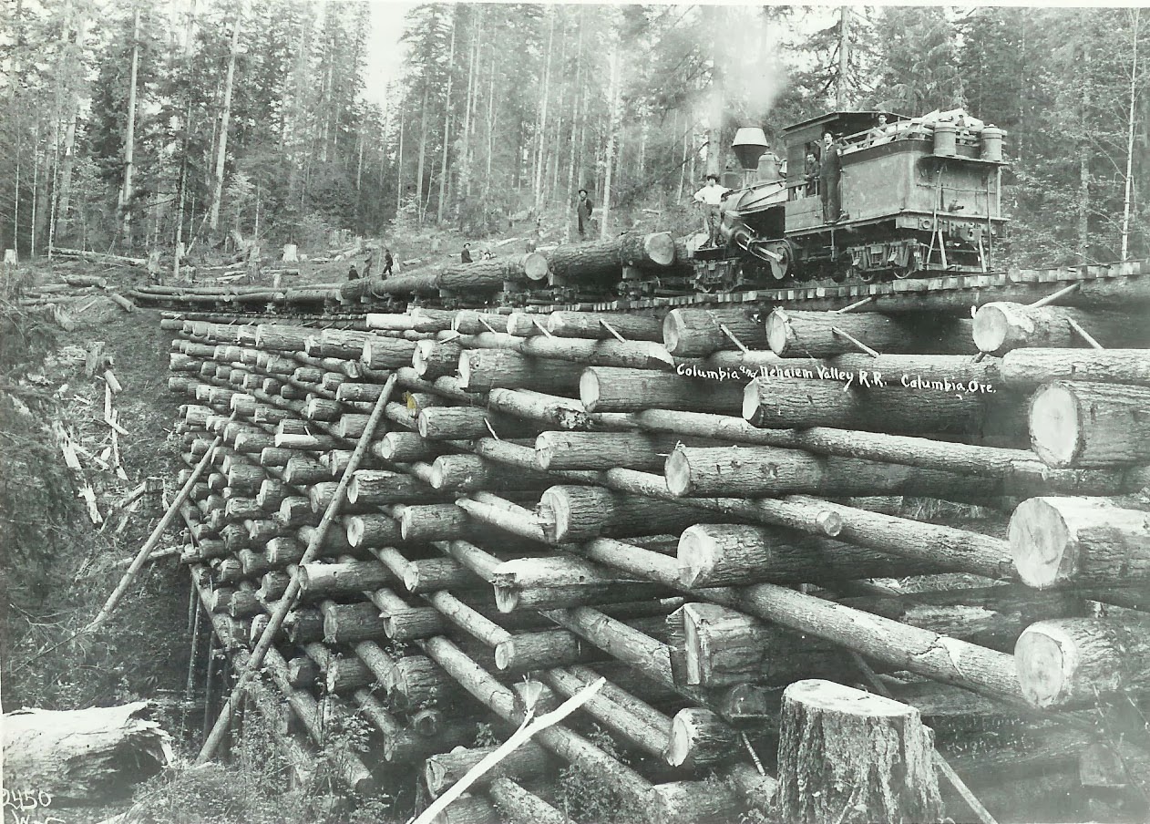

No clue how to even try and calculate how much weight those bridges will carry or even weigh themselves! :eek: almost looks like something that would collapse under it's own weight! Really great photos tho of the old style just build it rather than design it and then build it. I can bet the loggers did these bridges as they cut to get deeper.
Mark
/ Building a bridge #32
and when the job was done they probably loaded them up and shipped them out with the rest...
