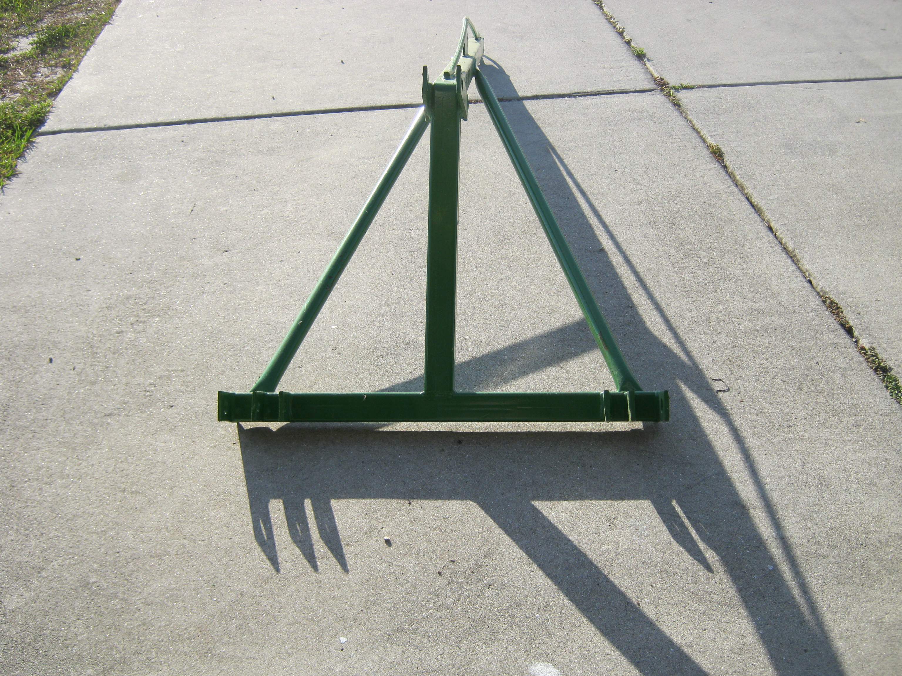

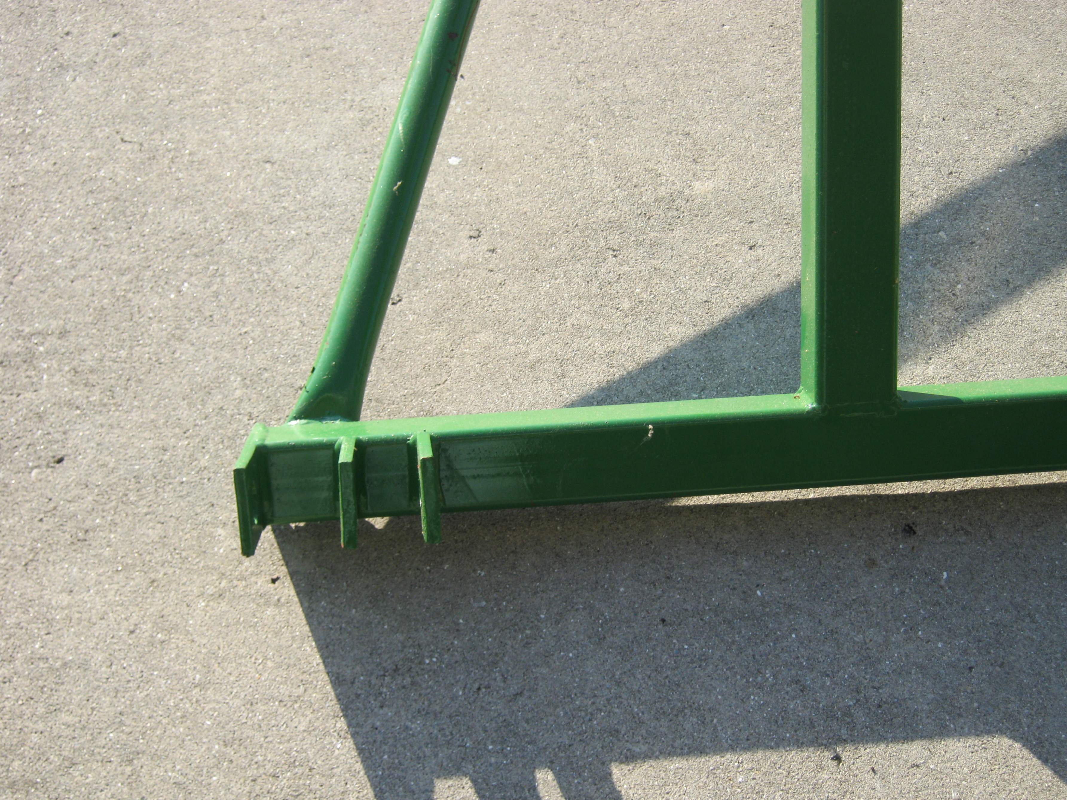

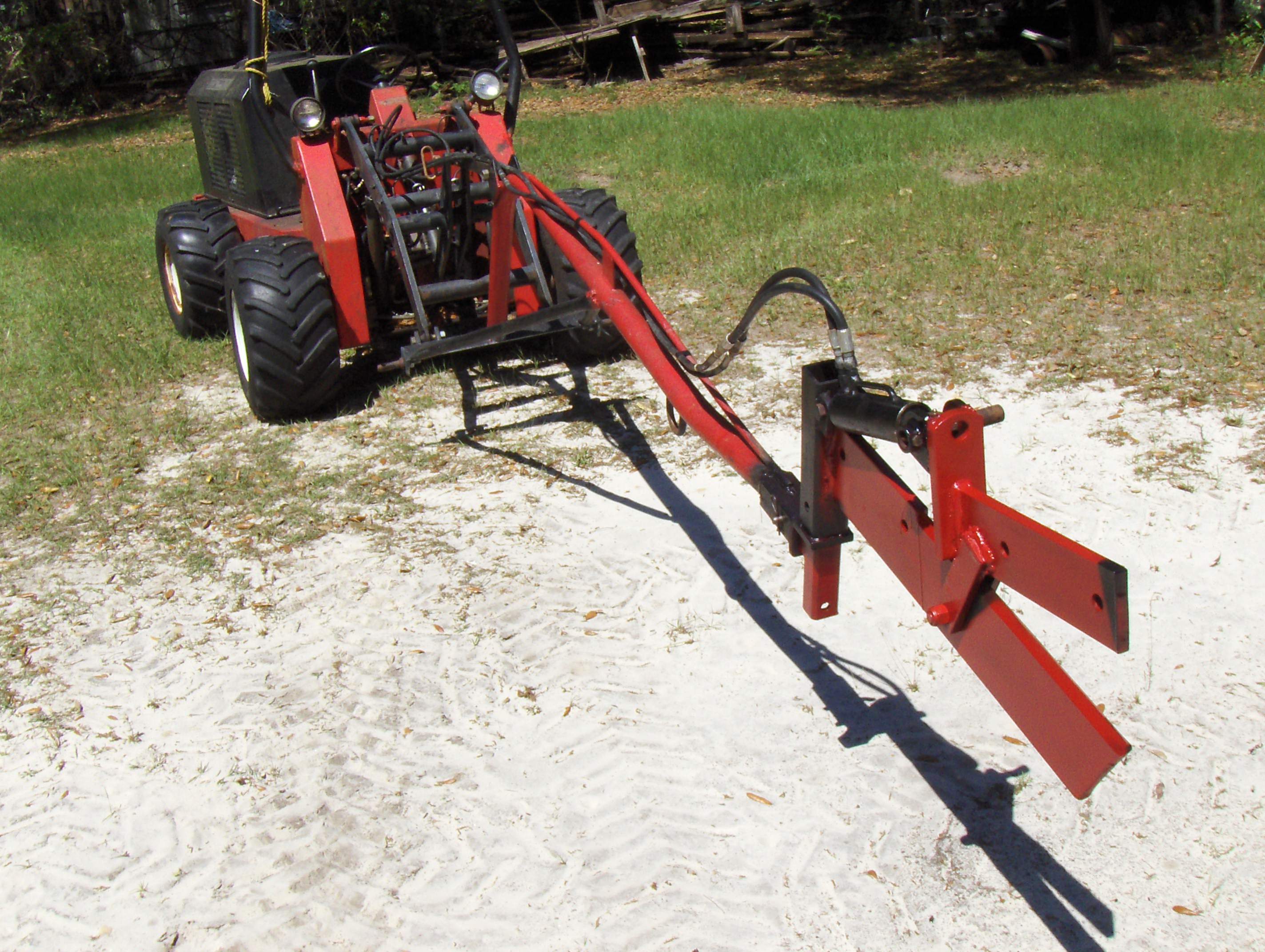

Here is mine that I adapted for the front.
I can use it on the Power-Trac, or a tractor.

   / Building a Boom Pole - thoughts? #7
Real neat set-up JJ ! :thumbsup:
Here's pic's of mine.
Boone

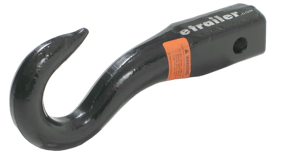

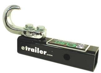

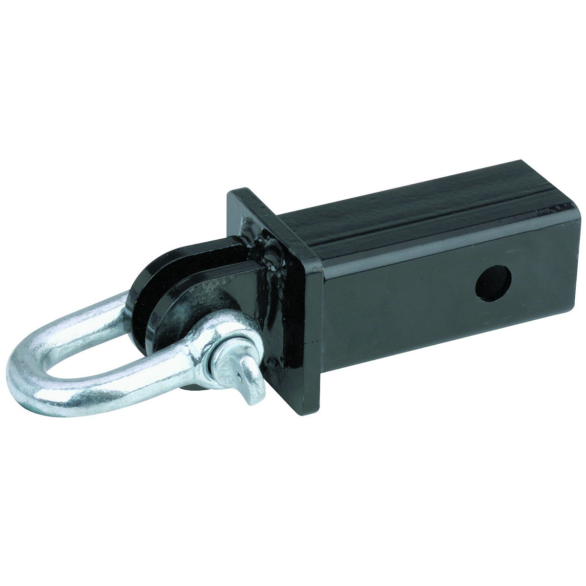

I also put a 2 in hitch tube on the end so I could use these.

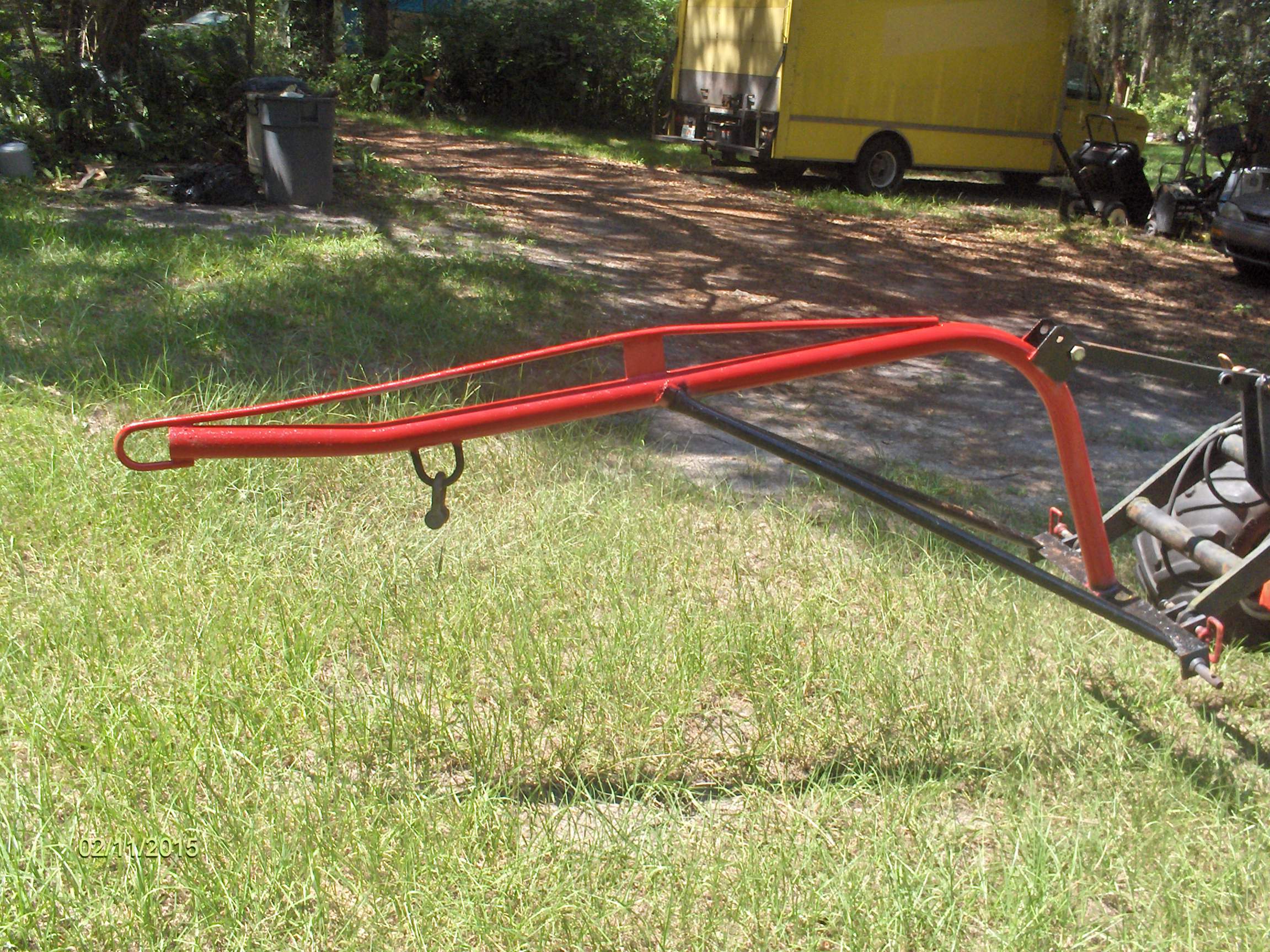

Search for and read the thread "Boom pole from TSC - Any good ?". Lots of ideas. Check my two photos. My pole is 6' and is extendible. AI paid thought to how to chain up to items and have a chain in a key hole that can not come out. It wont get lost. A receiver at the hitch side can use a trailer ball. I can pull a trailer while the pole is on the tractor, jack knife up to a load, pick up, and drive forward, leaving the load over the trailer. A second receiver, on the boom tip, can hold an extension. A hydraulic top greatly increases the boom tip lift. Made to fit an iMatch. Buy a QH and use it as a jig when you build. Easier than measuring, and useful.

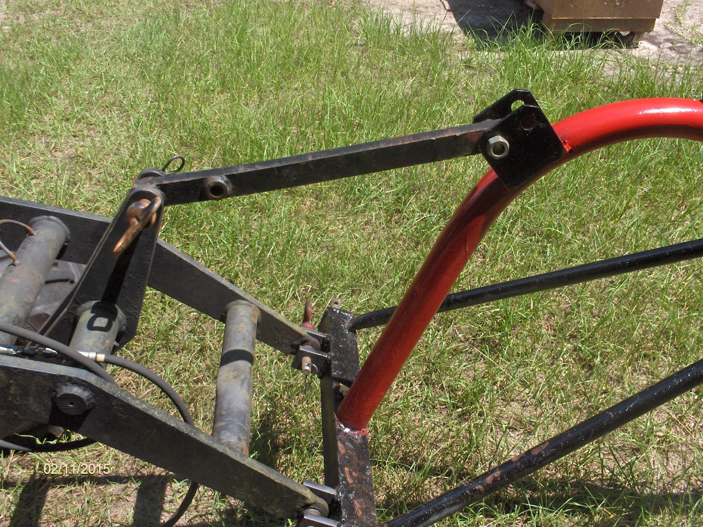

   / Building a Boom Pole - thoughts? #15
JJ luv the flowing curves on yours.
What is the hydraulic fixture in photo 3 used for?
The hyd attachment on my boom pole is a tree or limb or root cutter.
Here is another one of my attachments built using box bld shanks.

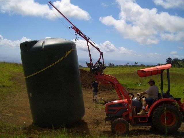

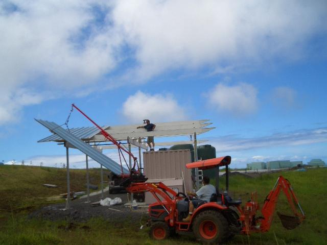

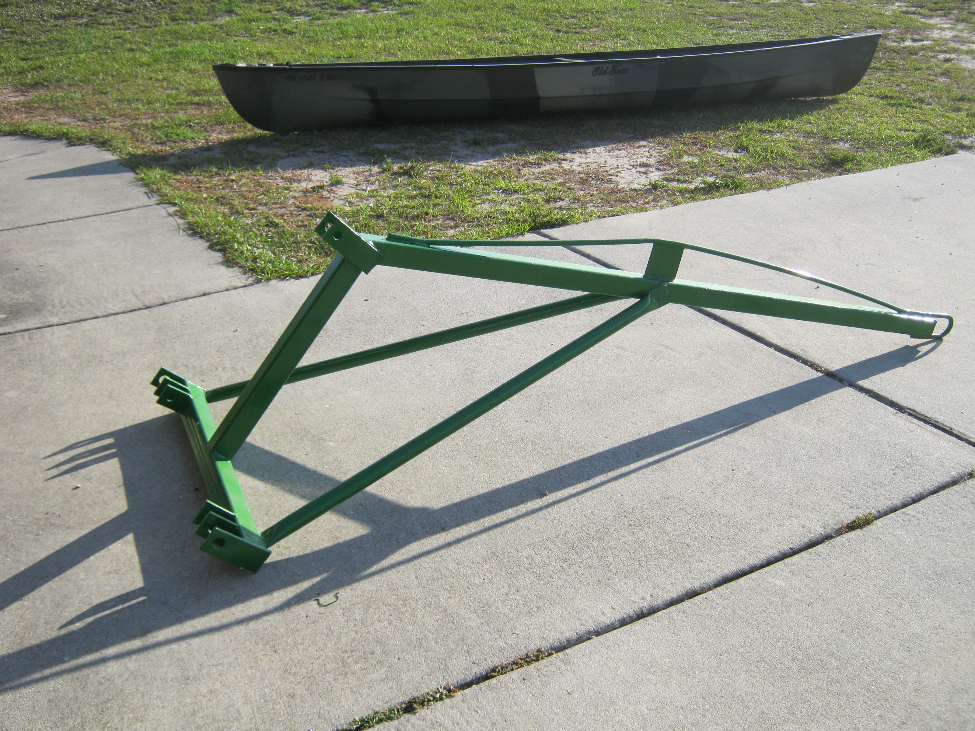

Here's some pic of my attempt
Forget a hand crank, I got a 12vdc 1 ton winch from HF.
Unloading shipping container
placing roof panels
moving 8x12 4000 gal tank
placing 25ft roof panels
David Sent from my iPad using TractorByNet
