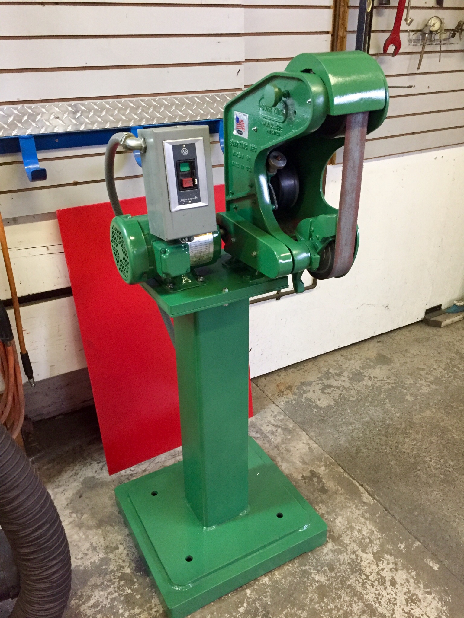

I found bought this used one off eBay (Burr King 482) for $500USD plus shipping. Needed a bit of work though.

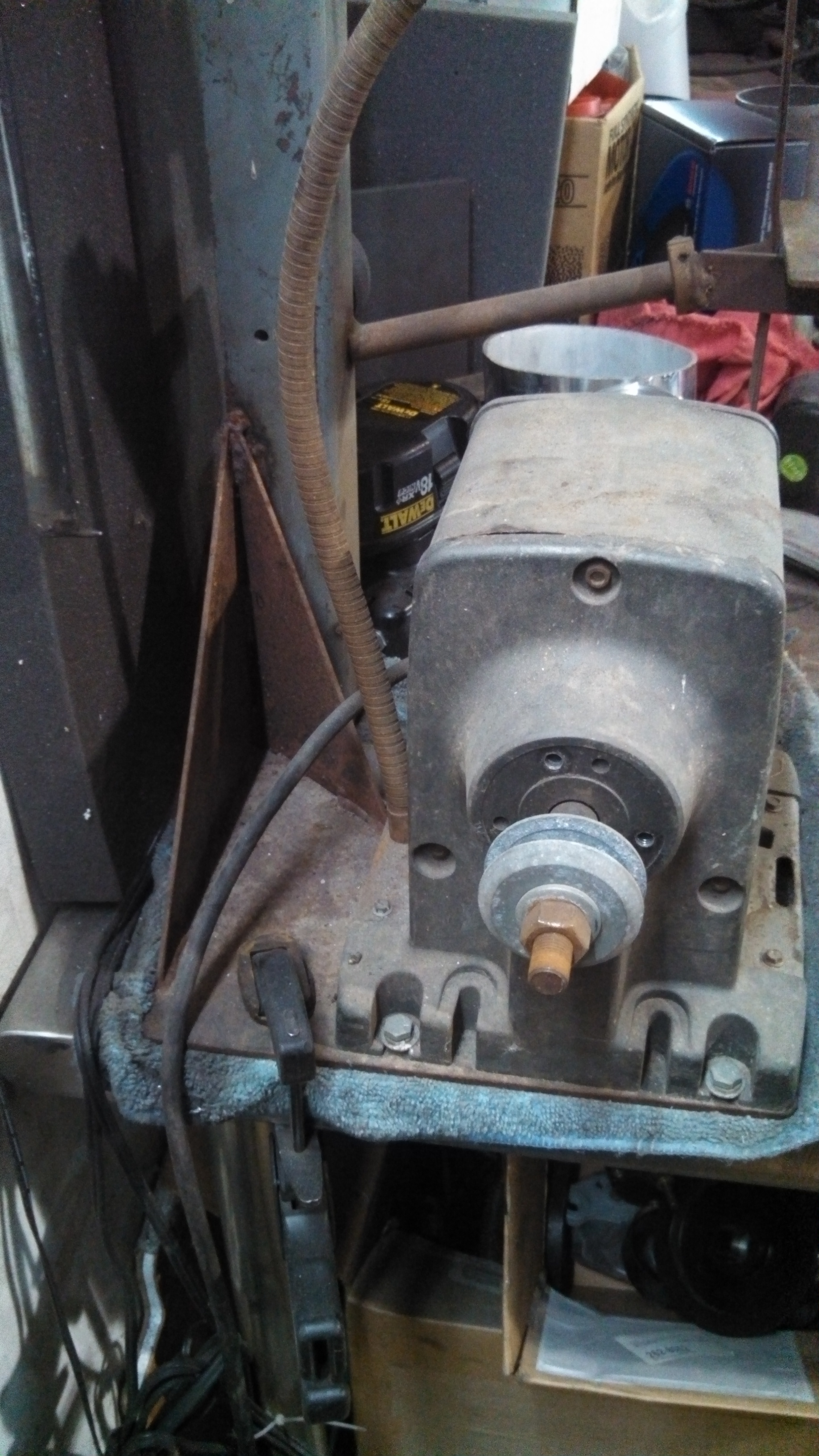

1x42 belt sander from an old clothes dryer for the motor, idler, a stand off a John Deere hay bailer and a roller skate wheel.
No need to get fancy if you just want something that works and don't care what it looks like.

Looks pretty nice to me. :)

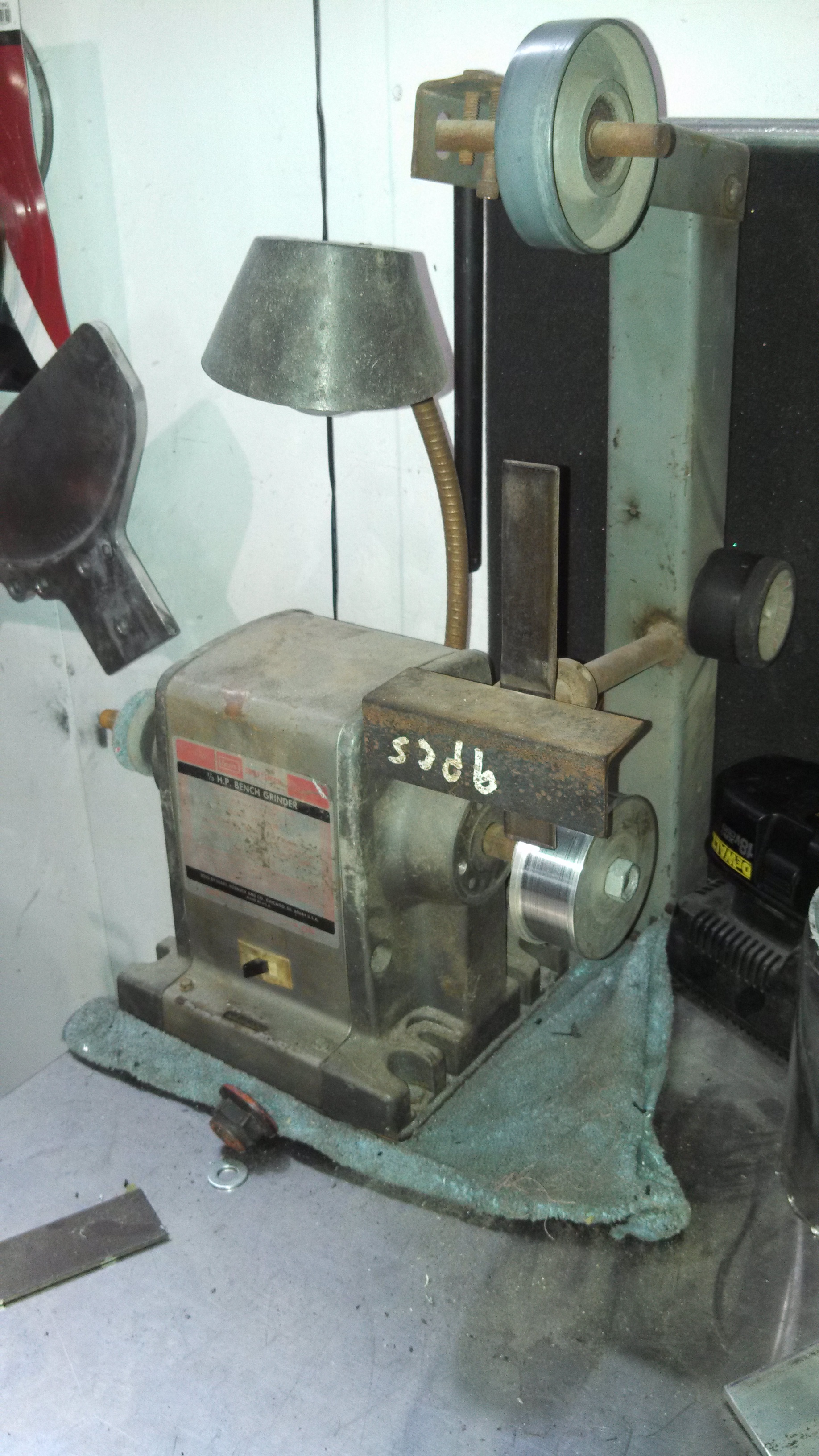

If you like the clothes dryer one, you might like this one too. I machined an aluminum wheel to take the place of a stone on a bench grinder, and added the rest of the sander to a plate the grinder bolts to. And recycled another roller skate wheel.
