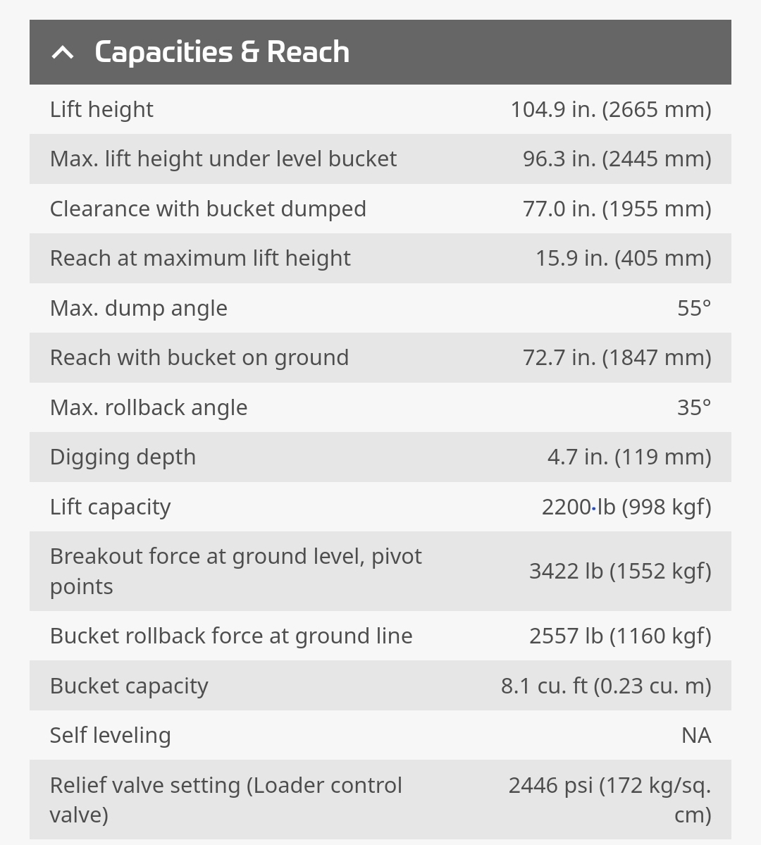

I don't look at other machines loader specs, but I certainly wouldn't be lifting 2-3k lbs with a 30hp tractor. My 40hp tractor lists the following specs:
Loader lift capacity at pins 1720 lbs (full height)
Loader lift capacity 500mm (20”) forward 1292 lbs (full height)
Loader lift capacity at pins 2202 lbs (1.5m height)
Loader lift capacity 500mm (20”) forward 1766 lbs (1.5m height)
The "at pin" specs are marketing numbers. I go by 500mm forward of the pins to 1.5m for mine. Even that number is unrealistic for daily use.

Exactly. To get near 3k lift capacity, you're going to be looking at 50 hp machines, not 30 hp machines. No matter what the brand.
Your post said CUT. A 50 HP machine is a CUT. That notwithstanding, here some quick ones that are lower HP and still lift over 2k.
Here's the data on a 2515.
And an LS MT3 35H

No, at the pins are looking at the loaders consistently. Otherwise you start comparing apples and oranges with random distances from the pins. It not as much about the number as it is about comparable data.
A loader that lifts 20% more at the pins than its competitor, will lift ~20% more equidistant from the pins. How much it can lift at different heights will change based on the arm geometry. That is why the best number for comparing relative lift ability is at the pins and to max height. (Better if you could get them to the same height, but luck with that.)
Kioti DK series has a 39 HP tractor with this loader...specs too big for image...link provided.
