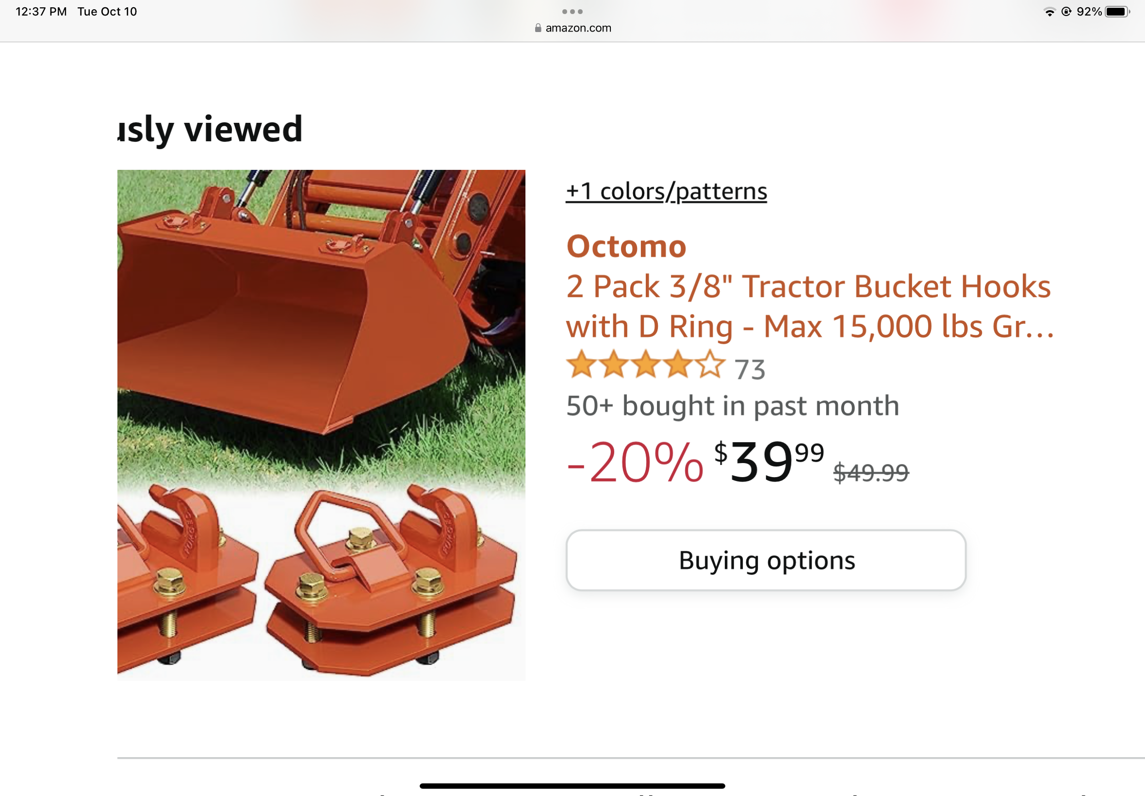

Has anyone bought and used this product from Amazon?
2 Pack 3/8" Tractor Bucket Hooks with D Ring - Max 15,000 lbs Grade 70 Forged Steel Bolt On Grab Hook for Tractor Bucket Accessories for Kubota, John Deere, Kiot, RV, UTV, Truck, Orange​
Brand: Octomo
4.2 4.2 out of 5 stars 73 ratings
50+ bought in past month
Prime Big Deal
-20% $39.99
Typical price: $49.99
/ Bucket Hooks with D-Rings #2
I'd want to take a look at how well they are made, but I do like the idea of using a 3/8" grade 70 grab hook plus having ample bolts with lock nuts, and a backing plate.
Not so sure what the function of the other piece "D-ring?" is - it looks questionable to me. Why make it pointed in the middle? But if used for no more than a low stress tie point for a rope to hold branches and light loads in the bucket it sure does beat the common practice of tying off to the cylinder end mount or such...

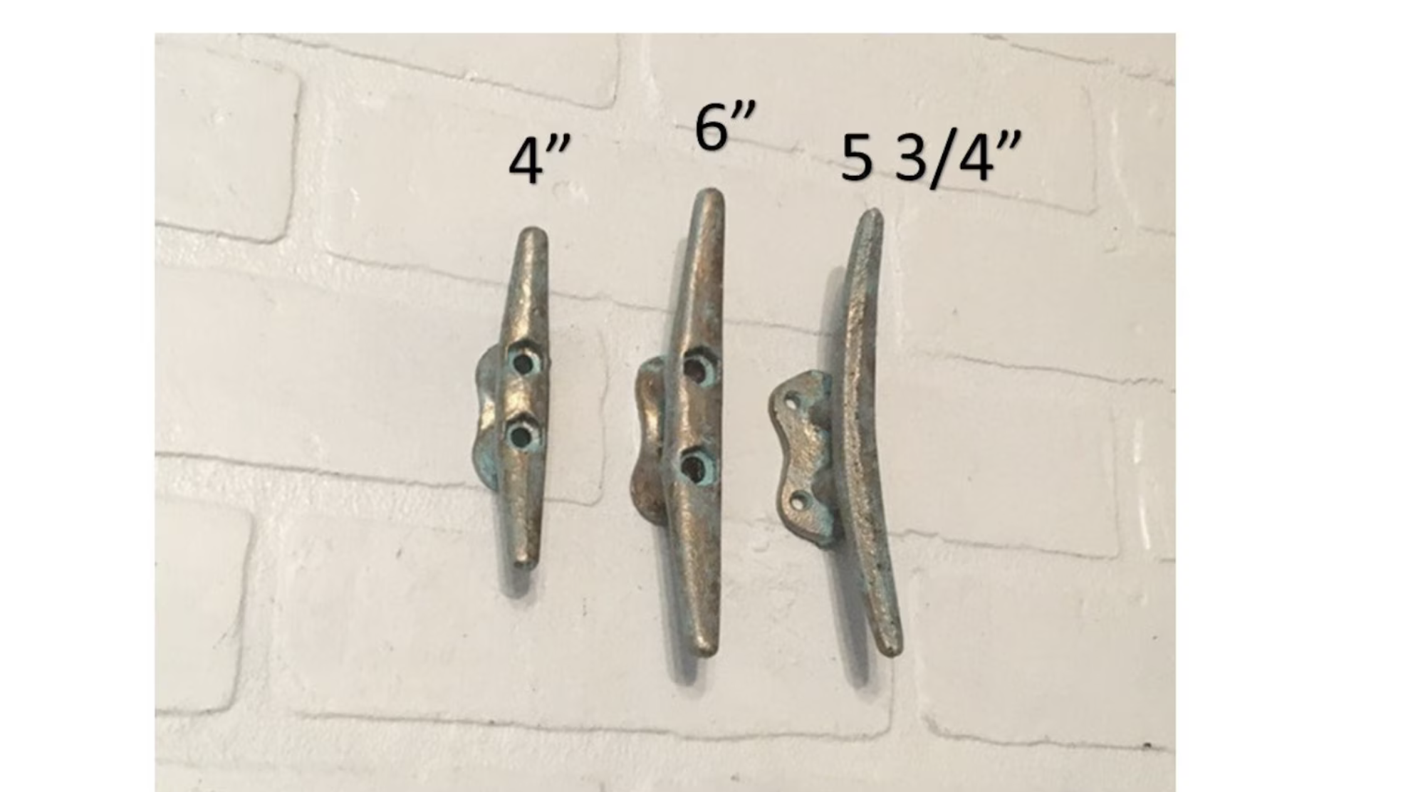

On my own tractor I admit I like to have dedicated places on each side of the bucket to hook a rope. Not to be used for pulling or much stress, but just for holding odd shaped things in the bucket... branches, oil barrels, things like that.
What I use for that is a metal sail boat cleat. Again, with a backing plate.
For that duty, I like the 4" and the 6" ones in this picture.
Which reminds me, there is someone - I forget who - on TBN who makes very nice bolt-on grab hooks for buckets. Apologies for not remembering... maybe someone knows.

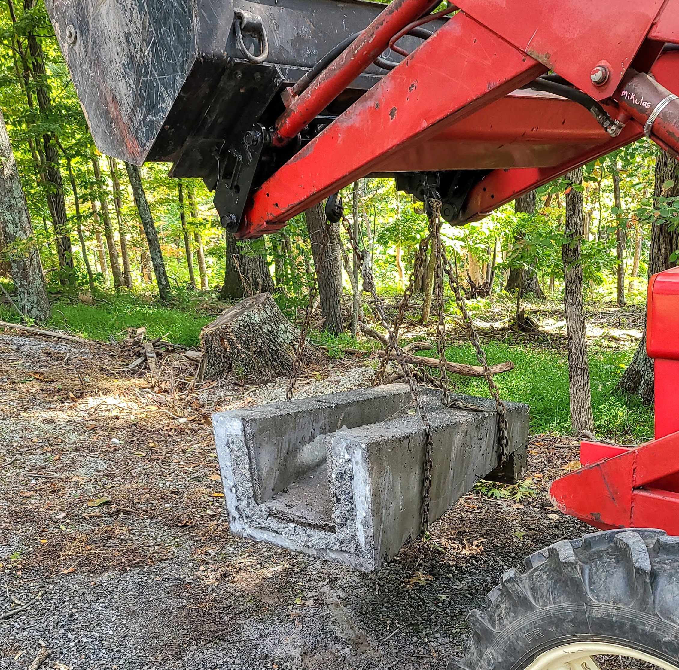

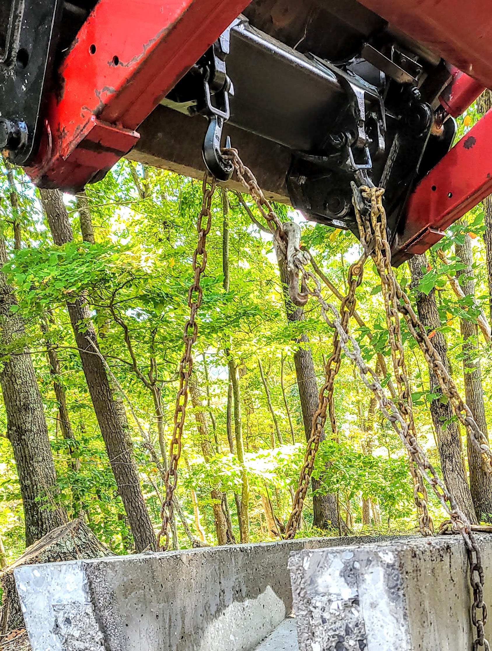

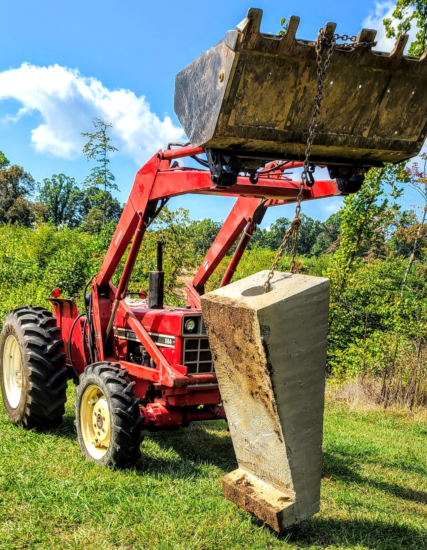

I always felt "D" rings, and hooks on top of the bucket were only for light loads,,
If you want to lift something heavy,, and have better control, hooks "BEHIND" the bucket are better.
I was getting ready to set this concrete headwall at the end of my culvert. It weighs about 2,000 pounds.
Hanging off the front of the bucket, the further out geometry of the lift made maneuvering the tractor difficult.
In close, with the hooks behind the bucket, worked better.
PLUS, if I choose, I can drop the bucket, and still lift.
With the bucket off, the lift capacity of the loader is greatly increased.
Thanks for your advice. That’s what I’m going to do!👍🏻☮️✌🏻
