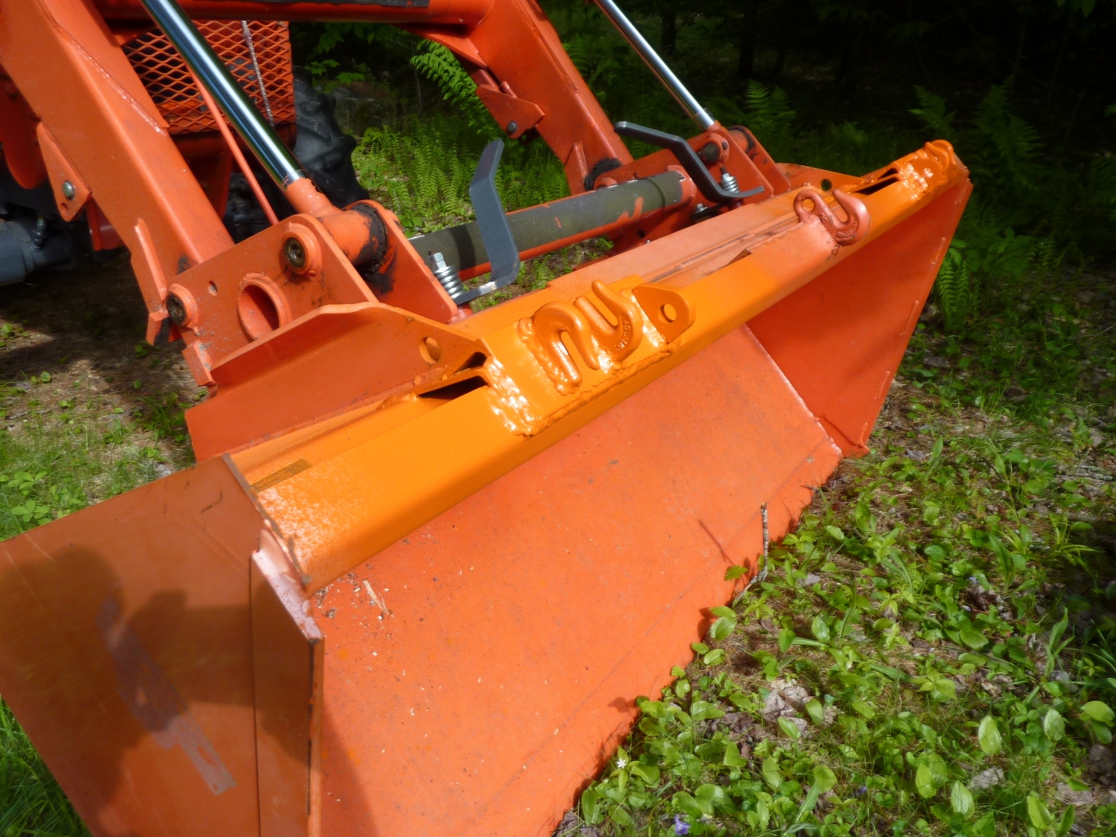

I don't have D-rings but a do have shackle lugs on my grapple and bucket which allows for many types of connections
   / Bucket Hooks with D-Rings #13

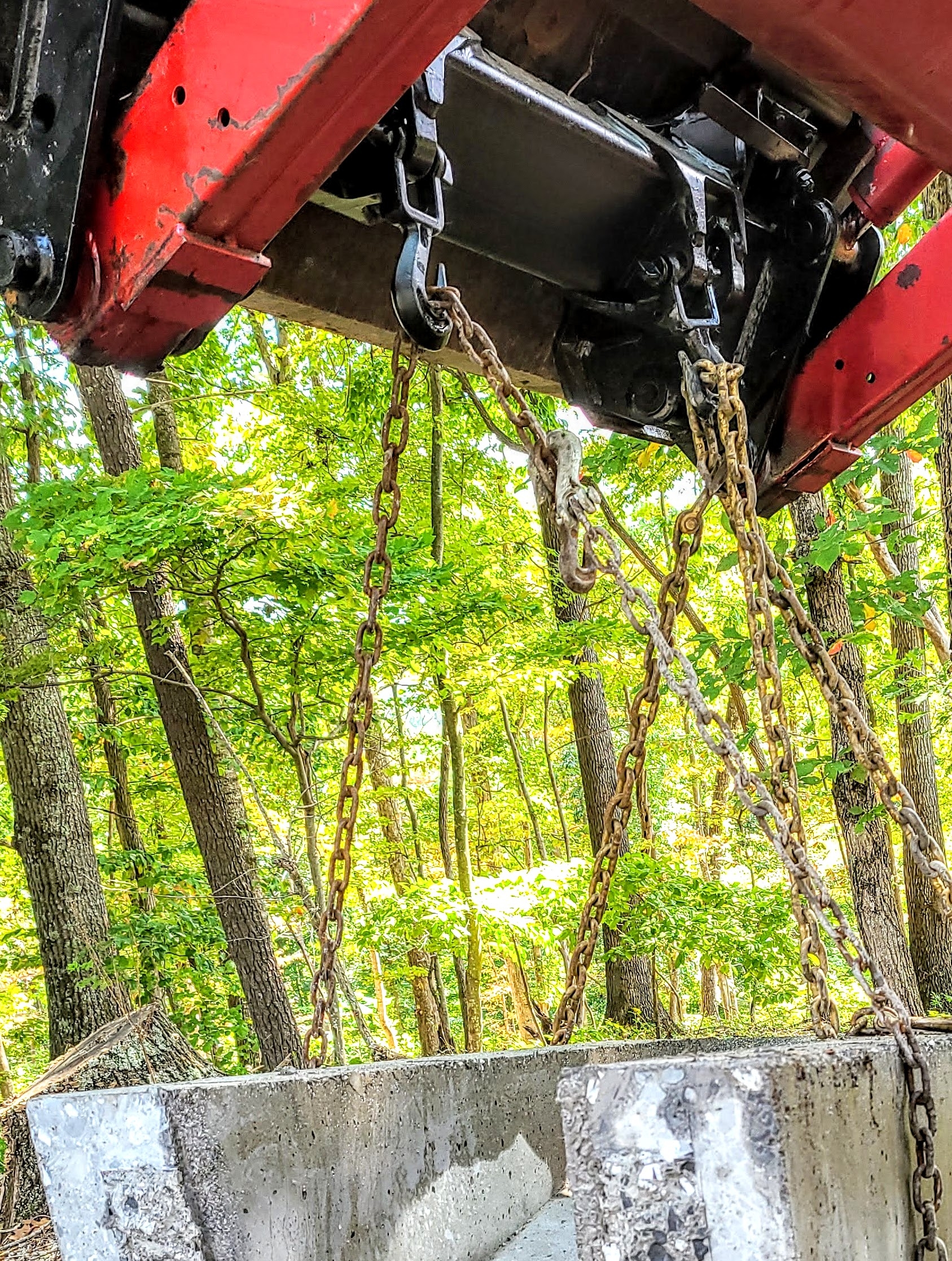

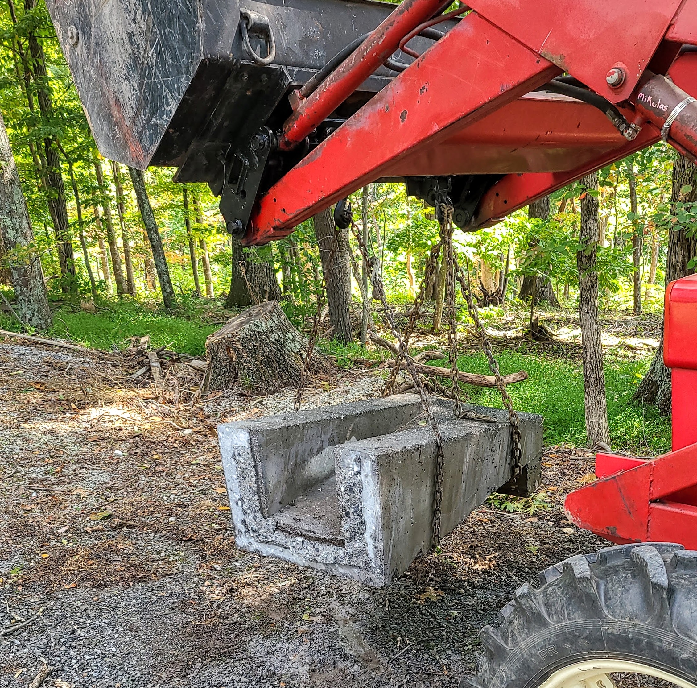

I always felt "D" rings, and hooks on top of the bucket were only for light loads,,
If you want to lift something heavy,, and have better control, hooks "BEHIND" the bucket are better.

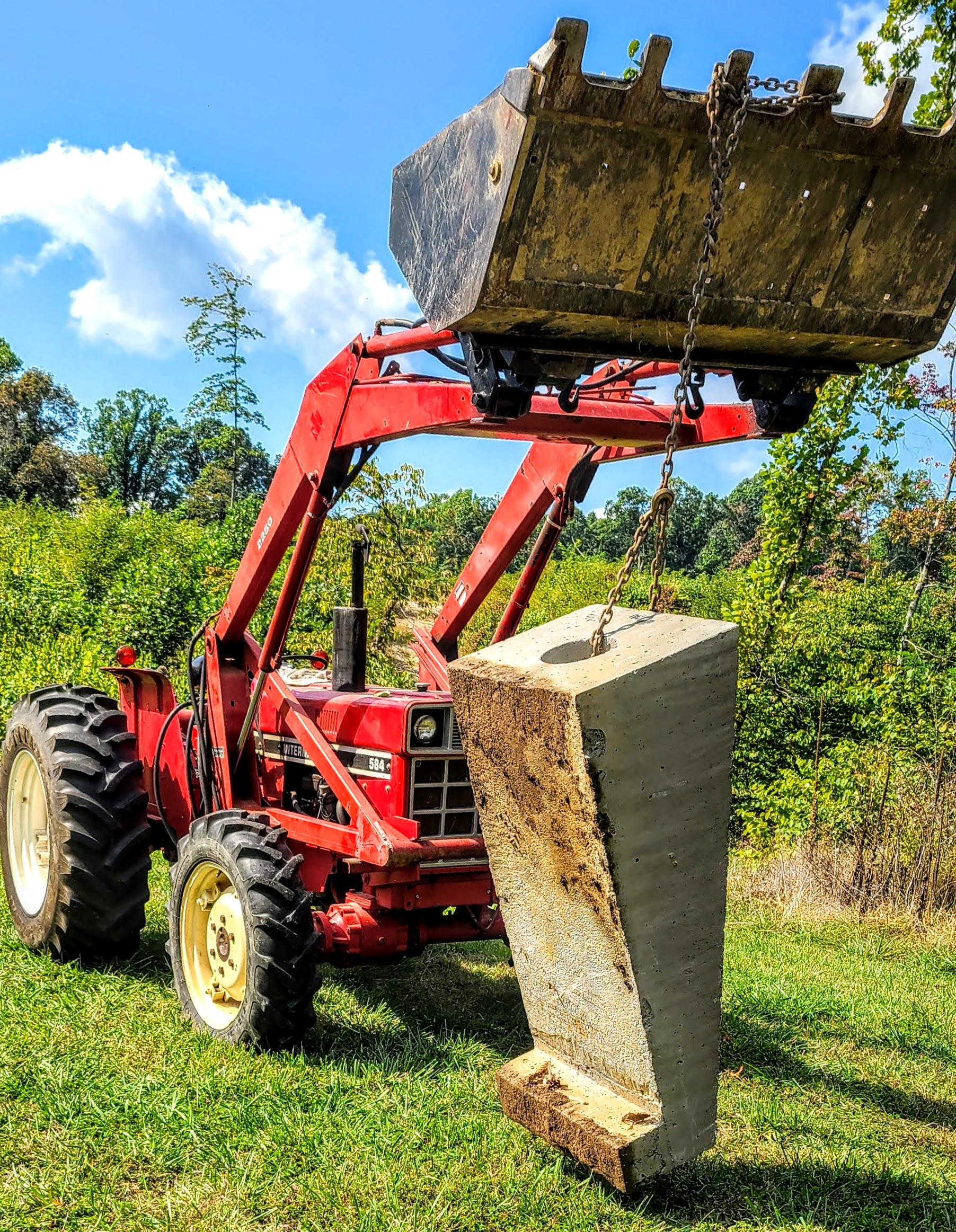

I was getting ready to set this concrete headwall at the end of my culvert. It weighs about 2,000 pounds.
Hanging off the front of the bucket, the further out geometry of the lift made maneuvering the tractor difficult.
In close, with the hooks behind the bucket, worked better.
PLUS, if I choose, I can drop the bucket, and still lift.
With the bucket off, the lift capacity of the loader is greatly increased.

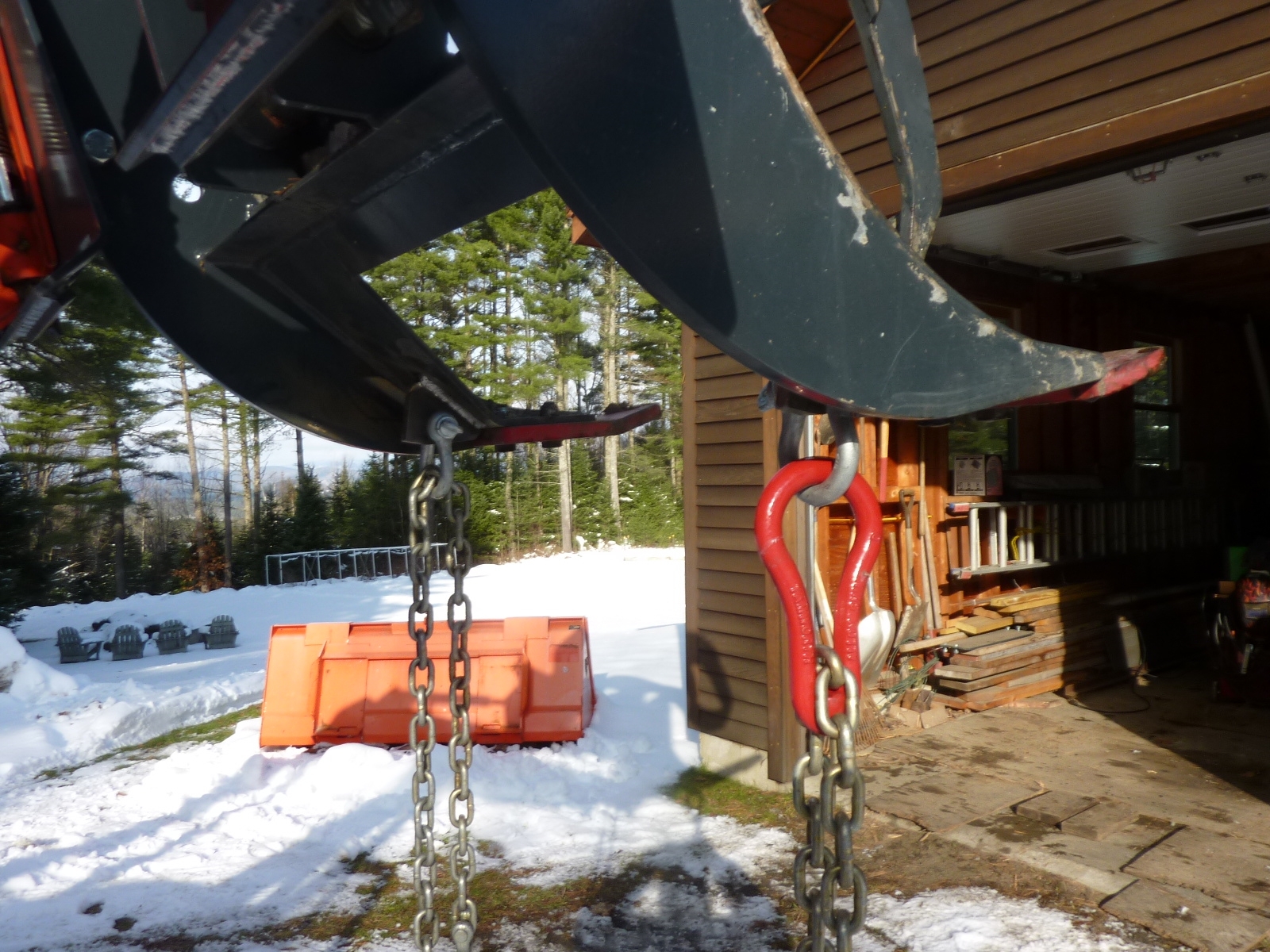

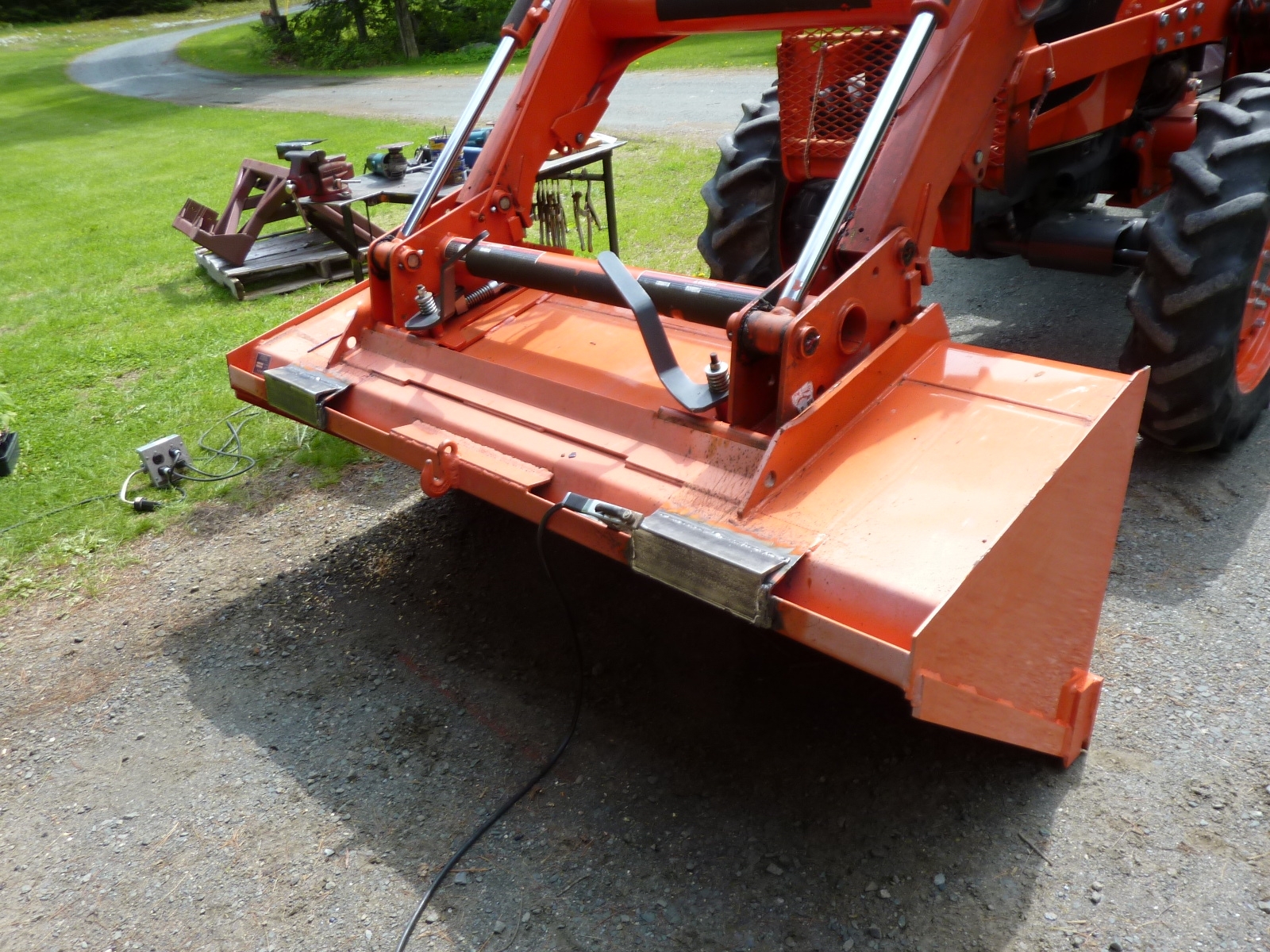

I got Ken's BOH with the shackles underneath, and they're the cat's meeeeooooow.
   / Bucket Hooks with D-Rings #16
Nice- that's a lot heavier duty with forged shackles.
Way back, and hopefully still, Bolt On Hooks published their significant mechanical testing for their designs. IIRC, they even tested the pull strength of their 2 bolt clamping arrangement on the bucket's sheet metal.
