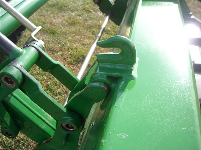

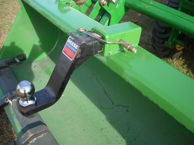

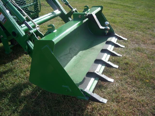

Coupla ideas on hooks. The hooks located at the bucket mounts are pretty well re-enforced....and I like the receiver to hook a chain to, or to move trailers. :thumbsup:
And.....yes, some folks have put slots into a piece of angle and bolted to the top of the bucket.....don't count on retiring any time soon. :laughing:
Lotsa threads on hooks....mine are gleaned from what I liked best.

/ Bucket Hook(s) Placement #5
OH....and my bucket has a full-length 1/4" plate running under the top lip to create a box...or "tube". This serves to re-enforce the receiver. Its hard to see from pics. (Noted so that one does not bend their bucket in the middle with the receiver shown.)

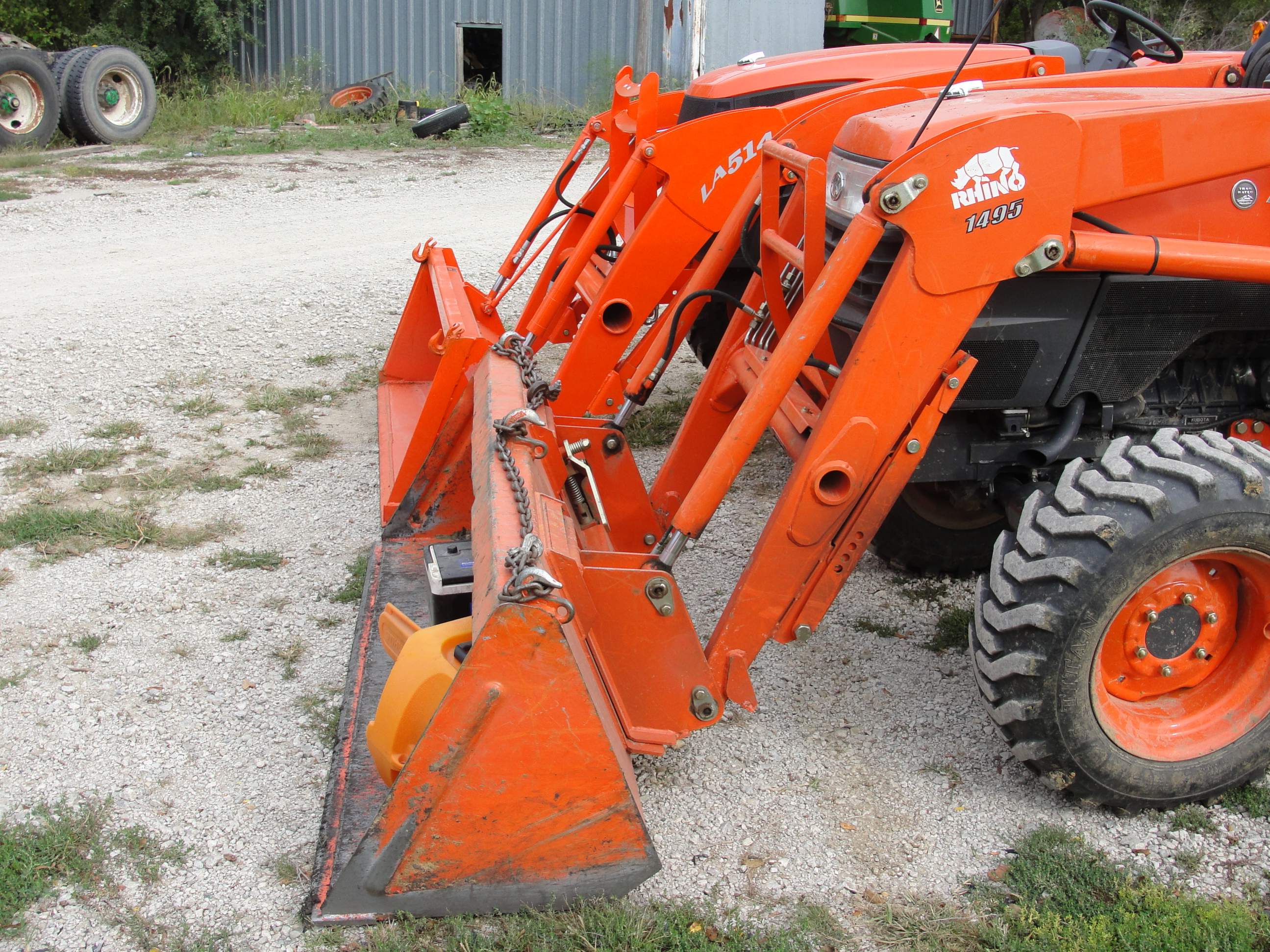

/ Bucket Hook(s) Placement #12
These threads are much more fun with pics..... But for some reason I don't have any pics of my hooks....
I have a Rhino loader which has a heavy C shaped beam across the top of the bucket. I welded a link hook at each end of the bucket on top with the open end of the hook rearward. I welded a slip hook in the center facing the same way. Sorry I couldn't give you a picture. I use all three of my hooks frequently.

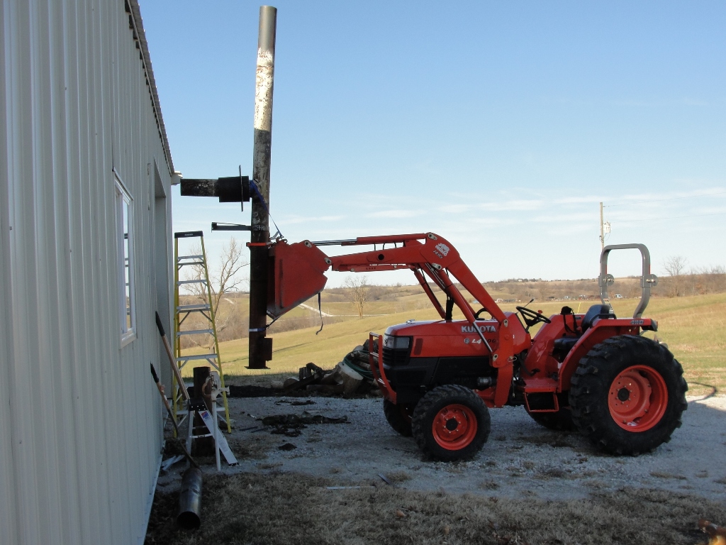

/ Bucket Hook(s) Placement #13
Hey, I found a picture showing my hooks and a couple that displays the variety of uses for such hooks!!! :laughing:
