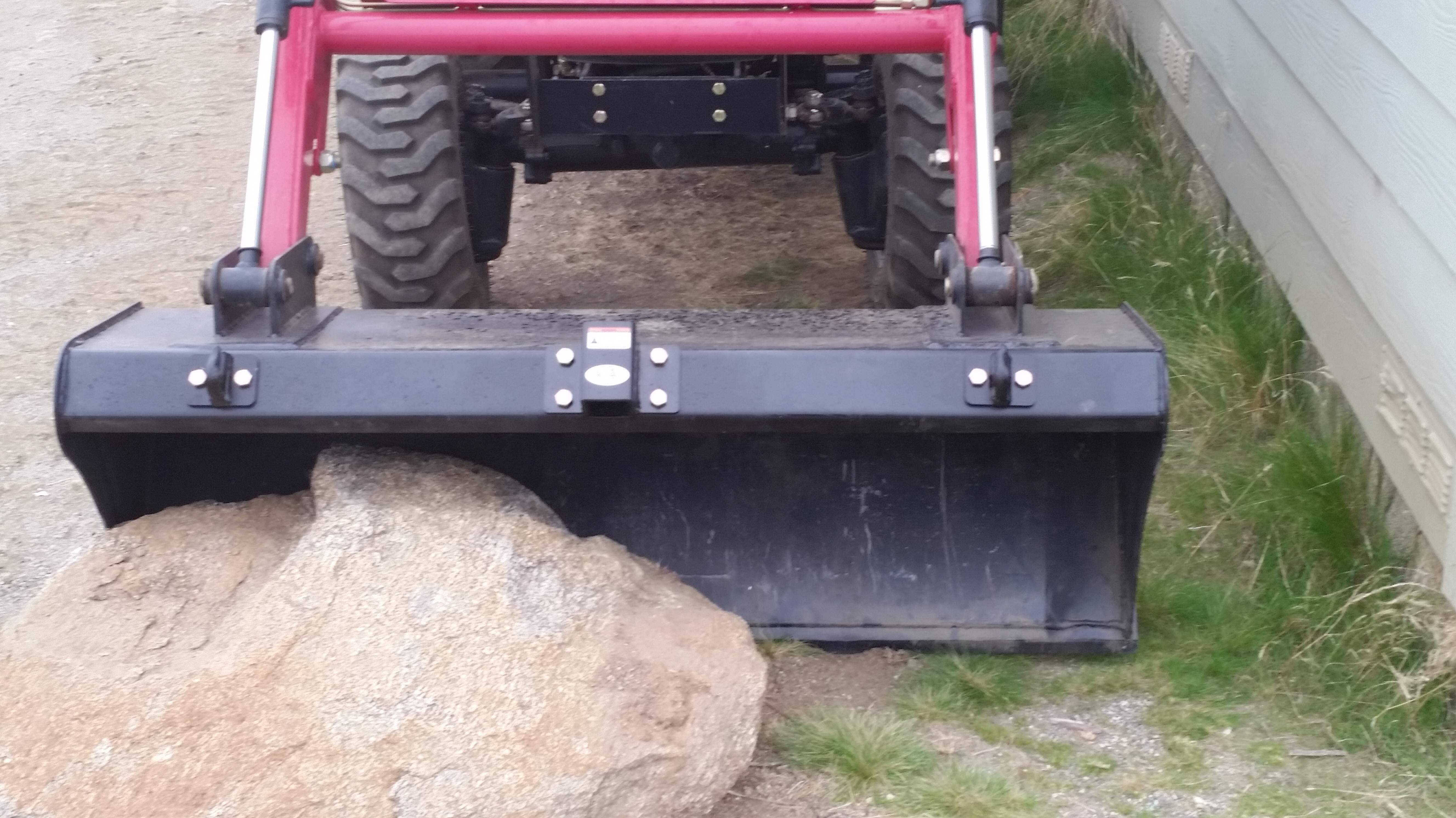

Thanks to this thread and the Weld-On Hooks Thread I have decided to use the double mounting
Setup from Kennyd's stuff. (see attached)
I think a 2x2 receiver hitch in the middle will round out any hook up I will come across.
On my existing tractor I am using two bolt-on shackle mounts on the top, these work well except with chain it can become a tangled mess really quick.
Chain Hooks will eliminate the mess and hook up will be quicker but I like the shackles for other things so the double setup will be the way to go.
View attachment 393474n

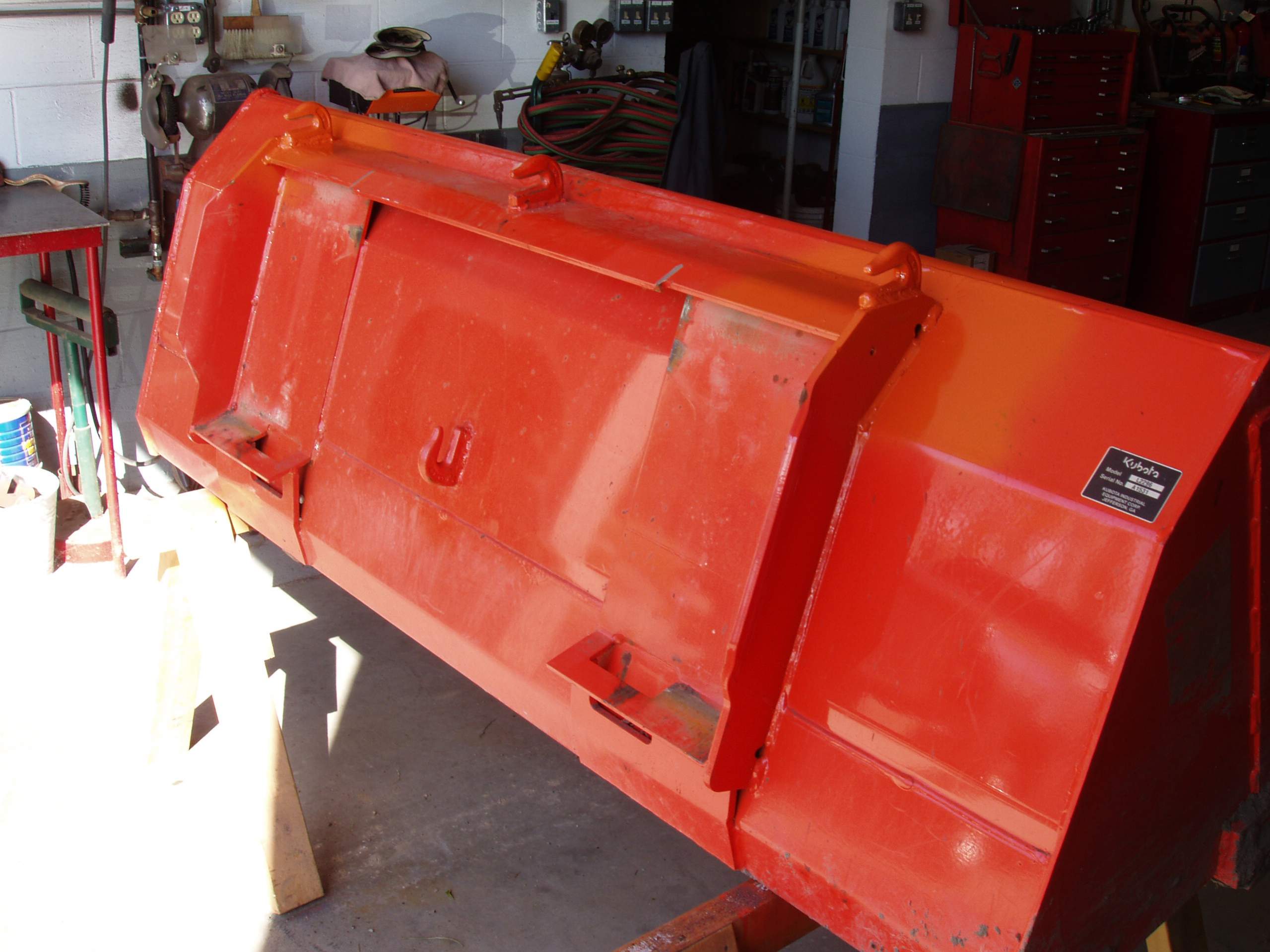

/ Bucket Hook Placement #26
Just another way that I did it. Three regular grab hooks ground down a bit on the back side to make a smoother fit. I had this similar set up on all my older tractors. Three is the number you want. If you are gonna tear these up than you aren't working smart

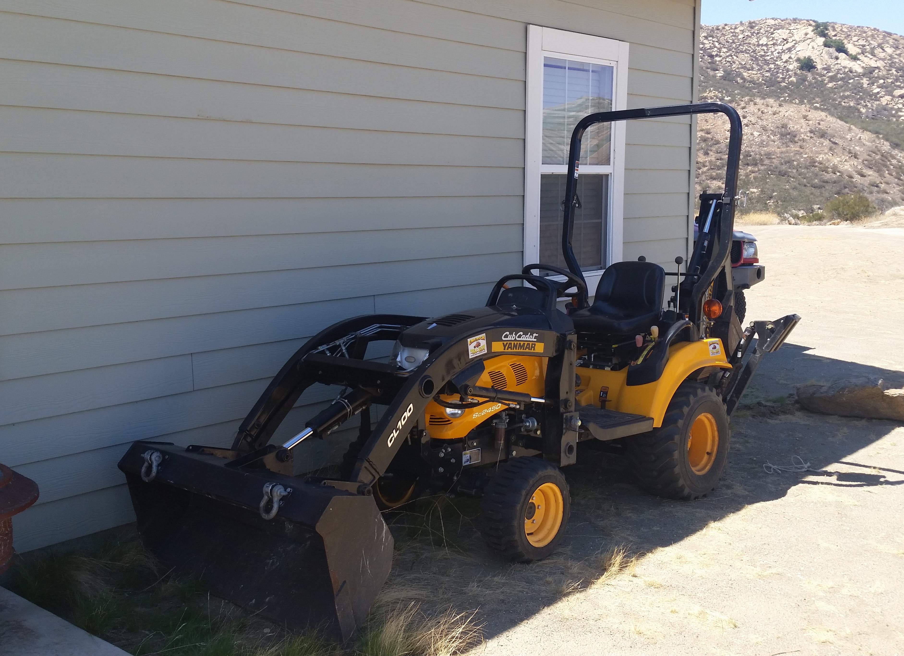

/ Bucket Hook Placement #27
I mounted the "Bolt-On Hooks" Hooks over the weekend, one at each pivot point on the FEL.
Also added in the "Bolt-On Hooks" 2x2Receiver, centered on the FEL.

/ Bucket Hook Placement #28
I like the receiver idea, I just wouldn't trust the "bolt on" idea, wouldn't trust the bolts,
especially only two on the hooks.
I would feel more comfortable with them welded.
/ Bucket Hook Placement #29
Shear strength of Grade 8 3/8" bolts is 9,939.6# each (per: https://nucor-fastener.com/Files/PDFs/TechDataSheets/TDS_013_Shear_Strength.pdf). Thats almost 20,000# for 2 bolts.
If they are 1/2" bolts like Ken sells with his kits, they have a shear strength of 17,670.6# each (or ~35,000# for two).

Have you seen any of the videos on my website? Or are you just making a blanket statement condemning my product with no evidence?
Under extreme conditions, a weld can fail also.

My only concern is the strength of the FEL Bucket in the middle where the "2x2 Bolt-On Hitch" is mounted but for what I will be using it for it will be more than strong enough.
Aaron Z
First off the mounting plate is thick enough to weld on if you so chose to, welded it would add to the overall strength of the bucket.
Second, I do not need more strength than the Bolt-On Hooks will supply.
Third, I recently moved to SoCal and all my tools are still in storage, at least until the new shop is in so mounting was a concern and the "Bolt-On Hooks" fit the bill perfectly.
So for me... Bolt-On Hooks were convenient, are strong enough for anything I need to do and very cost effective, so this is a no-brainer... BUY Bolt-On Hooks !
